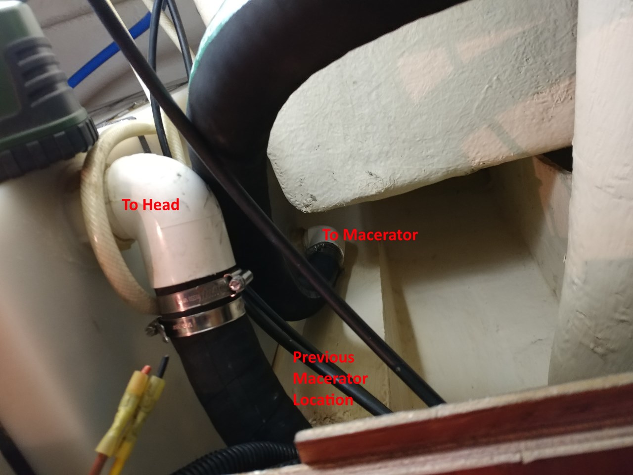

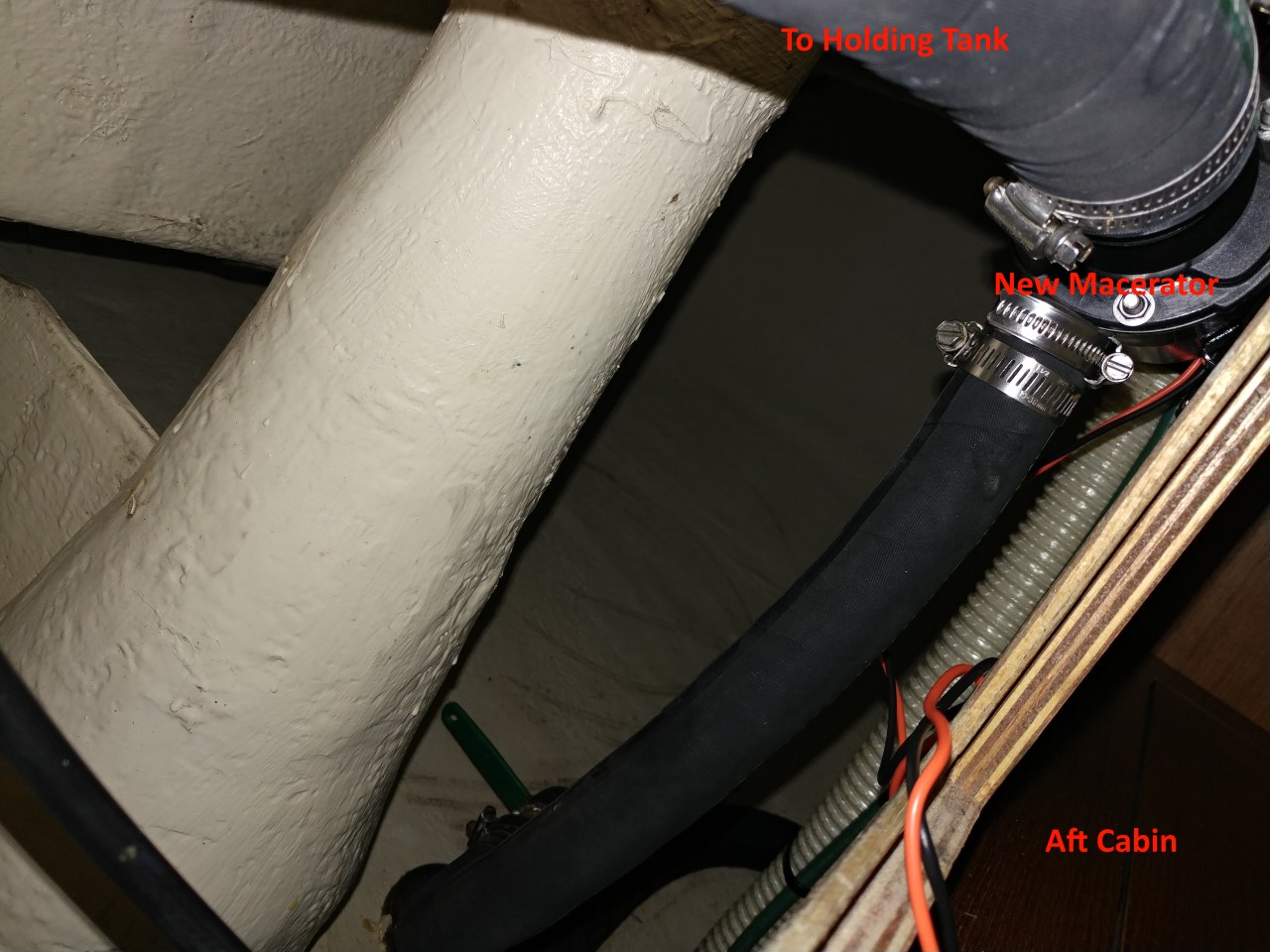

Hunter 356 SF Bay / Delta
We recently acquired a 356 that had a bad odor. It was obvious that the original Jabsco macerator had been leaking for a long time as there was a stream of black water from the pump to the bilge.
Not sure if the 38 is similar, but on the 356/36, the macerator is level with the bottom of the holding tank, so the "stew" sits in the pump 24/7. I'm sure this leads to a much short life of the pump. When we replaced, I relocated it to the aft side of the rear bulkhead.

...the macerator is level with the bottom of the holding tank, so the "stew" sits in the pump 24/7. I'm sure this leads to a much short life of the pump. When we replaced, I relocated it to the aft side of the rear bulkhead.
