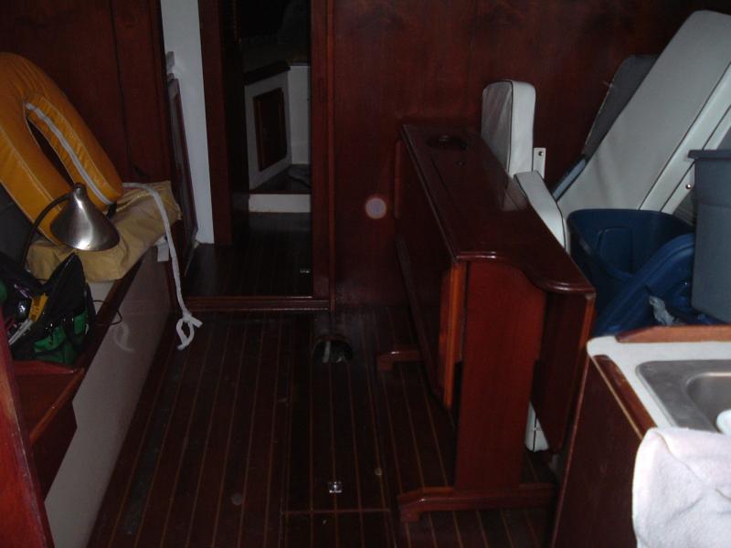

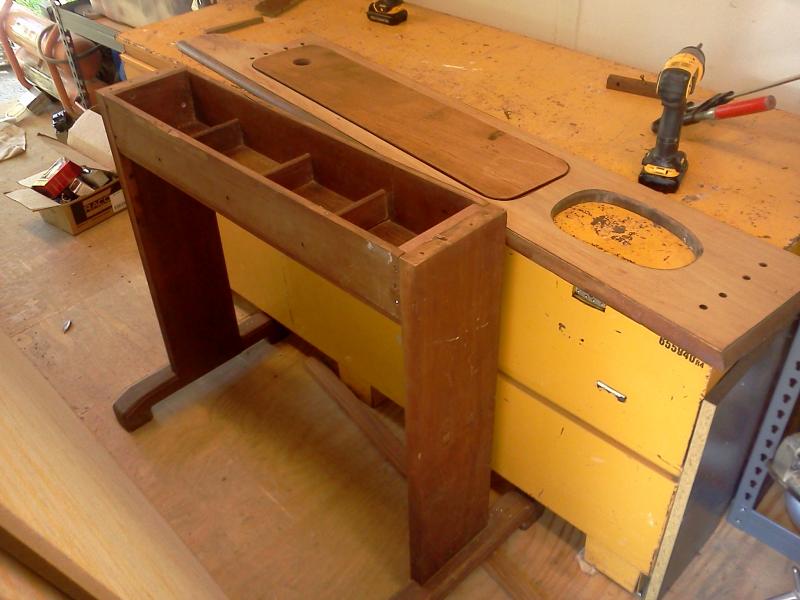

I am modifying the main cabin table so it can be removable. After working on the boat for 2 years and not having it in the cabin, I took it in the other day and found out it is big and bulky. I have decided to make it removable so I have modified the base so both legs are on the same side and moved the leaves hinges. I have cut the mast hole in half so I can install the table after the mast is in. I have made two cleats that surface mount and connect the two halves back together. There is no weight on that part of the table anymore so it should do O.K. and will help steady the table longitudinally.
My main problem is finding a way to attach the legs to the sole without leaving a raggedy screw hole on the sole. I have looked high and low for some sort of insert that would look good on the sole with the table removed. To date, all that I came up with was to drill a hole on the sole and epoxy in a stainless T nut from under the sole. I assume that I can access the holes from the bilge.
