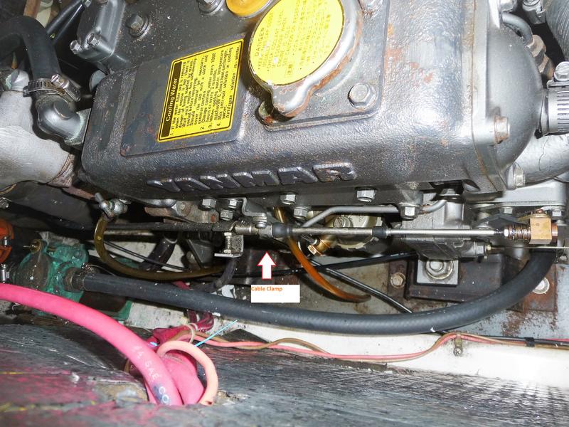

Throttle Cable Clamp
Jon, attached is a picture of the cable clamp. You may be able to get a little more travel by loosening and pulling back slightly to set how it pulls for more RPM. just make sure that when the lever on the pedestal is fully aft, the speed control lever still touches the idle speed stop.
