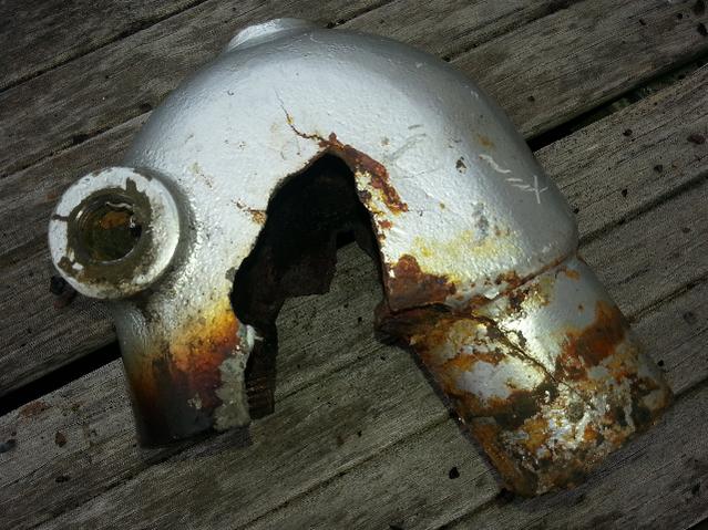

Can someone suggest a source for a mixing elbow?
This might be a better option for you
ttp://www.ebay.com/itm/Yanmar-Stainless-Steel-Exhaust-Mixing-Elbow-GM-Diesel-Models-128370-13600-/331543261042?hash=item4d3184af72&vxp=mtr
