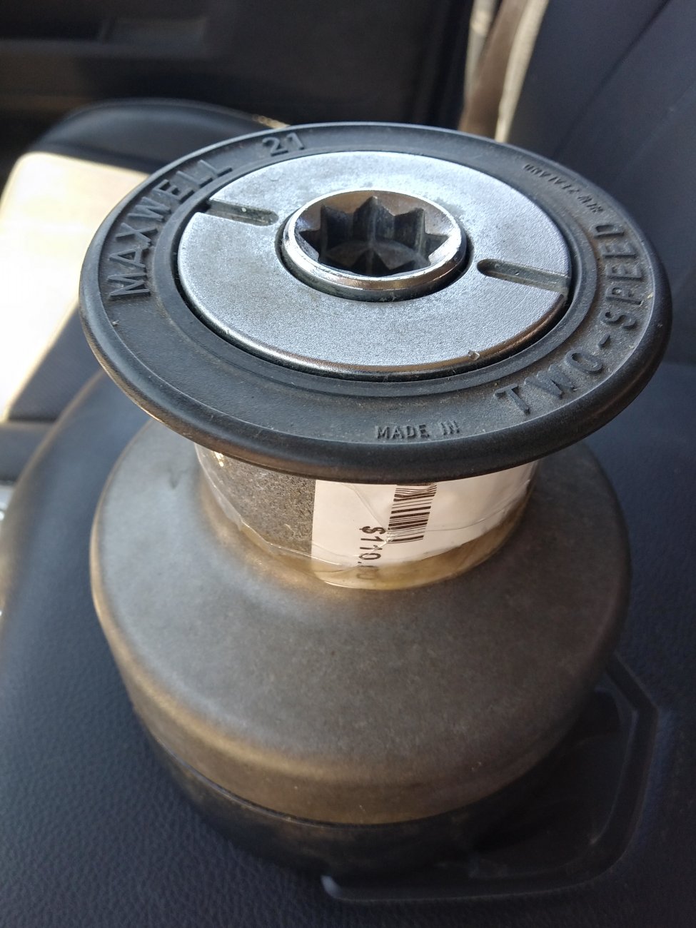

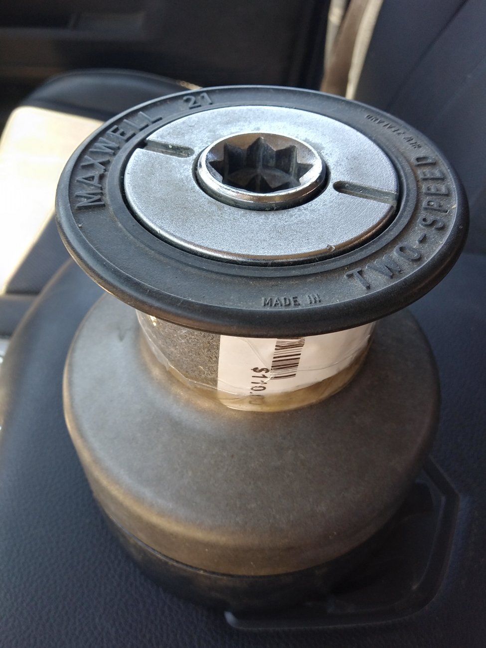

Warren, thanks for the info and the great video. The only reason I am replacing this winch is because the top cap, part #D427 popped off due to an override. It was lost and although the winch still operates fine, it's missing the cap and I can't find a replacement. I was hoping there was someone out there that replaced their winch and saved the old. Please let me know of anyone you may be aware of that has or is thinking of replacing theirs, I would love to talk to them.

Thank you JMCE1587. I appreciate you sending this link, it is exactly what I was hoping to find on this forum.
With this pdf and the info sent earlier by Warren Milberg I was able to identify the OEM winch as the Maxwell 17A.
I paid a visit to the Blue Pelican in Alameda and was shocked and amazed to find a Maxwell 21 sitting on the shelf. This is the 2 speed version of my 17A winch. I bought it for $100 installed it and I'm very happy with being able to keep it original plus keep from modifying either the winch or cabin top to make anything else fit. Thank you again, I dearly appreciate your help.
