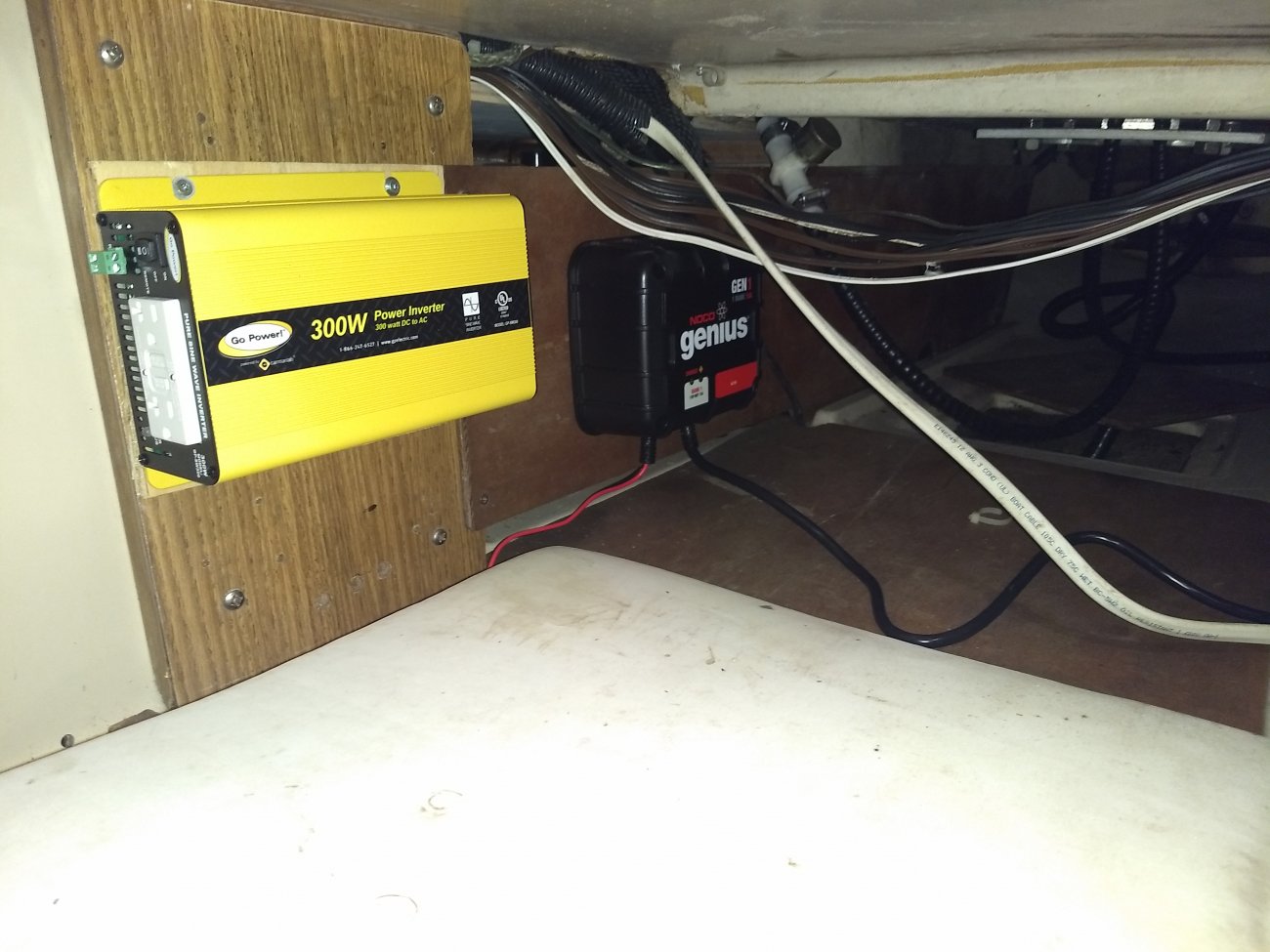

I just mounted a Go Power GPSW-300 inverter, but have no clue where the chassis ground wire is supposed to go?? The instructions from Go Power clearly indicate that I need to use 8 AWG wire, but don't specify what to connect this to.
Many posts in the forum say to ground an inverter to the engine block, but I'm under the assumption they are referring to a larger inboard motor, and not a tiny outboard like I have.

So, I think I answered my own question after some more extensive online research. One of the preferred methods for grounding both DC and AC is with a dedicated ground plate. However, this approach is expensive, and currently beyond my skill level. I think I'll just leave the inverter ungrounded for the time-being.

Ryan, I happen to have the instruction manual here. My reading of the instructions is if the AC out put of the inverter is not connected to another panel, such as the AC panel in the boat, then it is not necessary to ground the chassis. However, if it is connected to an AC panel there are some issues to address because of the multiple grounding sources.
On a boat without a vessel ground the inverter chassis ground would go to battery negative. Make 100% sure that your inverter is fused within 7" of the house banks + terminal too.

I plan to fuse the inverter within 7" of the battery bank with a Safety Fuse Block and Heat Shrink Ring Terminals. Thanks for the reminder on that one.
