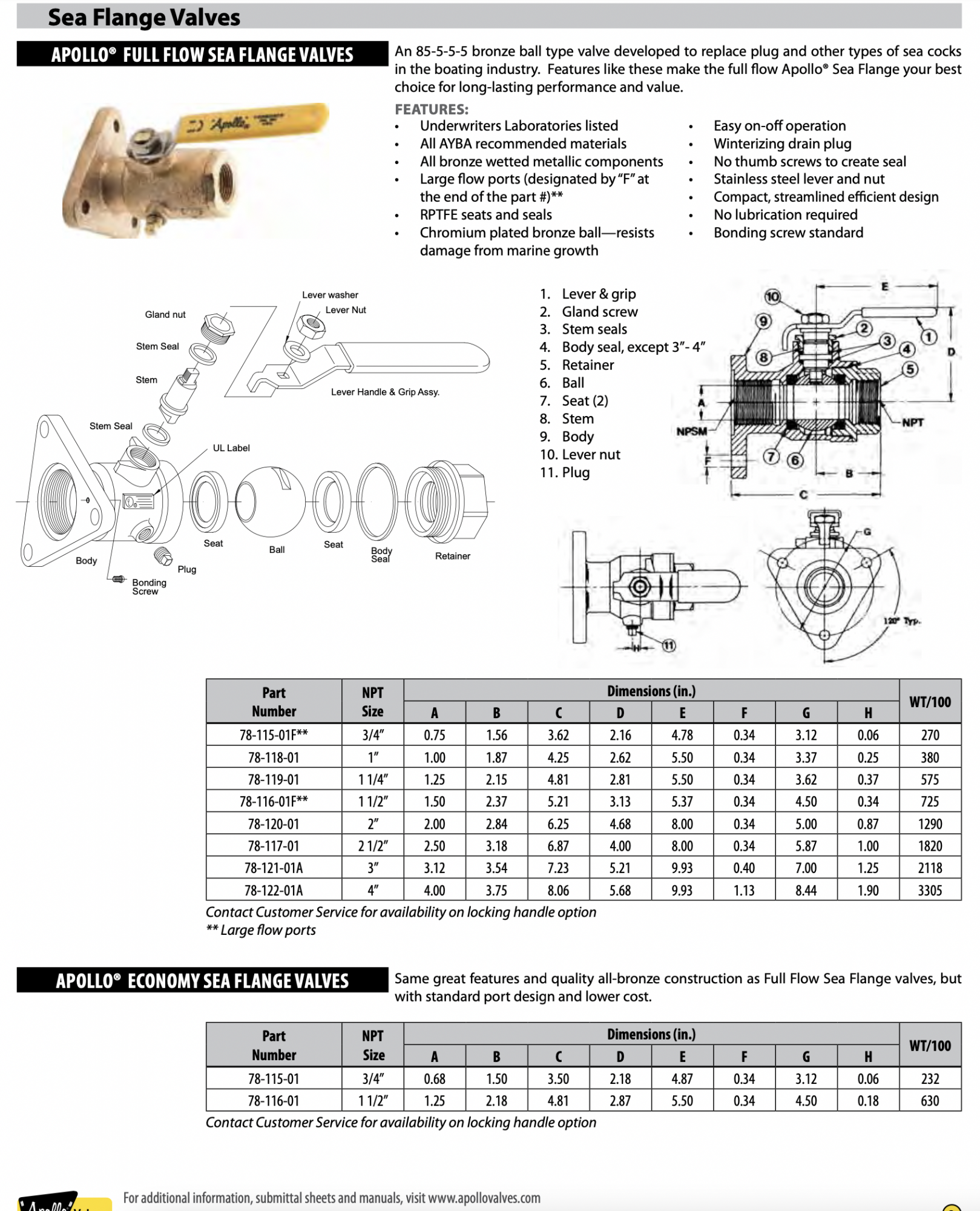

Just check that the valve is bronze and has no brass. I am not sure but I think some Apollo valves intended for household use may have brass. You need to check.

No brass in the Apollo marine Bronze valves.

The ball in the Groco valve is chrome plated brass. So it appears that at a lower price the Apollo is superior, at least in this aspect.

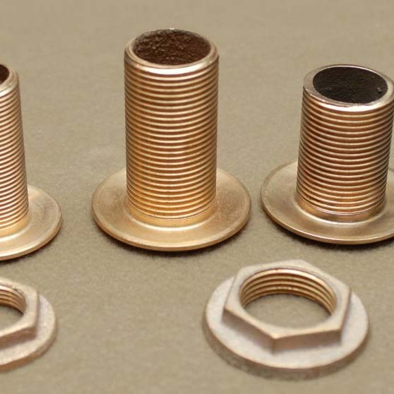

Velero, please make sure you understand the possible thread mismatch between thru-hulls and the screw on valves, no matter which brand you go with. MaineSail has several excellent articles on his website about this.
Many Hunters, including mine, came with mismatched threads from the factory.
