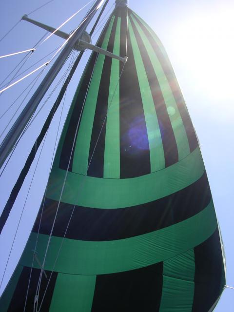

The picture is the spinaker we added this year, it worked great.
