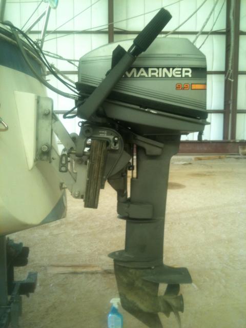

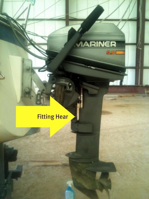

I am reffering to the zerk fitting. The one I hook a grease gun to. Sorry I'm just learning.
Like this:

Ok, now I'm confused.....where exactly on the motor is this zerks fitting? Most lower units are serviced via a fill and grain plug.
10,219
Good that you clarified, Alex! Anything with a Zerk fitting should be greased with A good marine grease, trailer wheel bearing grease is probably OK a good lithium base would be mighty fine.. The lower unit, the gear housing at the propeller, is the part that uses the 90 marine gear oil stuff.. sorry for the confusion..

Ah yes, a picture is worth a thousands words sometimes. Since that part isn't what's normally referred to as the "lower unit", please disregard my first post, grab a grease gun (I use lithium but use whatever than manual says) and have at it.

Just for your future reference, John, your lower unit is the bottom part of the motor drive shaft housing (vertical), from around the cavitation plates (the horizontal flat bits just above the propeller) down to the bottom. If you look at your motor, there's likely a few bolts holding that bottom part on to the drive shaft housing. That whole bottom piece can be taken off if it needs servicing. That's your lower unit.

there's usually three Zerk fittings on the "leg" of an outboard: One at the tilt-up pivot, and two at the upper and lower turning pivots. Grease them until some shows at the joint then wipe up any excess.
Mercury's "Quicksilver" line of greases are very good. Not a bad idea to have a tube of each of their marine greases on board.
