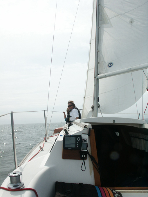

The 76csx is what I use for a drift alarm. Even my old model 48 has one. I use a Garmin 160 Blue fish finder that I had on another boat as my sounder. I hooked it to a brass through hull so I have water temp and Knot meter. Here is an old picture with the old Model 48
