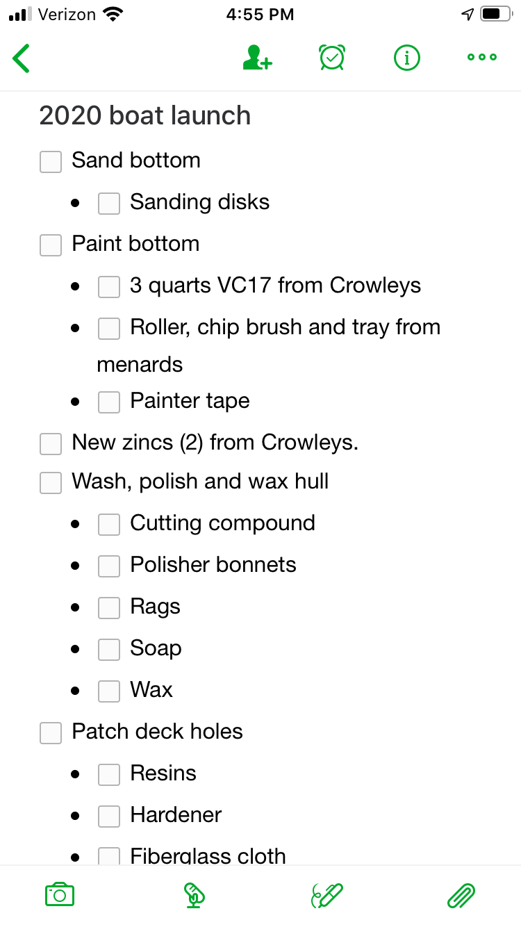

My spring work list includes:
- remove winter cover
- sand down the old VC17 on the hull before applying a fresh coat
- wash and polish the topsides before applying some wax
- replace 2 zincs (magnesium) on the prop shaft
- remove the midship cleats and repair fiberglass under them. They were added by a PO and when I tried to counter- sink the fiberglass before rebedding them with butyl tape, I punched right through the fiberglass skin.
- remove bikini track and fill screw holes.
Marina opens April 1, and I am usually the first sailboat in. Some salmon fishermen beat me, but they get paid to be out in the nasty weather ;-)

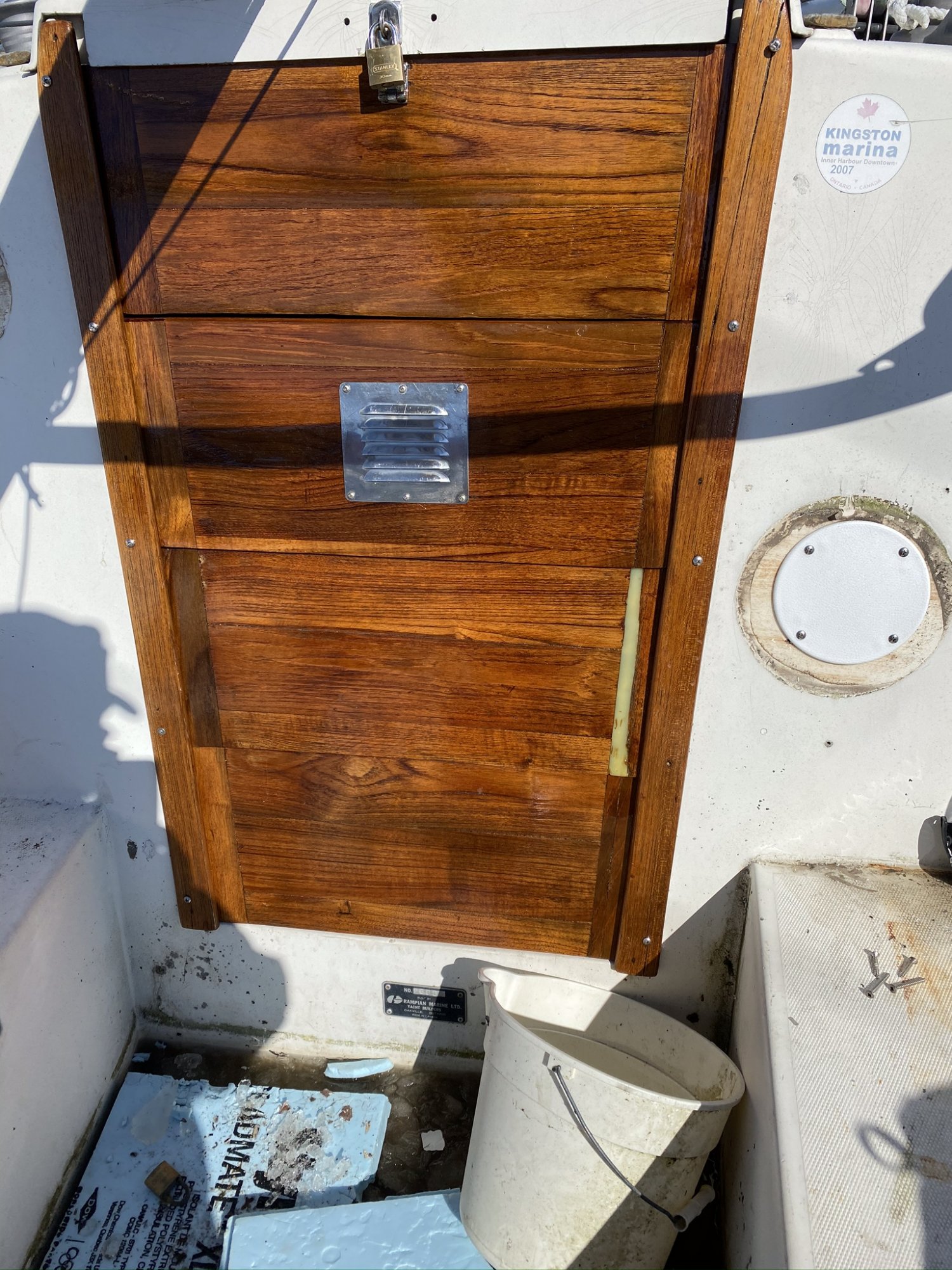

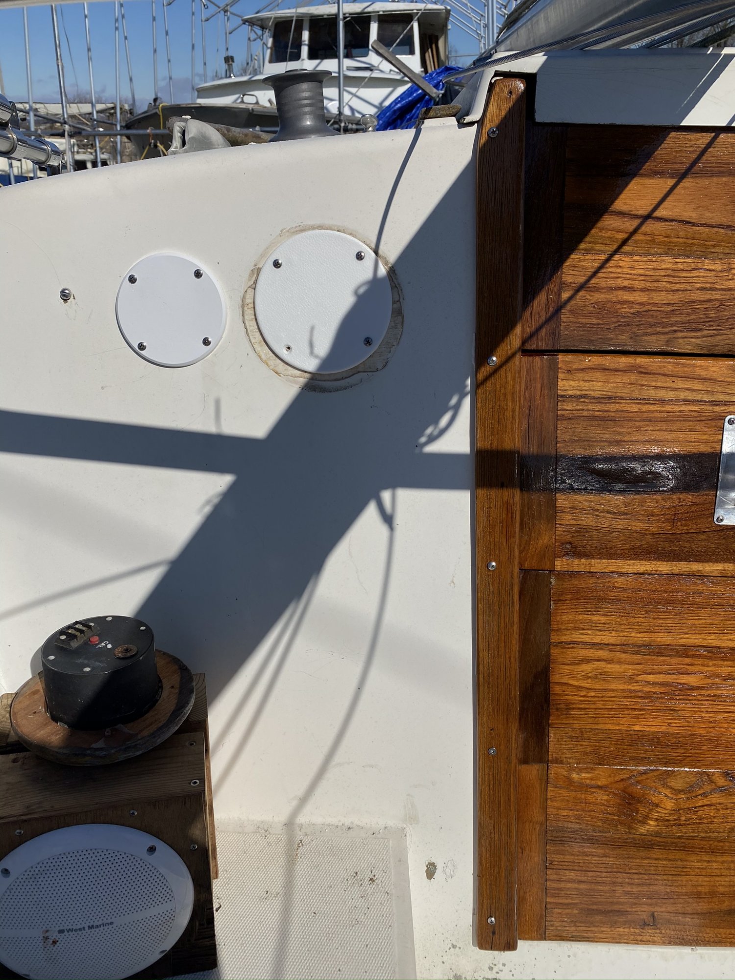

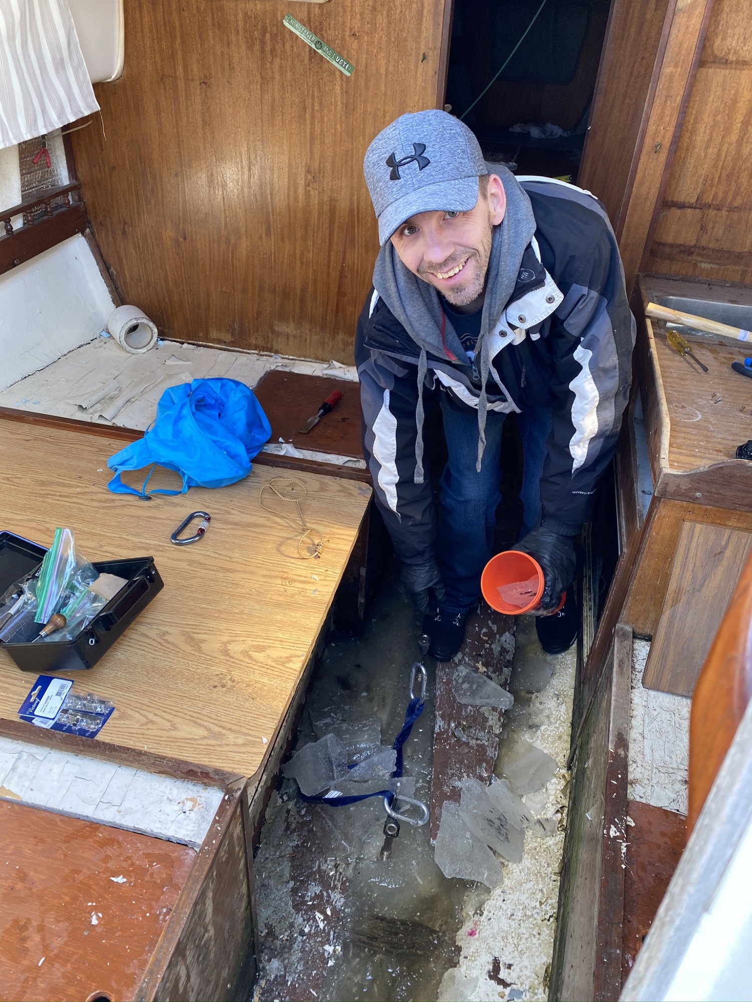

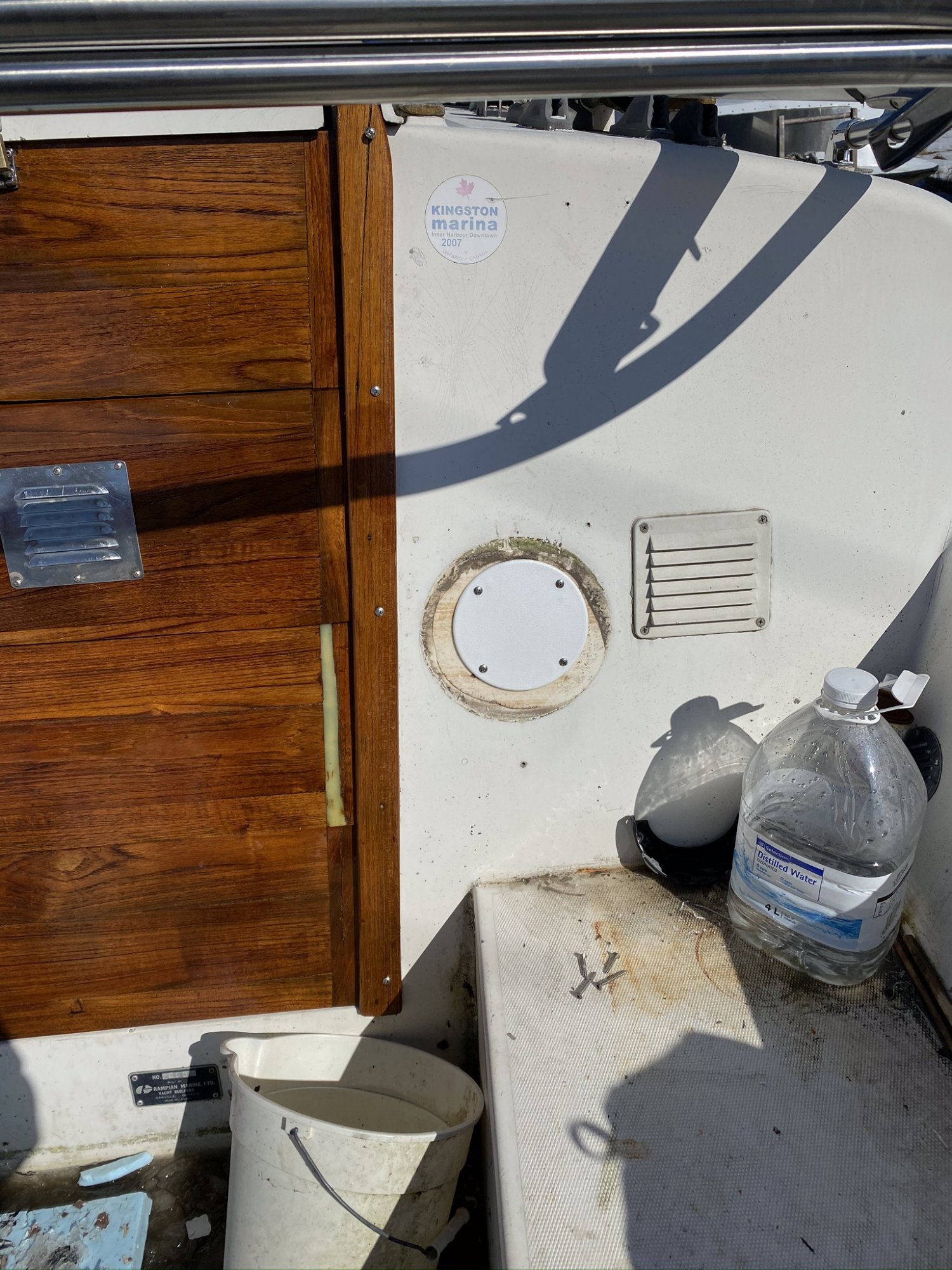

back from the boatyard, gone 12h to work 5 ½h rest was travel and lunch, been a long day, patched some holes with some round plastic plates, re-installed the inside companionway handholds, well partially, the screws did not want to go back in, 2 of them were really stubborn and left 1 inch of unscrewed thread, going to get new screws, re-installed the companionway side boards, the boat finally is locked up. my friend and I removed about 5 inch of ice and water from the bilge, which means we were able to remove the old cabin sole (dead wood). I managed to take basic measurements for the foam I need for the berths, finally managed to remove my wall cabinet, it was really stuck there.
removed the old crown charger, man is that thing heavy
while we were emptying the bilge we removed the old bilge pump which I suspect is dead after 3 years on the hard with a lot of water.
