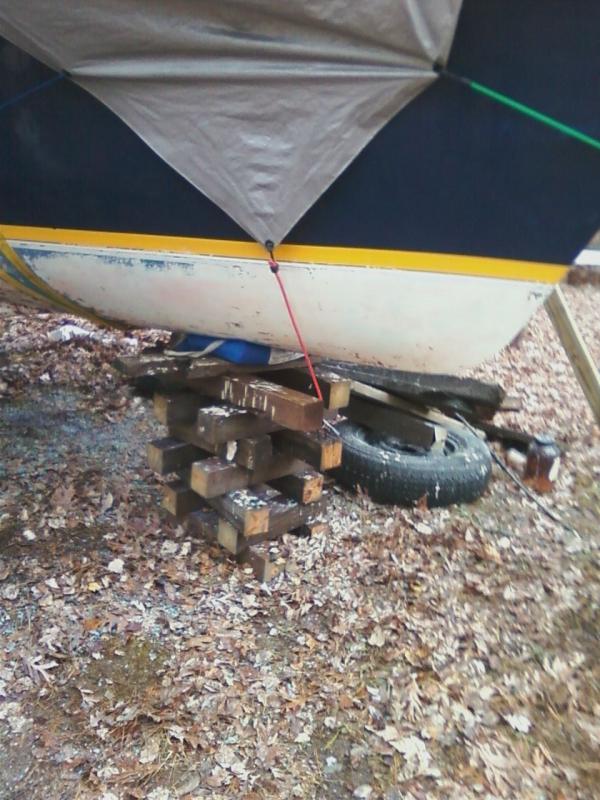

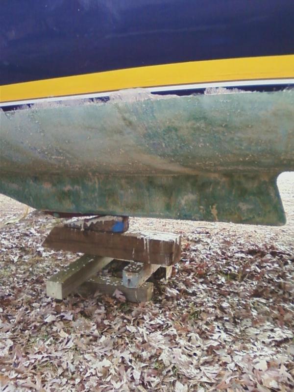

Ross: your peel away advice was dead on the money. I put some KOH and a bag of garden lime (hydrated lime) into a 5 gal PVC bucket along with a smidge of glycerin to keep it moist and rolled it onto my boat's bottom with a standard paint roller. I left it for a few days and hit it with the pressure washer. The paint just flaked right off (see pics). I'll suck up the chips with my shop vac once they have dried out. Damn I wish I new this trick two boats ago. The next time I do this I think I'll use plaster of Paris as the binding matrix since I'm almost certain the active ingredient is the KOH and I'll add a 5lb bag of sugar. The sugar should help keep it moist and "syrup like". It cost me less than $5 since I already had the KOH but I think anyone could just use a few cans of drain-o if they don't have access to KOH or NaOH and any binding agent (like powdered lime or plaster) and something to keep it moist (like paper or maybe my sugar idea?). I have a few tough spots to rework and I'll let the list know if the sugar idea worked or not.
