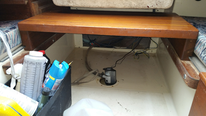

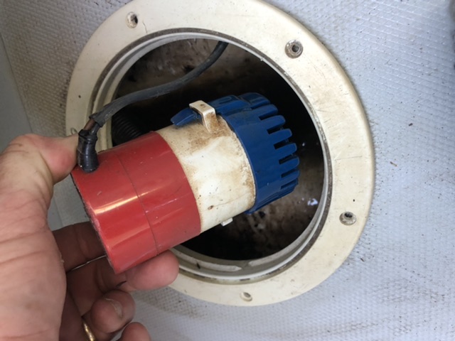

My Gloucester 22 has a Solar Panel to keep the battery topped off. The bilge opening is a 4" diameter capped hole. I use a portable DeWalt battery operated vacuum to suck out the water but would prefer it to be an electric bilge pump. Attached is a photo of the bilge opening. I don't have any drawing on the boat but it looks like the bilge is a thin cavity under the central part of the cabin. The previous owner gave me several burnt out pumps. The bilge is not deep enough for the pump and burns the pump out.

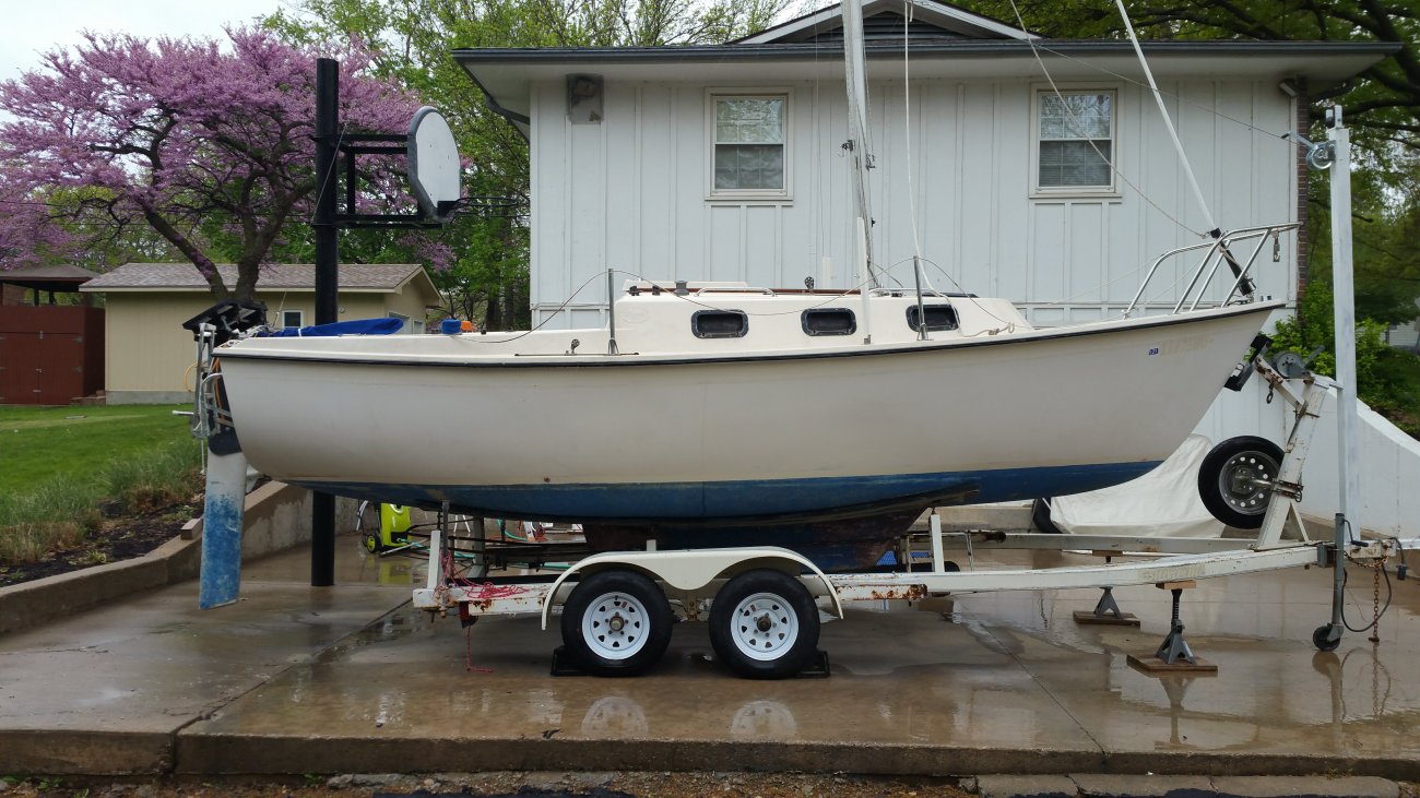

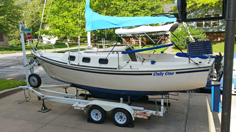

I bought the Gloucester 22 a month ago and I am trying to upgrade it for this season. It is in fair to good condition but I have quite a bit of work to do on it to get it upgraded to where I want it. It is on the side of my house where I can work on it as I have the opportunity and the weather cooperates. We have had a lot of snow this winter in North East Kansas. Would you mind sharing a photo of your boat? I want to change the color scheme. I'm not crazy about red. I'd like to see other examples of Gloucester boats. I understand there were only about 100 22's built. I wonder how many are still sailing.

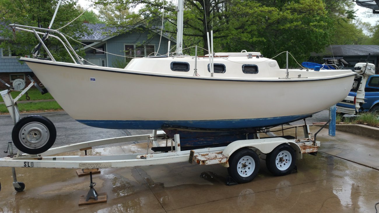

Nice looking boat and trailer. The stub keel will assist with loading onto the trailer and centering the boat where it belongs. It appears that there are rods on either side of the keel to help it slide into place. Wider at the back of the trailer I guess.
RE: Bilge.....(1) Could you probe the bilge area with a plastic tube, coat hanger, or length of hose? That might help you determine the overall length of the bilge and whether there might be a deeper section. A post in another discussion suggested trying to photograph the bilge with a cell phone camera. Could that help in your case? Maybe a mirror on an extendable handle would help you just look under the cabin sole. (2) Try "sounding" the cabin sole with a plastic mallet, wooden mallet, or a screw driver handle. That should help you determine the edges of the hollow area that is your bilge. (3) The opening for your bilge appears to be a deck plate/observation port and a cover (snap fit or screw in). IF you discover a deeper area within the bilge you might "grit your teeth" and make another opening to fit another access plate above that deeper area so you could install a bilge pump there. Best Wishes, 31seahorse

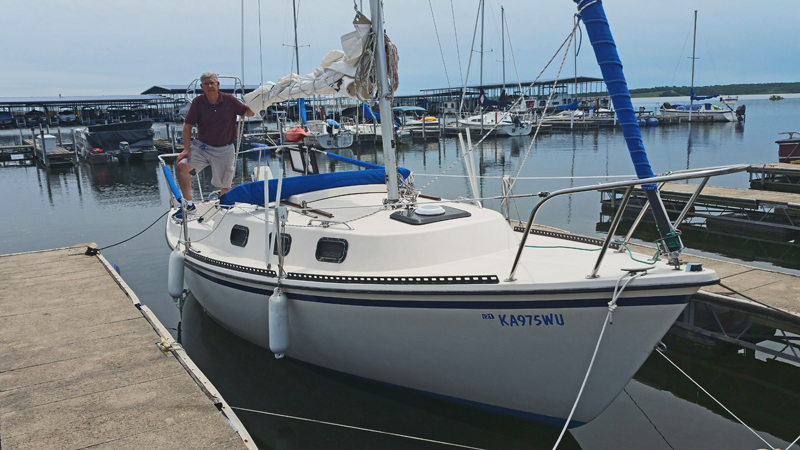

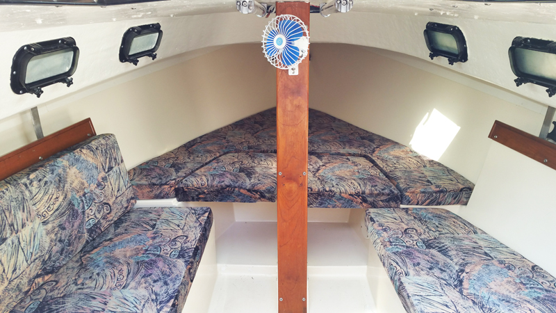

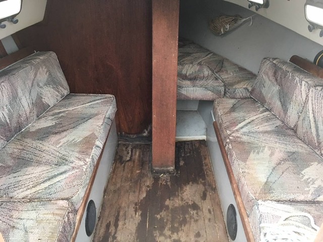

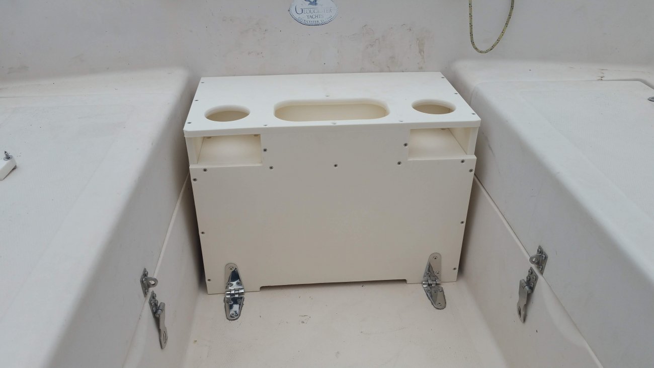

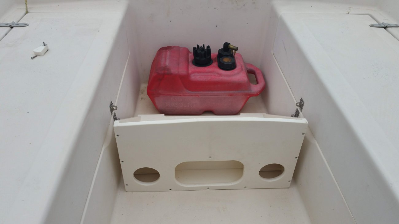

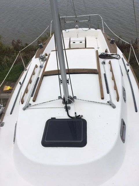

spent 6 weeks upgrading my Gloucester 22. New furling jib, replaces wood handrails with stainless steel, replaces as much external wood with marine plastic, replaced wood toe rails with aluminum rails from a boat salvage yard, built a gas tank cover from 1/2" marine plastic, added a fan mounted to the mast support in the cabin, spotlight mounted to the mast that can point forward or flood the deck. Added a stern rail and new lifelines. Added two winches to help raise sails. Removed old vinyl tape trim and installed new. The boat looks sharp and sails great! Not bad for a 1983 boat. It was worth all the "labor of love". 20190710_Gloucester 22-800.jpg 20190328_Gas Cover closed.jpg 20190328_Gas cover open.jpg 2019-05-15_Inside of Cabin-800.jpg
At 69 years old I love the furling jib. It was worth every penny. I still have a problem with water in the bilge trying to find a low spot for a bilge pump. I'd love to talk to any other Gloucester 22 owners.

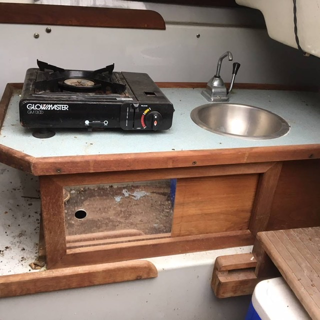

Hello folks We have hull 132, a 1994 G22. We have had MayFly for about two years but only just sailed her yesterday. Mostly successful but we are not immune from self induced mistakes! I had removed the sink console but for got about the drain being open! After about an hour sail we discovered we were taking on water! The bilge pump kept up and despite engine issues we were able to get back on the hard safely. Love the boat but oh do we have much to learn!

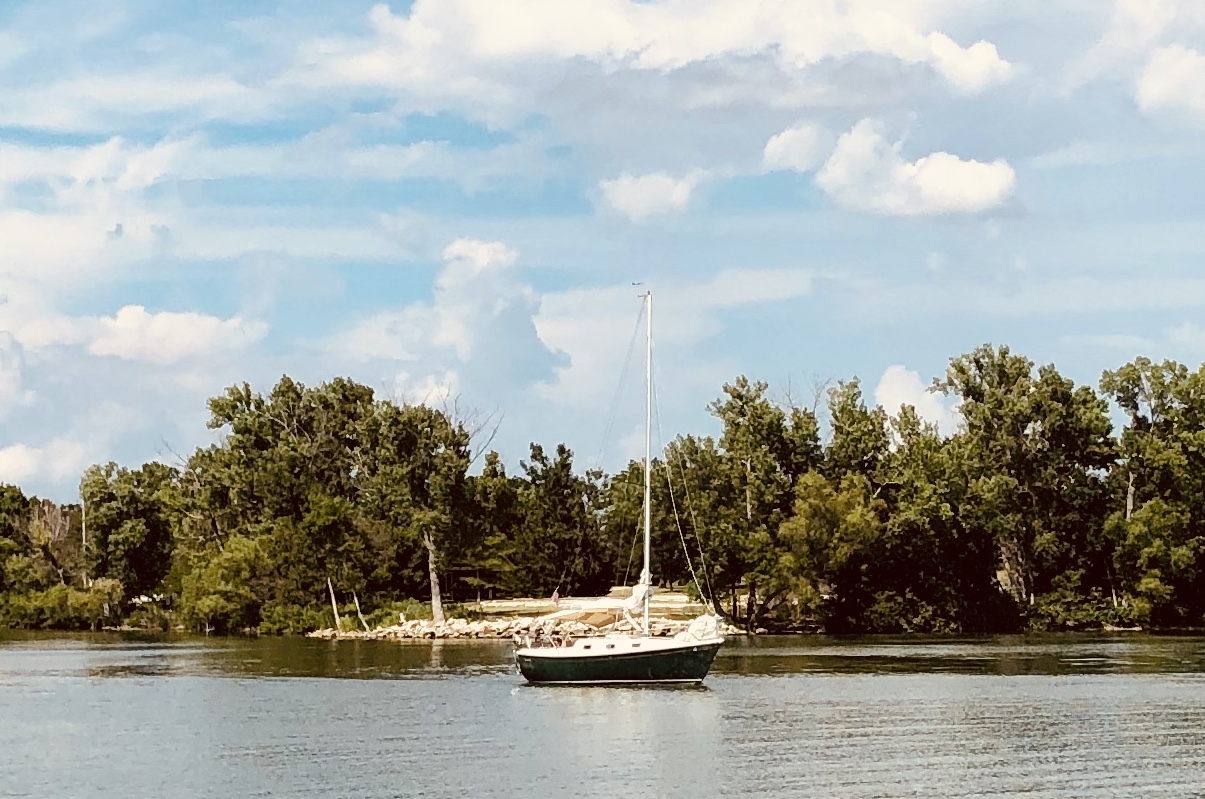

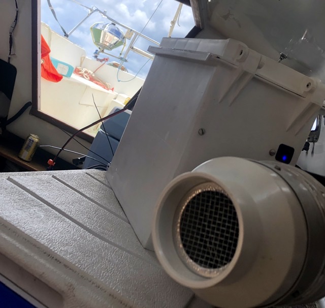

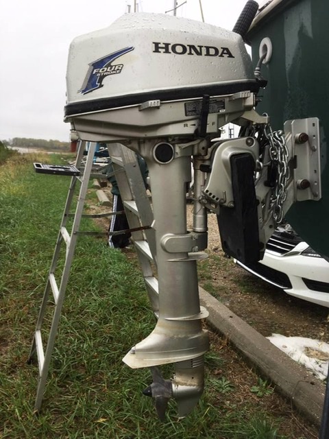

Had a successful sail on MayFly! No leaks, self induced or otherwise! I was also able to get the motor running flawlessly (Honda 5hp) with an upper and lower oil change, new water pump and cleaning the jet. We are in the process of getting used to the heel of sailing. Kansas winds tend to average 15-20kts in my experience and while that is very sail-able, it will take some time to get to know what she is capable of in those conditions, puffs, gusts etc. We anchored out without issue and I was able to try out our new FrankenCooler/ air conditioner that I assembled. 567BF313-0090-4BAC-AEC0-598DC12EF78A.jpeg00A96A96-0AA5-45BA-8D0F-DDBA6763227D.jpegDC3CEC6C-3117-433D-9D62-168435E862AE.jpegIt uses a bilge pump to circulate ice water from a cooler through a heat exchanger with a bilge fan blower. It worked well using a cheap, poorly insulated cooler in the humid 90 degree heat but I will be looking to upgrade the system in order to prolong the cooling.
