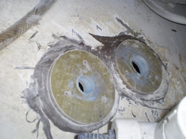

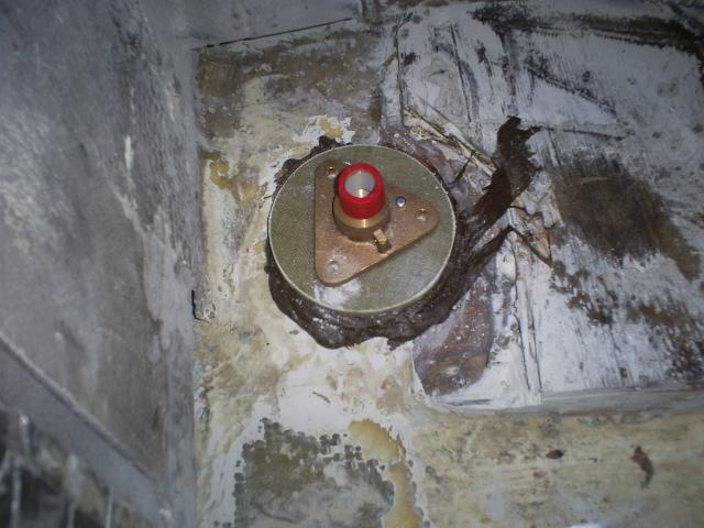

I am ready to fix the backing plates tomorrow(sunday) to the hull. I bought a new drill, all the apropriate hole saws, epoxy, sikiflex, bronze hardware. I also picked up a can of short hair bondo polyester resin, and I have most of a can of long hair polyester resin.
The epoxy takes days to fully cure. The polyester bondo hair cures in 30 minutes or something like that. Is it worth turning it into a 2 day event to use epoxy instead of the hair polyester? If I use epoxy, all I have available for tomorrow is 24 oz. roving, can I cut that and unravel it and stir in into epoxy to make a suitable mixture for fixing these plates? What is the best way to do it with epoxy? Do I need to keep pressure on these plates to get them to adhere properly?
With the materials I have available, please give me a short detailed instruction of what and how I should do this.
I have long hair bondo polyester, short hair polyester, 1/2 gal. polyester resin in a can,
one gal.epoxy, 24. oz roving. I think I can get chopped matt from the yard tomorrow.
