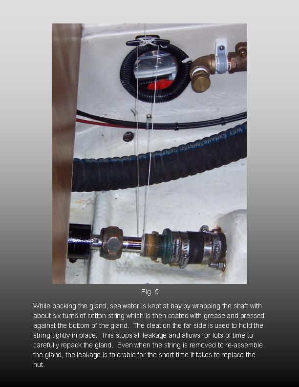

................ try this method when you're packing the gland. Take all day and not take on a drop of water.

Go slow and you'll have no problems with (and may even enjoy) this project.
