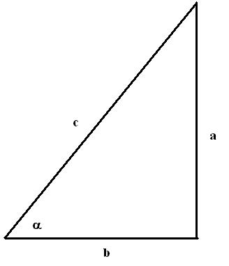

For the mathematically impaired.
a = the bridge clearance
c = the height of your mast above the water
alpha = the amount of heal you need
sine (alpha) = a/c
I've seen this one before also. I believe he fills the water balls at the gunwale and as he hauls them up using the halyards the boat heals until he reaches the desired angle (alpha). The last time I saw this video I think there was a link so you could purchase these water ball things.

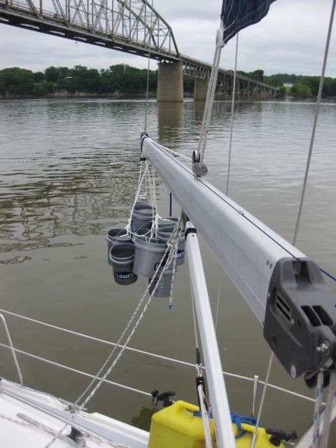

I have put buckets on the end of my boom to get a couple of feet for bridge on the Cumberland River. Got me about 2 feet of clearance.
