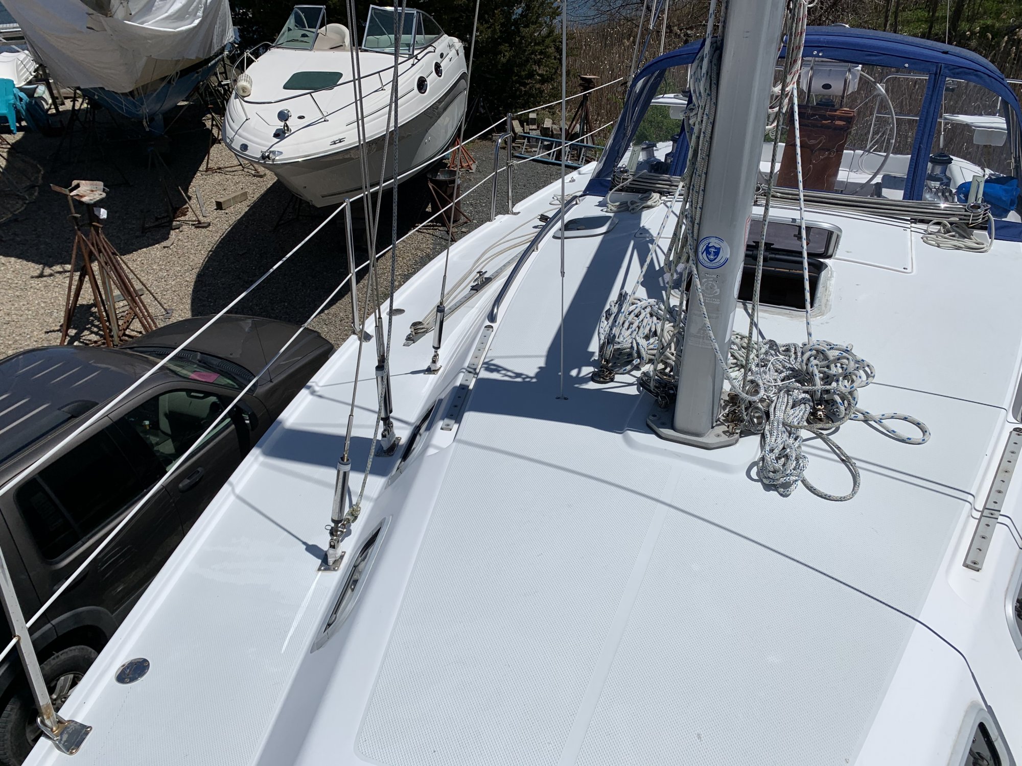

My boat has tracks for a storm jib, but the tracks have never been used. It's funny, my Starwind had the tracks on the outer rail and I wished I had inner tracks. My Catalina 320 has inner tracks and I wish I also had tracks on the rail (as Catalina 34 does have). I use the midship cleats on my tracks. You will be happy to make this addition and I think it is very unlikely that a side force would cause any damage. I would rather have those cleats on an outer rail. Just about everybody mounts those cleats on a track, just as they are designed! ;) You can use the slider cars for snatch blocks as John says. There are probably other uses as well. View attachment 217967

I see you have a track cheek block?? that you use to move your jib block without needing to tack ??
Does that work well ?
When @Scott T-Bird sees this I’m sure he’ll say yes. I saw it in action when I crewed with him.
I installed the same setup on my C30 after reading @Joe S comments about using it on his boat and recommending it.
Its availability from Garhauer. “EZ Glide Block System” if I recall correctly.
I was happy to see it installed when I purchased the boat. This Garhauer kit allows you to adjust the lead position to adjust twist in the genoa while the sheet is under load. If you are racing your boat, it would be considered indispensable. If you are not racing, it's not necessary, but you'll still be very happy to have that sail control. It is far better than pin-stop controls for sure. It is similar to line controls for your traveller versus pin-stop controls.
