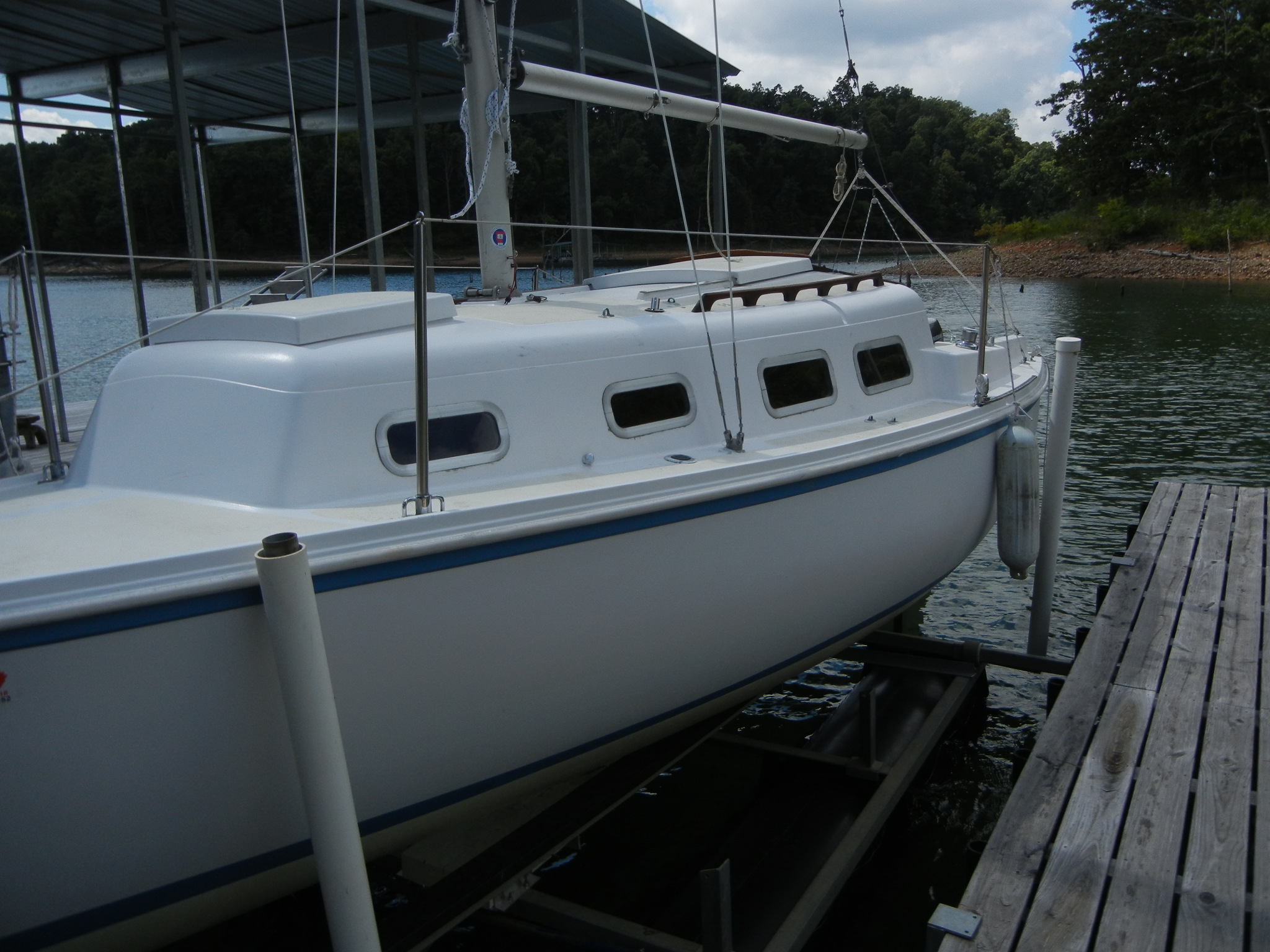

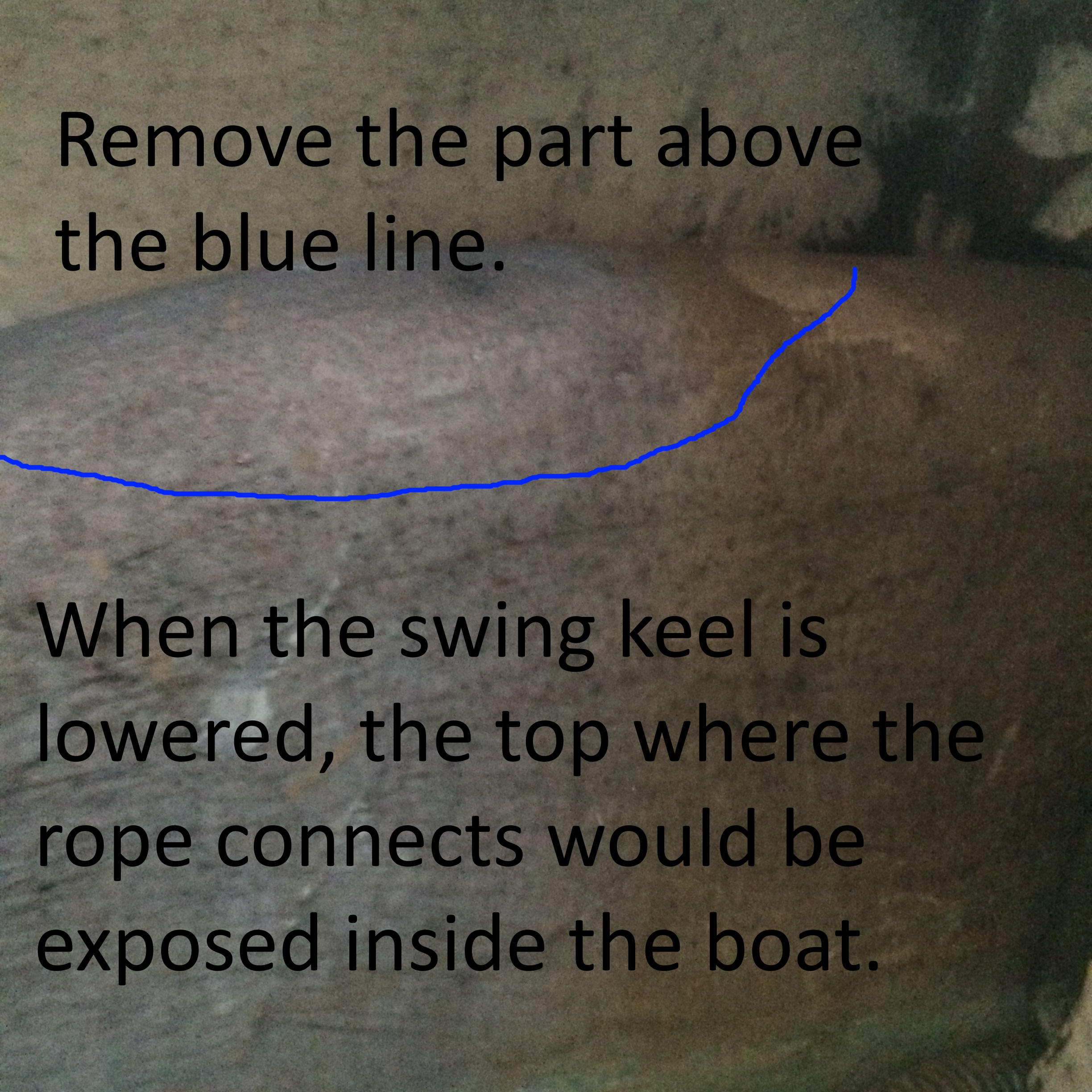

The other option my son came up with is to cut two inches off the top of the cavity the swing keel resides inside. that fiberglass cavity sticks up under one of the seats inside the boat. My son thinks we can either fiberglass the cut off section back together, or create a removeable access point by adding a flat fiberglass flange around the cap and base. We could then drill holes around the flange. Then make a gasket and use stainless bolts to clamp the two sections together. Had the manufacturer done this, it would have made easy access to the rope and clamp. We wonder why the manufacturer did not do this.
Below is a photo from inside the boat. One problem we may encounter is the top of this cavity might be below the water line. It is difficult to tell. I will try to figure out a way to measure it. If so then we couldn't do this with the boat in the water, which would be the easiest place to do the repair. The swing keel is up and in the wrong position when the boat is on our trailer. The clamp is way forward and cannot be accessed. I may be able to place the boat on a different type lift with the center open so the swing keep can be lowered, after the boat is raised.
The boat is currently water tight. There are no leaks in the hull. The boat had been in the water for seven years, when we purchased it. The bilge was bone dry. There is access to the bilge area. We can see the lowest point where any water would settle. The boat has a hand operated bilge pump. The water pickup area is right next to the swing keel cavity.
Here is my concern: If we cut this section off and then fiberglass it back together, will it still be solid enough to hold up in rough water. I can see where there might be a lot of water pressure applied to the top of that cavity when the boat is rocking back and forth. I don't want to do anything that might become the source of a leak later on. If that cap was to pop off, water could come gushing into the boat. That part of the hull is the thickest part of the fiberglass. That cavity may not be as thick at the top, but I'm guessing it must be at least a quarter of an inch thick, based on the width of the swing keel that resides inside it. The swing keel is almost two inches wide, and the external dimensions of that cavity is about four inches wide.
If this idea could work, it would make servicing the swing keel cable really easy, assuming we don't sink the boat in the process.

After a year of restoration work, we launched the boat last September 5th, and then immediately placed it on a lift. We then modified the lift, by adding an additional lift tank to get the boat higher out of the water. That worked well. We have had some high winds since and the boat and lift do rock a bit when it whitecaps, or when a big motor boat creates a large wake, but the whole setup appears to be extremely stable.
I hope to learn how to sail it this spring. I have replaced all of the other lines on the boat, with the exception of the swing keel rope. If that swing keel rope breaks, then we are operating in crisis mode to get it repaired. I like to plan ahead and fix things before they break and cause problems.

A suggestion...
If you open up the trunk consider making a box like shown above with a flange on it. Then make a lid and a gasket that would bolt to the flange. I'd make the box first and set it on top of the trunk and trace around the bottom of it and then make the cut. The flange for the lid could be much lower than shown above. It could be right at the peak of the present trunk. Just make sure it is wide enough to get in there to replace the line.
This is going to be some work but if there is room to do it where it needs to be done and you think it will serve you well down the line then do it,

Not knowing this boat nor if the top of the centerboard box is above, at or below the water line can also be risky. I would advise not cutting into the top of the centerboard box or housing. One day you may want to sell that boat and I can tell you many will walk away seeing what you are proposing. Then if that cut out is made and fail, the time for a boat if sinking is substantially worse as you have less time to get the heck out of the cabin.

I'm guessing the area you are talking about is the curved upper part of the truck. How close is the trunk to the seat and the sole? If it is tight I'd probably look for a different approach also.
If one is well versed in fiberglassing I'd have no qualms about them designing it for adequate strength. I would never worry about it popping off, but would suggest only undertaking the job if they were very confident. The area is so close to the waterline that water pressure there is minimum but as you mentioned can be greater if you are pounding into some waves.
Also as CD mentioned this could effect the resale, although I wonder how much with a boat that old and one might see it as an improvement, if it was well thought out and done well. Good luck,

Thank you, Sumner. Good idea on using that blue line on that drawing to show the swing keel cavity is below the waterline. Yes, that is the area I talking about. There would be water pressure at the top of that cavity for sure.
