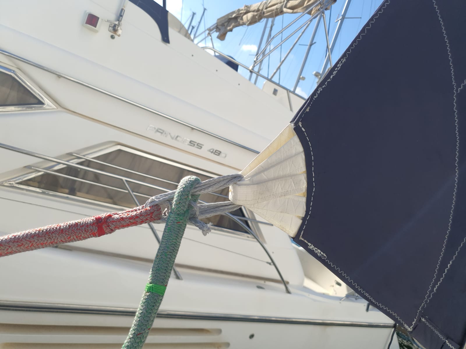

I'm ordering a new genoa 120% and the sailmaker is offering me a number or clew options. One is the "soft" clew that I don't have any experience with it. Obviously you dont have the metal ring to hit the mast when tacking...but I was wondering if anyone has first hand experience. The cost is all the same.
I am attaching a picture.
S/Y Christine
13,947
No experience with this arrangement, however, it is interesting. It will be lighter than a metal clew which will be good for light air and it will hurt less when it hits you in the head.
The only drawback I see is having to splice eyes into the sheets. It will be harder to change sheets if that ever becomes necessary and you may need new sheets as old line is more difficult to splice.
DougM
Jul 24, 2005
2,242
Beneteau 323 Manistee, MI
In your photo, the jib sheets are attached to the clew using a piece of dyneema or comparable line. That appears to take the place of the metal ring and is probably nearly equal in strength.
The metal clew ring on my jib is attached to the sail using the same strap arrangement shown in your photo. What is questionable to me is the use of spliced loops as attachment points on the jib sheets, and having to attach and detach the sheets by untying the Dyneema loop. As I understand it, that line does not hold knots very well.

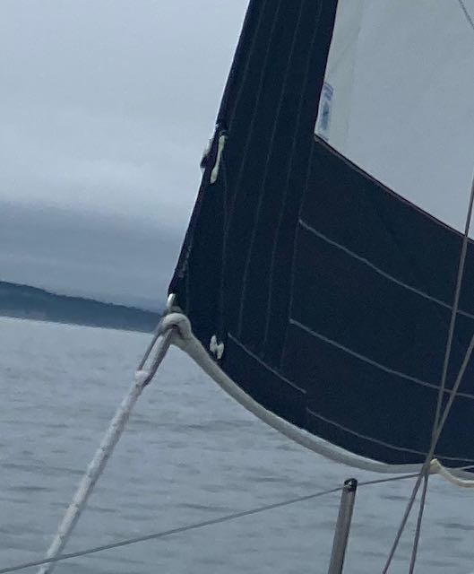

My new genoa came with a small clue ring.
I attached the sheets 4 seasons old using eye splices on the sheets and a dyneema soft shackle.
The soft shackle could work on the soft clew as well. No issues with the dyneema “slipping” apart.

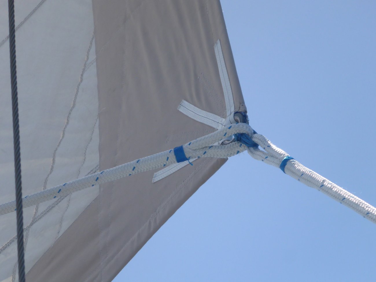

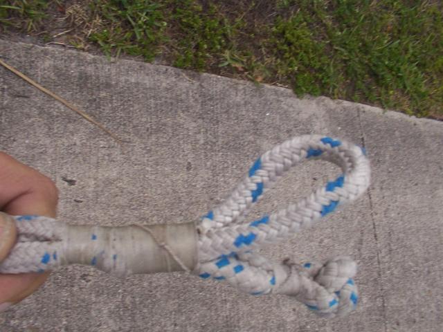

With my 3.4" sheets, bowlines or any knots are very impractical as a connection to the clew. I've been using the connection below (Dyneema) for about 8 years now and it is neat, clean and we have no problems at all with it, but I don't change headsails. When I order new sheets I get them spliced on both ends so I can turn them end for end annually. They last twice as long. I'm sure it would work just fine with the soft clew ring, but I have had a soft head "ring" on the jib fail while sailing, so no, I wouldn't recommend it. That was a fun night on the foredeck sewing a new attachment point to the sail, while my charter guests slept soundly in their bunk.

24,453

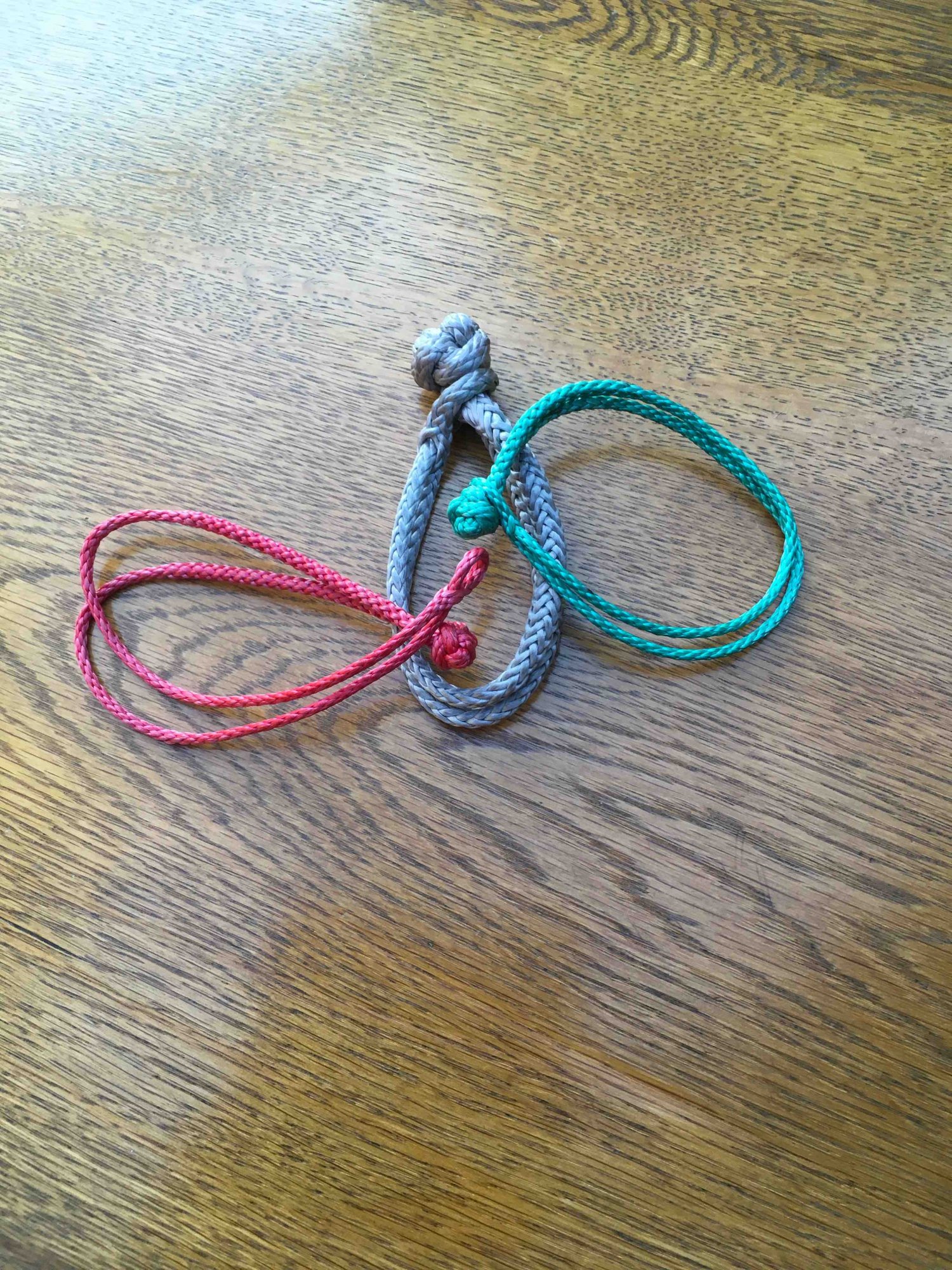

Here is an example of the my soft shackles and the image of in use on my sail.

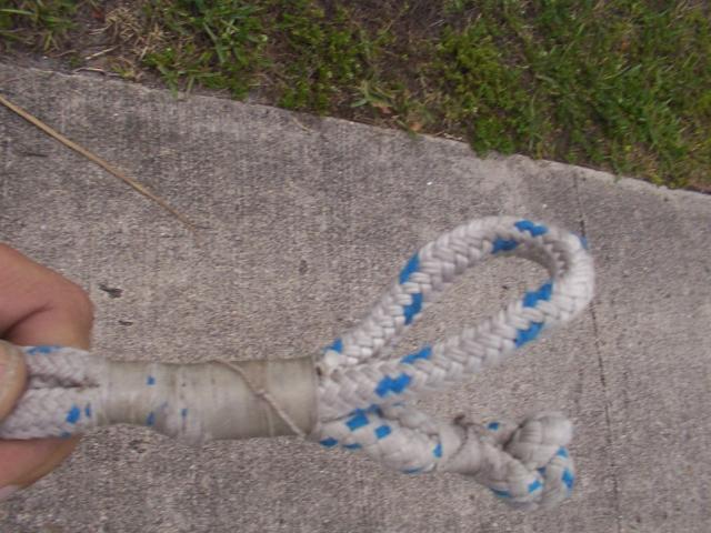

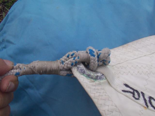

Mar 1, 2012
2,182
No. How do you tie this configuration of a loop and a end knot?
Ok- the part with the knot is tied in a doubled line, then stitched to the sheet loop. then that is lashed to the doubled sheet tightly making sure the loop in the sheet is JUST large enough for the knot to pass through.
I have many many sailing miles using this, learned it from a friend in Florida who has also used it for years. No
complaints.. Oh, and if it flogs and clonks you in the head, it doesn't leave blood :)
