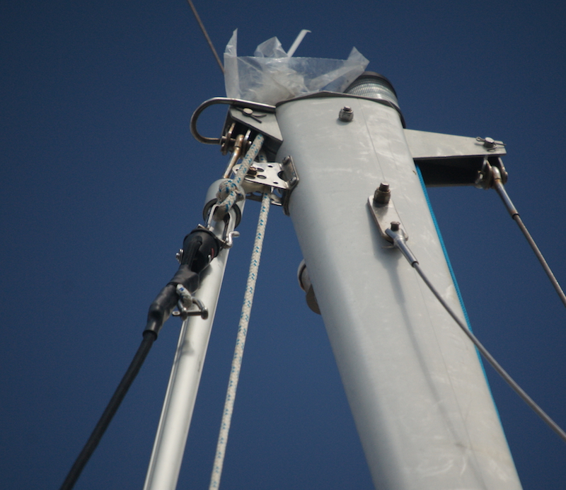

And if mine is not a halyard, then what is it??
Cheers
Do you have a CDI furler? If you do you might be using your jib halyard as a spin halyard.
If not a picture might help sort this out.
Aug 1, 2011
3,972
Spin halyards NEVER do that. If it exits below the forestay, its not a spin halyard.
Hold on there cowpoke. Ours, both of them, exit right beside the forestay, and if pulled forward (not mostly down) they will quickly get hung up in the tang. The picture that Gunni references is what our crane now looks like, and the kite halyard routes the same way. The only way to get one of the "factory" halyards to go forward enough to get to the block would be to reroute them through the top of the mast cap. (and yes, you're hearing me say that there's a limit)
Nov 8, 2010
11,386
OK right, to be more clear the mast EXIT might be below, as long as the halyard is run up the the masthead and the crane. The only trick is that the run up from the mast exit is clean.

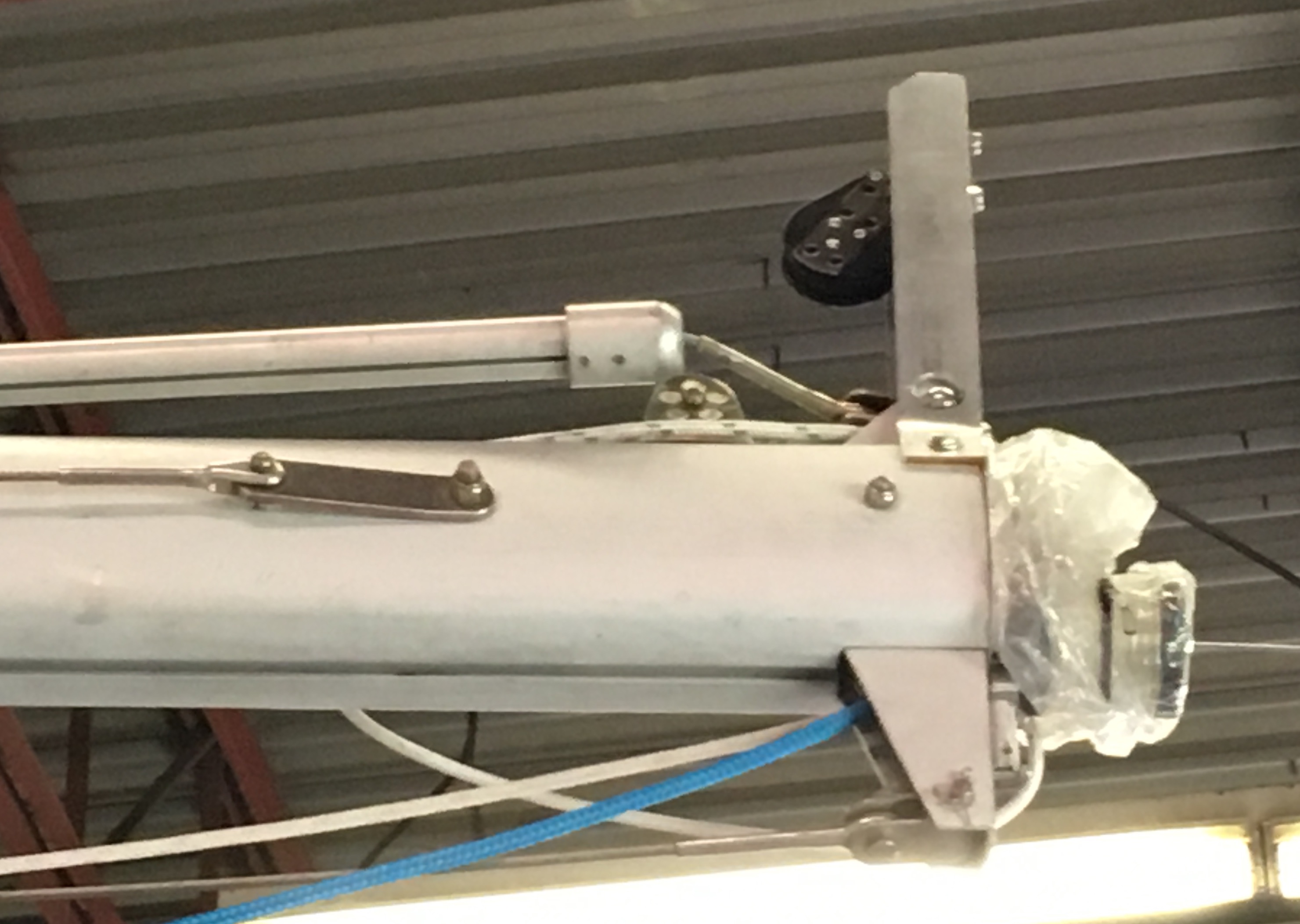

@DaveJ , We've been down the crane road a couple of times. The issue is that the "factory" halyards will bind with the tang that holds the forestay if they don't route pretty much down from the mast exit. Here's what it looks like without the crane, and you can see how it would intersect with the tang if extended forward to a block on the crane.
Our current version extends a solid 6" in front of the furler swivel, but also uses it's own halyard since the tang is still in the way.

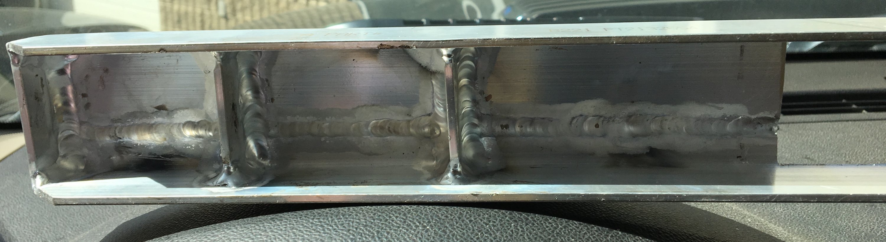

This crane was welded up from 3/16 angle aluminum, bolts to the original crane mounts, and also has two bolts into the mast. It's very solid and very light. This is the part just back from the tig shop, prior to machining and cleanup.
I'll get a picture on the weekend now that the mast is back up.
