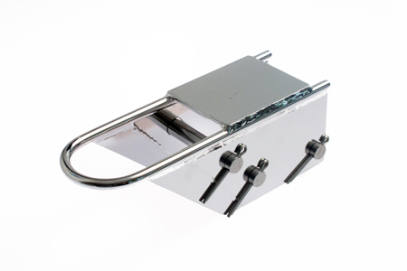

DaveJ
Apr 2, 2013
486
Looking at the picture supplied by Gunni, I see a halyard exiting below the forestay (same as mine but mine is a little higher up the mast) and it goes up to a block that is attached to a bracket that looks like it was added to the top of the mast. I do not have this bracket. Is this an item that can be easily purchased and installed? The halyard in the picture looks like it rubs on the furler 'swivel', is this normal?....doesn't look right to me.
I agree with posters above that doing an inside gybe with this setup would not work, but doing an outside gybe when the halyard exit is below the forestay would not work either.
And if mine is not a halyard, then what is it??
Cheers
Joe
Jun 1, 2004
8,194
I found this masthead crane at www.catalinadirect.com It's for a Catalina 30. Didn't see anything for a 310... but a call to catalina direct may solve the problem. At the very least you can have one made to your boat's specs based on this design. Another good resource if the Catalina Yachts factory You'll have to call their parts department (the switchboard number is at the bottom of the webpage) but you will talk to an expert on your boat when you get through.
The crane in Gunni's picture is pretty heavy duty, maybe to much for your boat. So if you have to have one made, use the C30 one above for design inspiration,
BTW what you are looking at in Gunni's picture is a pretty typical set up. The jib halyard that connects to the furler's swivel goes all the way to the top and back down the mast internally. The metal clip looking thing is a "halyard restrainer", it keeps the top part of the swivel from.... uh..... swiveling.... so the halyard doesn't wrap around the fore stay.
The spinnaker halyard is not in any kind of danger... it's rigged externally and can be secured back against the mast or on the lifeline or wrapped around the spreader to keep it from slapping.... etc...
