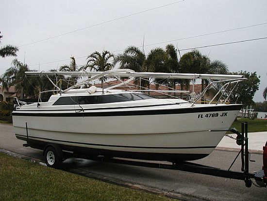

I posted the following over on the "Trailer Sailor Forum", but it might have some use here.
We added 180 watts (3 panels) where the arrow is in the picture above. It worked well for us on a month trip to Florida that just ended, but didn't supply all of the power.
One important thing is how new/good are your batteries and how long will you be out and where are you sailing. Pulling the batteries down to 50% is not going to be good on them and I think ours (one was new and the other had been used for an 18 day trip--both are the same) are not as good now as at the beginning of the trip.
We were powering a 63 quart EdgeStar frig (real compressor frig) 3.5 amps when running, a CPAP machine at night at 1 amp with out the humidifier running. A dedicated 12 volt computer running SeaClear that uses 1.8 amps normally and 2.3 when the hard disc is accessed and 2.8 when using the WiFi with the router and Bullet 2 HP radio. It ran also all the time underway and a lot every evening when we had WiFi coverage or I was writing. A handheld Garmin Map 76 running 24 hours a day with the anchor set at night and hooked to the computer/seaclear with waypoint from it. A Cuda 350 GPS depth finder when under way. A 2 watt anchor light and a few other items like a cell phone charger.
Driving down, 2200 miles - 4 days the panels supplied power for the frig. We were down there about 4 days using the other items listed and then I finally had to run the......
http://purplesagetradingpost.com/sumner/macgregor/outside-13.html
.... 60 amp gen-set for about 1/2 hour.
Then over the next 3 1/2 weeks I probably had to run the gen-set an additional 1 1/2 hours total and we also got some charging from the outboard running with it for about 10 hours total in that time. Some of that time though the batteries were topped off and we didn't need the outboard output.
We have no need on the boat for 110v, so that is the reason for the 12 volt gen-set. It uses hardly any gas at all. On this trip of about a month, never hooked to shore power, we used about 2 quarts of gas in the gen-set to supplement the solar panels. Since it is permanently mounted there is no need to haul a generator in and out of a compartment and the Honda engine is usually a one pull start and is pretty quiet. Can't hardly hear it 100 feet away and being on an anchor all the time we are usually further than that from someone. In fact this was the first trip that we ever actually anchored near anyone and that was for probably only about 6 nights. In those cases I wouldn't run it after 6 or before 9 or so in the morning and never had to run it for more than 10-15 minutes. The vibration noise inside the cabin though is not good on our small boat and I'm going to work on that. I have made an auxiliary muffler to supplement the stock one since the pictures here and that has really reduced the noise for others. They can't hear the vibration noise. The gen-set for us takes care of any solar inadequacies.
I have a volt meter and amp meter running all of the time that both read to .1 of a volt or amp. I usually decide when to run the gen-set by monitoring the voltage with no real load on. I determine when to stop charging by watching the amp meter and usually stop when it gets under 10 amps as I'm down to diminishing returns by then. The gen-set will put out 60 amps, but the most I ever saw was about 28 and usually about 22-24 when I would start charging.
In the winter the sun angles are very low, even in Florida and the days very short. When we go back down after the first of April I'll bet we probably won't have to run the gen-set at all. We had clouds, but not near as many as someone would have further north in the eastern part of the U.S. or maybe Canada, so take that into account. I think the figures the others have posted are pretty realistic.
Since we don't have any more real room for panels I went with the more expensive MPPT controller to try and maximize the efficiency of the ones we do have.
Good luck and put as much wattage as you can up there if you are a cruiser and want to stay out for long periods.

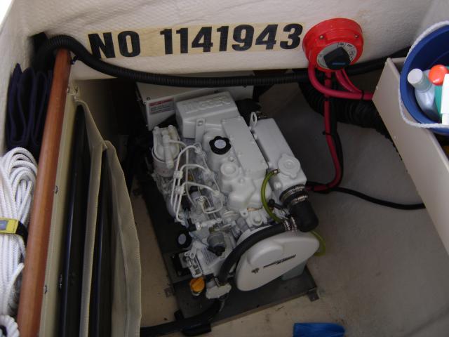

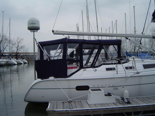

I have a 2003 Hunter 356 with a 2000w inverter/charger, 2 4D lifeline house bank batteries and a 5KW Northern Lights generator. I use the link 1000 monitor to see what is happening when the generator is not running or it is charging. I have a full complement of electronics including below decks autopilot, chart plotter, sonar, two laptops, radar, and a fully tracking satellite TV antenna (KVH) with a 20" lcd tv with dvd player and Dish network. We have the stock refrigerator/freezer and microwave. We have a propane stove with two burners and oven.
At peak load on the batteries, we will run 35amps at night with all the lights on and everything plugged in and running except the ac. We never run them down more than 50% and they are still going strong after 6 seasons. They last 7 to 8 hours on the 200 amps available to 50%. We are not big battery/inverter users though as the generator is our major electrical power system used.
We generally turn the generator on before leaving the dock and don't turn it off until we return. It keeps the batteries charged through the inverter/charger. We use the HVAC all the time as it is a water source heat pump and either heats or cools depending on the setpoint below. We are always comfortable in spring, summer and fall. The Northern lights generator uses about 1/4 gallon per hour and costs about 75 cents an hour to operate at $3.00 diesel.
The Northern Lights operates with 3 cylinders at 1800 RPM so it is smooth and quiet in operation and we had a custom sound enclosure made that reduces the sound to a very low hum. It is mounted in our port locker and doesn't bother us at all in our rear bedroom which is right next to the locker. It doesn't bother us and our anchor neighbors cannot even hear it. The exhaust is below the water line.
I have friends who have all the above stuff but no generator and have loaded up on solar. On a hot, humid day or night on the hook on Kentucky Lake, they generally end up with a generator anyway to keep their wife happy.
We use our boat about 75 days per year, many of them on the hook or cruising on the lake all day and into the evening. We would never have used it that much without the generator as my wife is content to read or watch tv while underway in the comfort of home. In a typical season, I will use around 100 gallons of diesel and I don't skimp on comfort or worry about motoring somewhere if the wind is not there for good sailing!
Another item to consider is a full enclosure. We start our sailing in March and go through November. The side curtains come off in early May and go on in October. This extends or comfortable cockpit season two to two and a half months over our friends who don't have one. I have sailed in 30 knot winds, 40 degrees on a sunny day with a sweatshirt on in the cockpit. Nobody else is generally out. I made a 40 mile run one March day wing on wing and barely touched the sails in relative comfort. I was also getting some assist from the heat pump as I left the companionway doors open.
Some sailors don't think you should be as comfortable as we are on our boat. To us, that is just stupid. We get more use of our boat than most people on the lake and really enjoy our second home. If we wanted to camp out, we wouldn't have made an investment in a boat like we have. Look into all these things before you buy but think hard about how you want to use your boat and equip it to do what you want to do.
