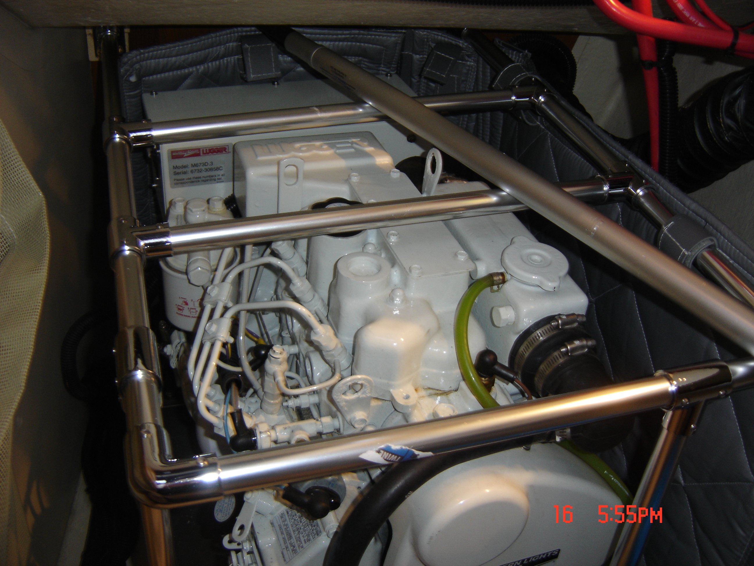

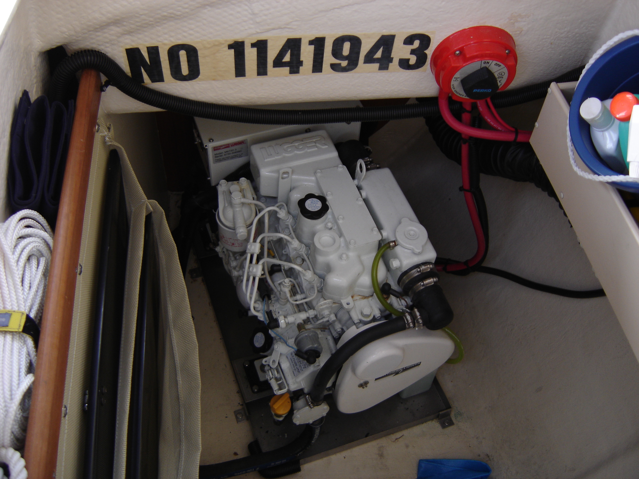

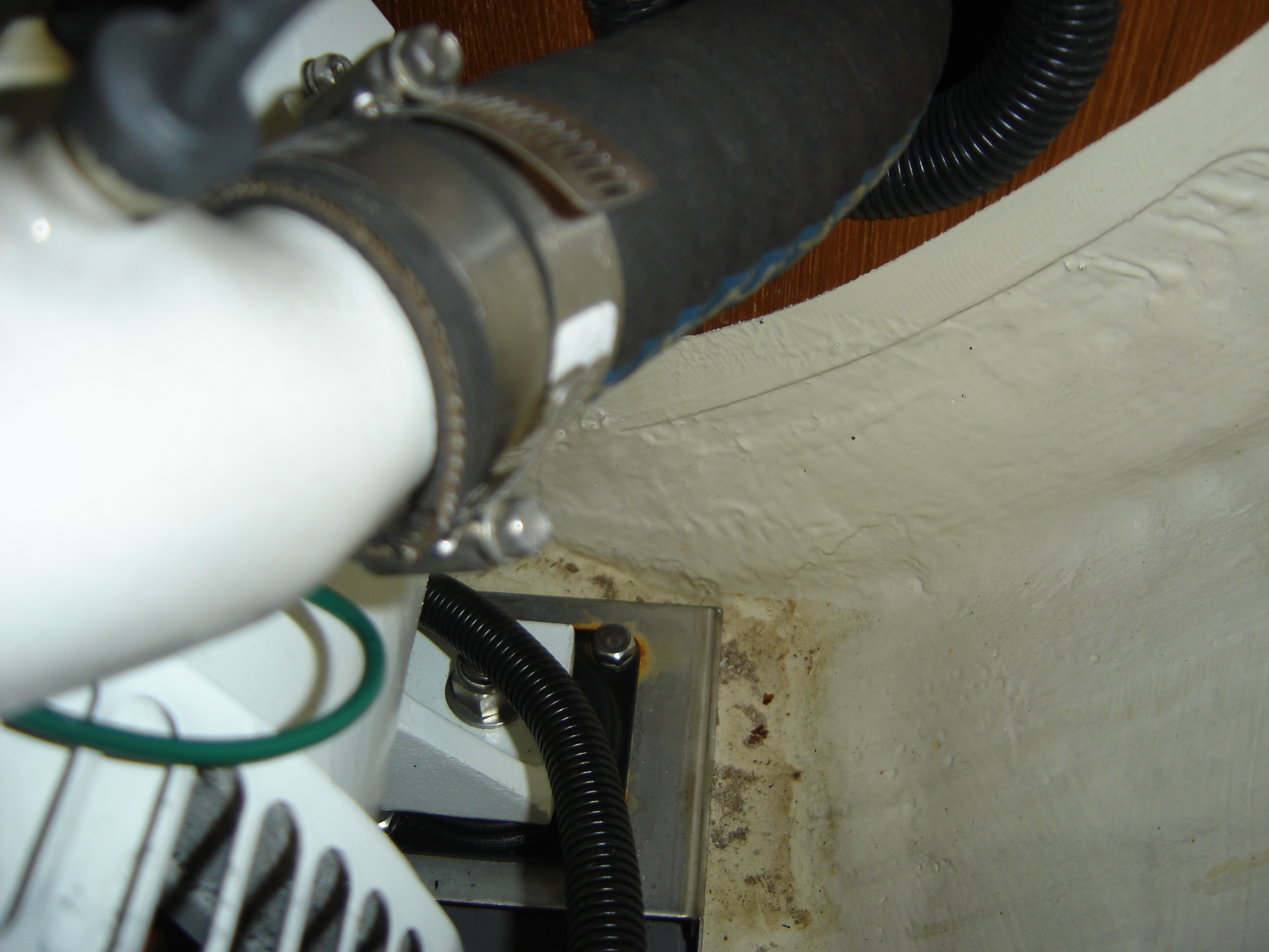

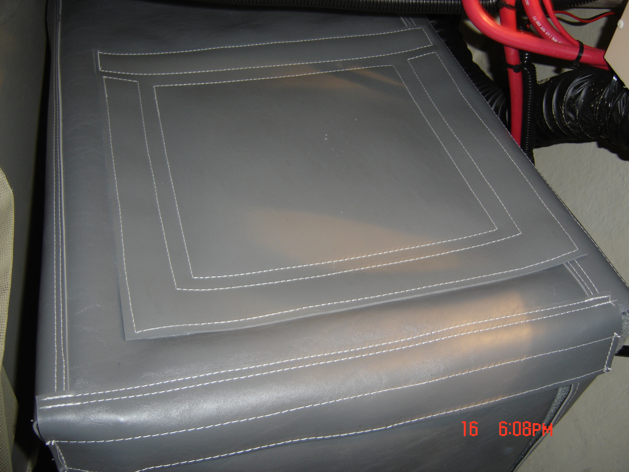

Sergei: My Northern Lights 5KW is in my stern port lazarette. It s enclosed in a soft custom sound shield. Raw water intake is ganged with my other thru hulls at the base of the companionway stairs. It exhausts to the stern with an underwater muffler. Raw water is exhausted out the port side just above the water line. I get about 65 decibles sound from it in the cockpit. Ten to 15 feet away from boat, you can only hear the raw water splashing. It is a slight hum inside and does go away after a while. It s not annoying. It’s sort of equivalent to running the air continuously on the HVAC which we do.
