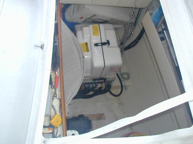

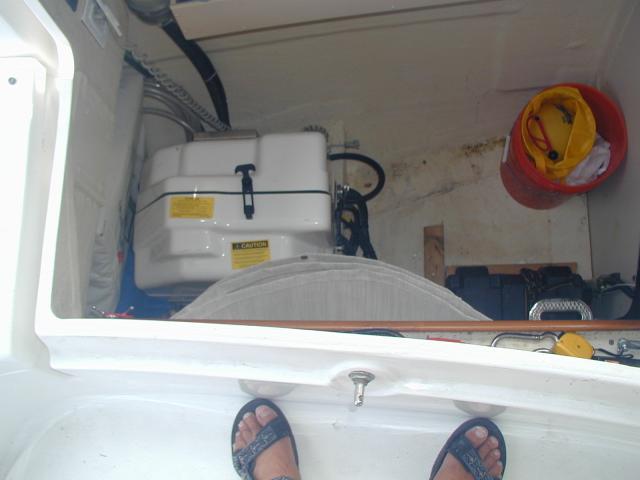

I have a diesel 4200 Fisher Panda in my 2007 H-36 and it is very compact and nice small size but you will pay dearly for the fact of its a diesel and compact size.
Do you have any nice size open compartments in your cockpit like the 356/36 Hunters.
