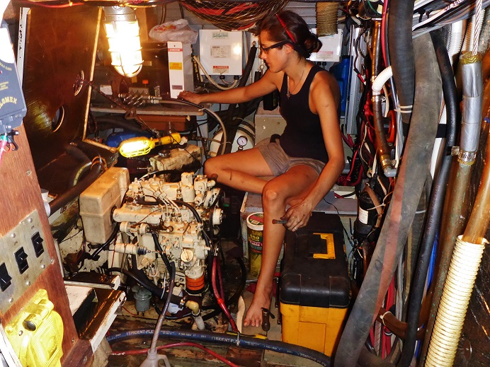

u paid soo much to lift engine? with all Block/Pulley and lines u got.
And just exactly what would you attach all these block and tackles to? I'm not drilling a hole or two in my cockpit floor for eye bolts only to have them become a source of leaks down the road, right over the generator I'm trying so hard to keep running. This generator weighs more than the engine on the boats of most of the members on here.
It's not like I wanted to pay that much, but I was so happy to even find that tool on the island (it took two full days of phone calls) that it would have been cheap at twice the price.
Got the job done safely and easily, with the proper tool.
Common, I am not criticizing, I just in no way would pay such money, it is not fair. You do not have to make holes, just put something above engine across, like log or jockey pole. I would put basketball under pan and inflate it. best wishes
capta
Jun 4, 2009
4,774
Sorry. We spent weeks trying to figure out how to do this job w/the tools we had on hand.
When a repair that needs to be done down here it's pretty much a question of what parts and what tools are available. Without one or the other a certain amount of jury rigging is possible, but the result may be of questionable longevity.
But when it's a job requiring lifting a 500# generator and while it's lifted, changing out the only parts that actually keep it in place, then the danger factor can exceed the cost factor. We did this job in an open anchorage (not a nice quiet bay) where a wake of some size from passing ferries, tour boats or fishing boats was a distinct possibility. Building an A-frame to do a one time job, even if it didn't mean taking taxis all over the island for the bits, would have been incredibly complicated as the generator isn't on the same level as the engine room floor and outboard of the stringers for the engine. As I said before lifting wasn't an option. We tried wedges, a huge crowbar and a few other tools, but the upper casing of the sound shield was not going to allow that.
So, even had I found a mechanic who would do the job for us (at a much greater cost than the rental) there were none on the island with any tool to do the job.
Trust me, though it was indeed highway robbery, had you been in our position with a charter looming just a few days away, you would have thankfully paid the money, done the job easily and safely and moved on to the next one. If there is anything to be learned from this, it's that I really wanted a Porta-Power aboard when I left the states, but I've needed one only twice in 8 years, so should I have bought one, or not? It's a big, heavy space taking tool that rarely gets used. Does the money spent offset the space it would have taken up over the last 8 years?
Maybe I could go into the tool rental business?

The generator is up and running with a new thermostat housing and head gasket. I was amazed at how good what I could see of the water passages looked. It's still an ancient, tired gene, but it's working it's little heart out for us, again.
If a back yard mechanic is a 'shade tree' mechanic, what's a boat, out at anchor in some tropical paradise mechanic, called? Only thing I can come up with is; lucky! So I'm hoping y'all get just as lucky if that is your dream. Thank you all for your input and help. It is much appreciated.
