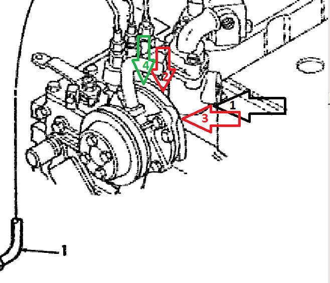

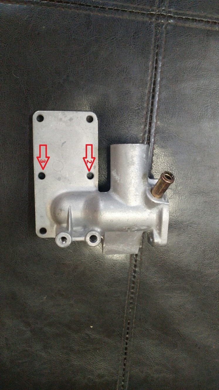

OK pics, sort of.
#1) thermostat housing
#2) is the upper bolt behind the water pump mounting (#4)
#3) is the lower bolt behind the water pump mounting (#4)
There may be ½" between the two but I doubt it as the water pump mounting back is not flat, but rounded.

From one of the tractor sites dealing with this issue they suggest either a ratcheting box end wrench or a crows foot wrench on the end of a standard ratchet (alternatively bending a standard wrench was indicated to work as well)
The same sites indicated that reinstallation at those locations was the difficult part but they did have some suggestions how to deal with that as well.
The search I used was "D950 thermostat housing replacement"

The timing cover is a marinized part so instruction for this part are different. There is absolutely no way to get either of those wrenches in there.

Yes I have and as an Engineer and one who has rebuilt several motors you can not fit a wrench on those bolts insitu. And yes I've used those bent distributor wrenches

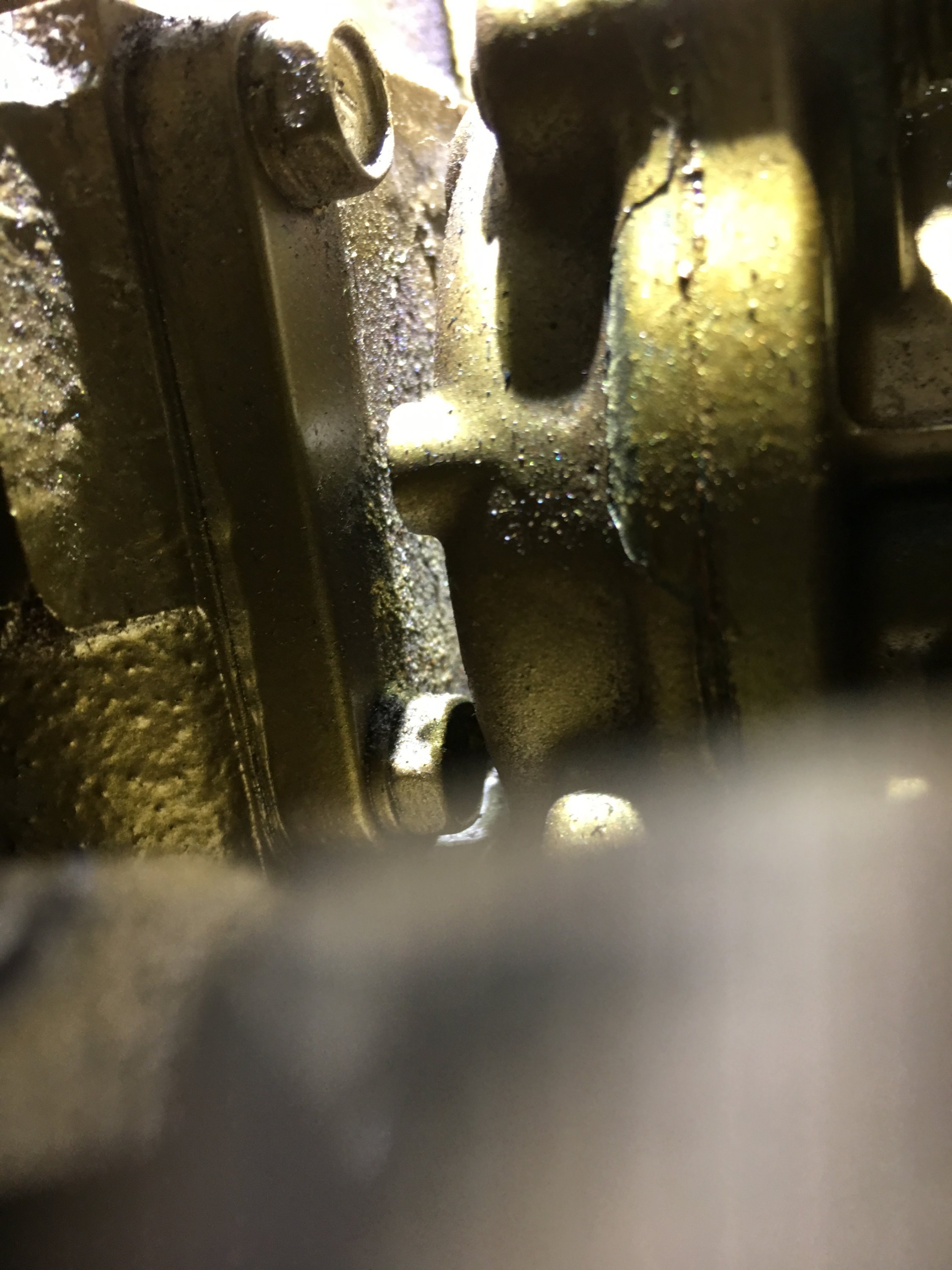

Here is a shot of the easier (lower one in pic below) of the two bolts. The other is so far in I couldn't get a picture. On this one you could get a thin open wrench in there but the bolt is threaded into the head more than the available gap. So either you remove the head or you remove the timing cover. The op thinks it is easier to pull the head. It certainly requires less specialized tools, Both ways would probably cost 6+ hrs of mechanic time (just to remove).

Thanks, Les. Yep, and all because some bright engineer thought it good idea to make the thermostat housing out of aluminum.

you guys gona say, that i am creasy, but i got used to that anyway. i would remove water pump, then drill through pump housing. to get bolts. what u think?
May 20, 2016
3,015
Ummm. That s the timing cover you would be drilling thru >$1200 used if you could find one. How do you want to seal the holes after your done?? The size necessary to accomidate a socket is too much to plug with marinetex
