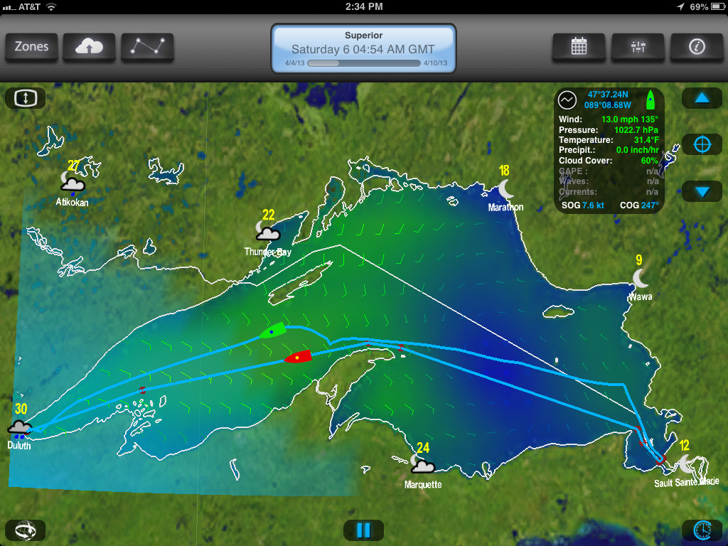

The value of polars for racers and cruisers alike really come in to their own when combined with weather routing. Combined, the system can calculate the best course to steer to keep you in best wind, and get to your destination faster and safer.
You can compare the rhumb line course with the suggested track based on wind over a 36 hour period (GRIB file). Leaving from the east, the (green) boat is instructed to steer way above the (red boat) rhumb line, making a sharp break to West in new breeze. This type of software can shave days off of passages. Or races!
