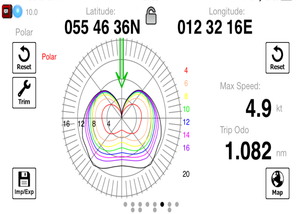

iRegatta Pro, interfaced with wind and speed instruments via WiFi, can collect, trim, and reflect this data automatically to generate polars.

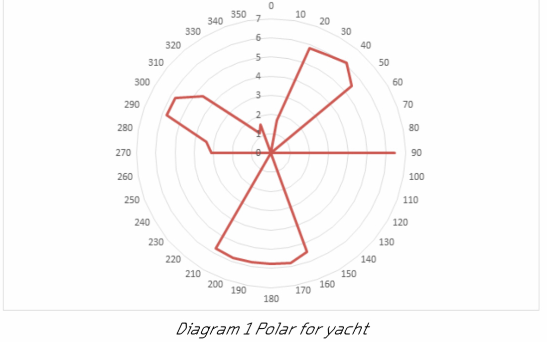

The yacht devices N2K data logger will also generate polars based on data collected from instruments connected to NMEA 2000 (or SeaTalkNG)
I did not know that! Which model? I didn't see that on their NMEA2K 'Voyage Recorder'. Would be a cool feature.
