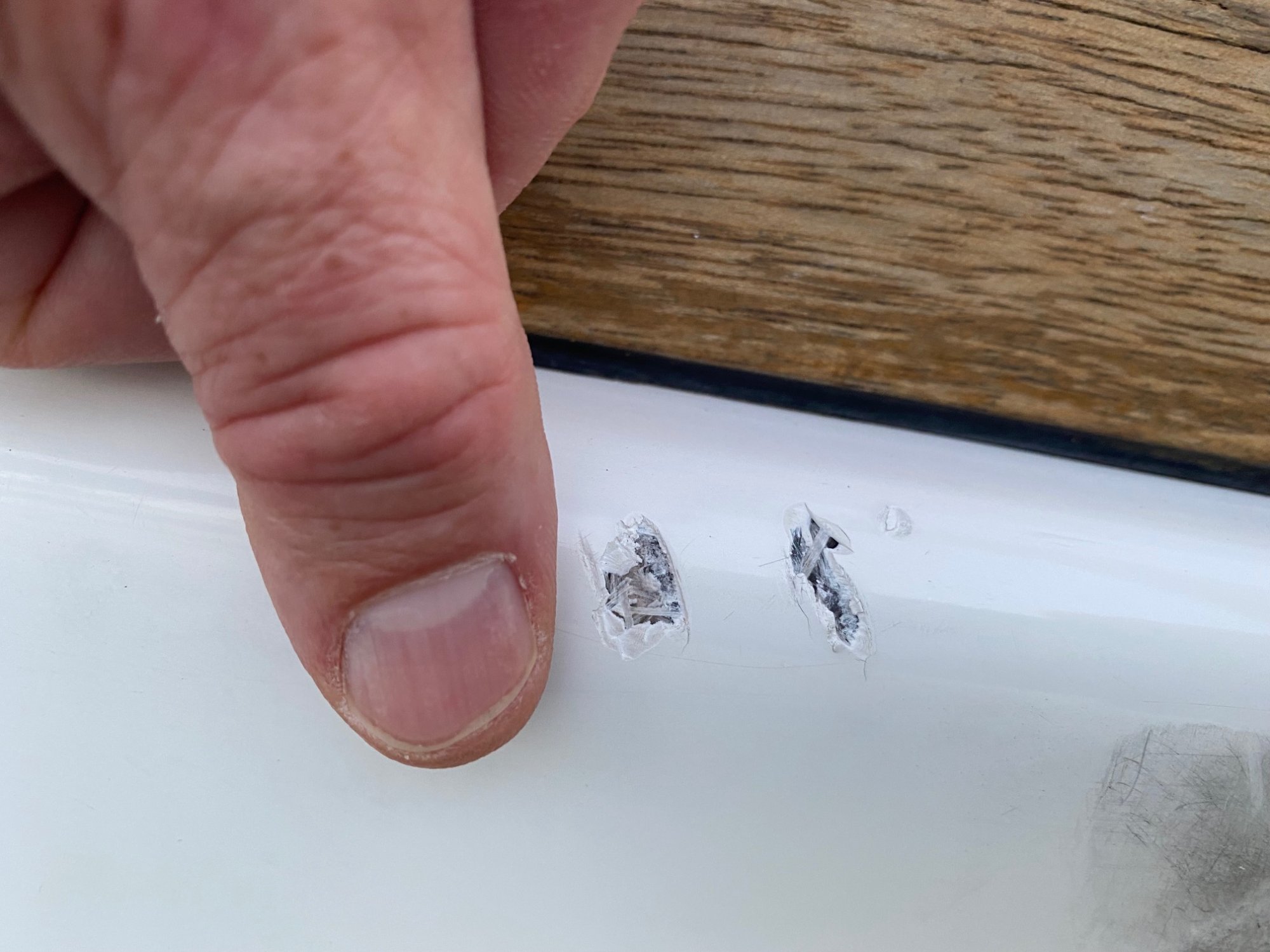

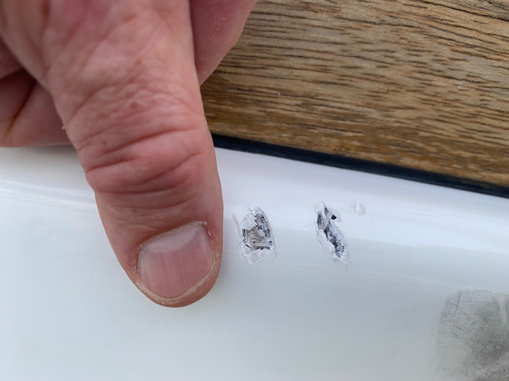

I need to repair these two gouges on my boat. They're smaller than my thumbnail but they do go just to the laminate. Does it need only gelcoat repair or is this more involved?

I have repaired similar issues using Marine Tex (white). Worked well and sands smooth. Not a perfect match but fine for a 40 year old boat and has held up for 4 seasons so far.
