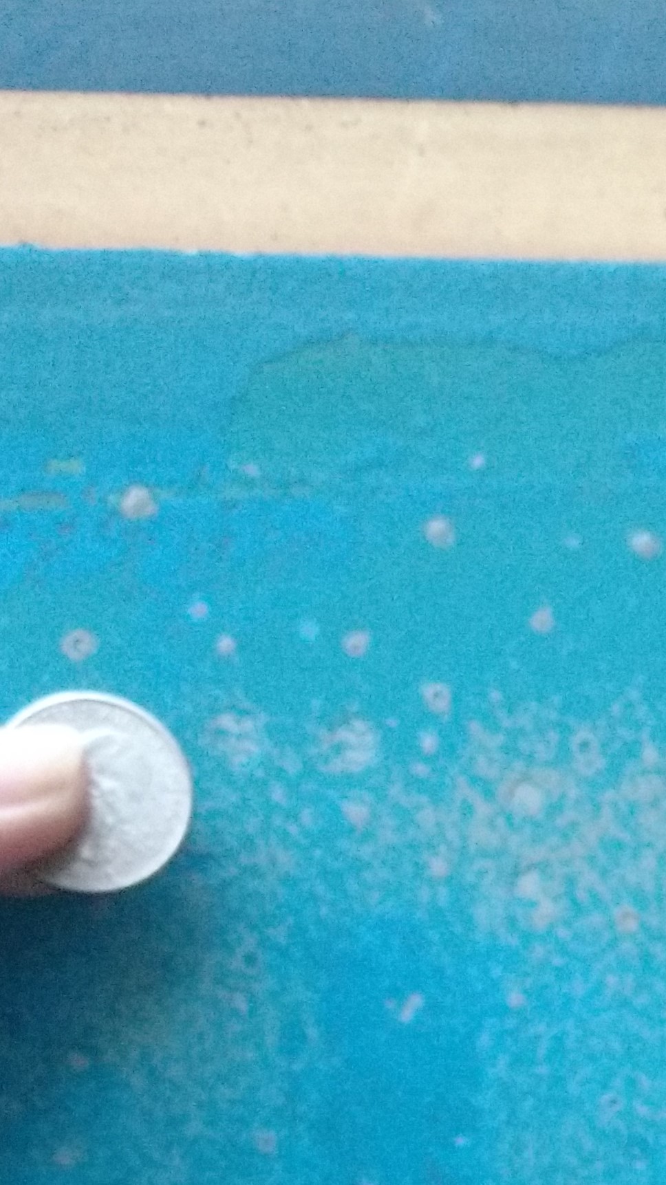

Bucket List, a 2008 Catalina 320 MK II (Hull Number 1135) has just completed the LOOP. We have now pulled her at Charlevoix, Michigan for winter storage. All was well until it was noticed numerous small (about the size of a pencil eraser (see attached photo) circular marks on the hull near the water line. The first thought was Blisters! I then read that Catalina started installing, on later model boats (1996 or so and later) a 3/16" thick layer of water impervious Vinyl ester from rub rail to rub rail.
The recommendations here at our boat service shop was to sand blast the hull, put two coats of epoxy barrier paint and then two coats of bottom paint. I would love to hear any ideas or suggestions from other Catalina owners on this topic.
