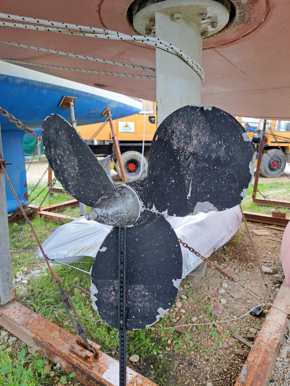

I would like to change my saildrive propeller due to some damages on the old one.

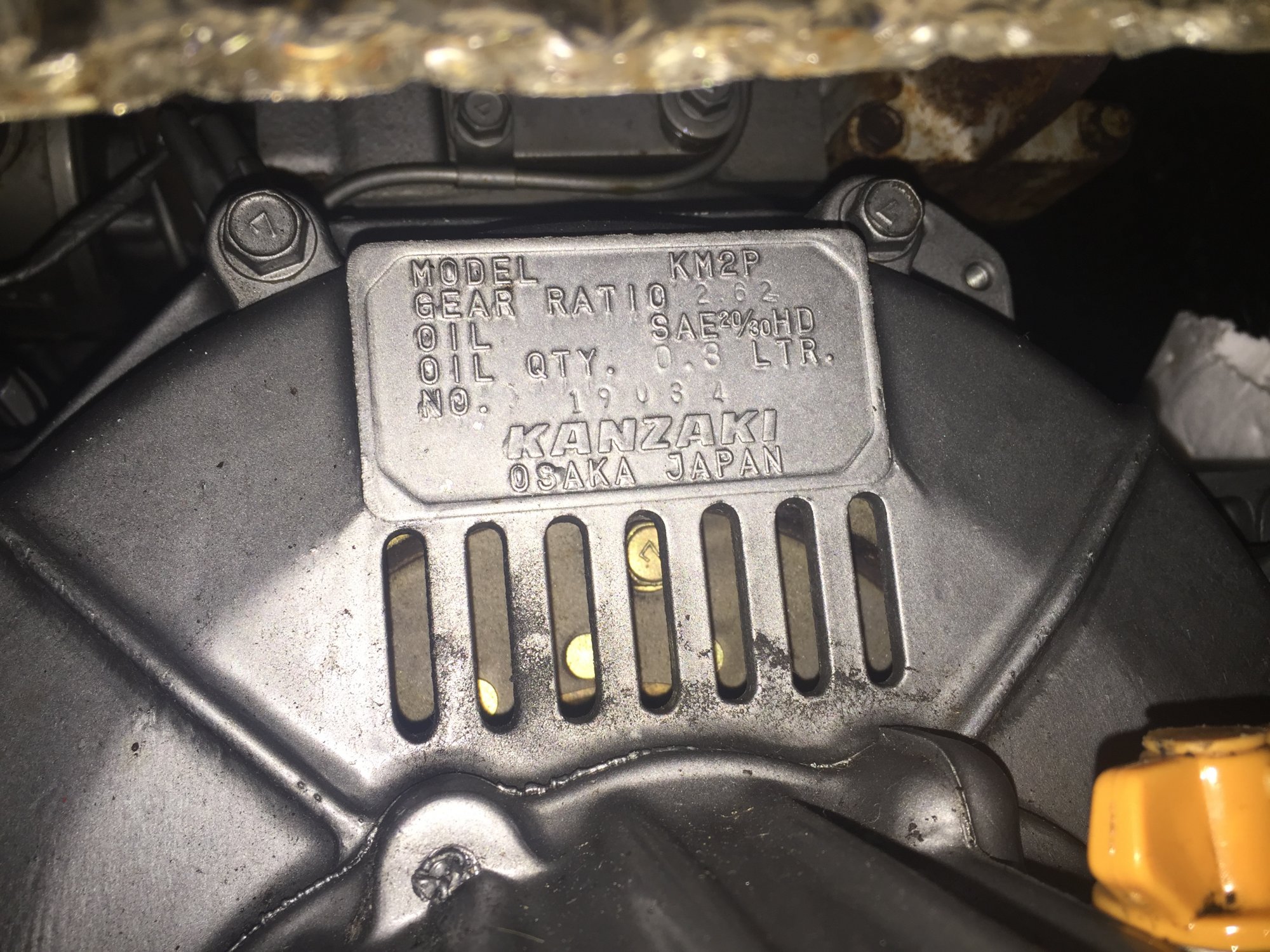

As I found with my boat, the gear ratio isn't necessarily the same on all boats even of the same model. Gear ratio of my Kanzaki is 2.21 while most other boats of same model is 2.62. Kanzaki lists both as being compatible with my engine. Maybe with a sail drive it is more consistent, but after finding that mine is different from the norm (for no apparent reason), I wouldn't trust any information other than what you find on your boat.

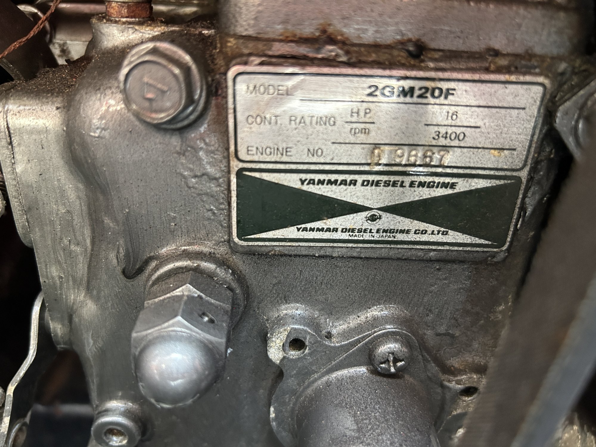

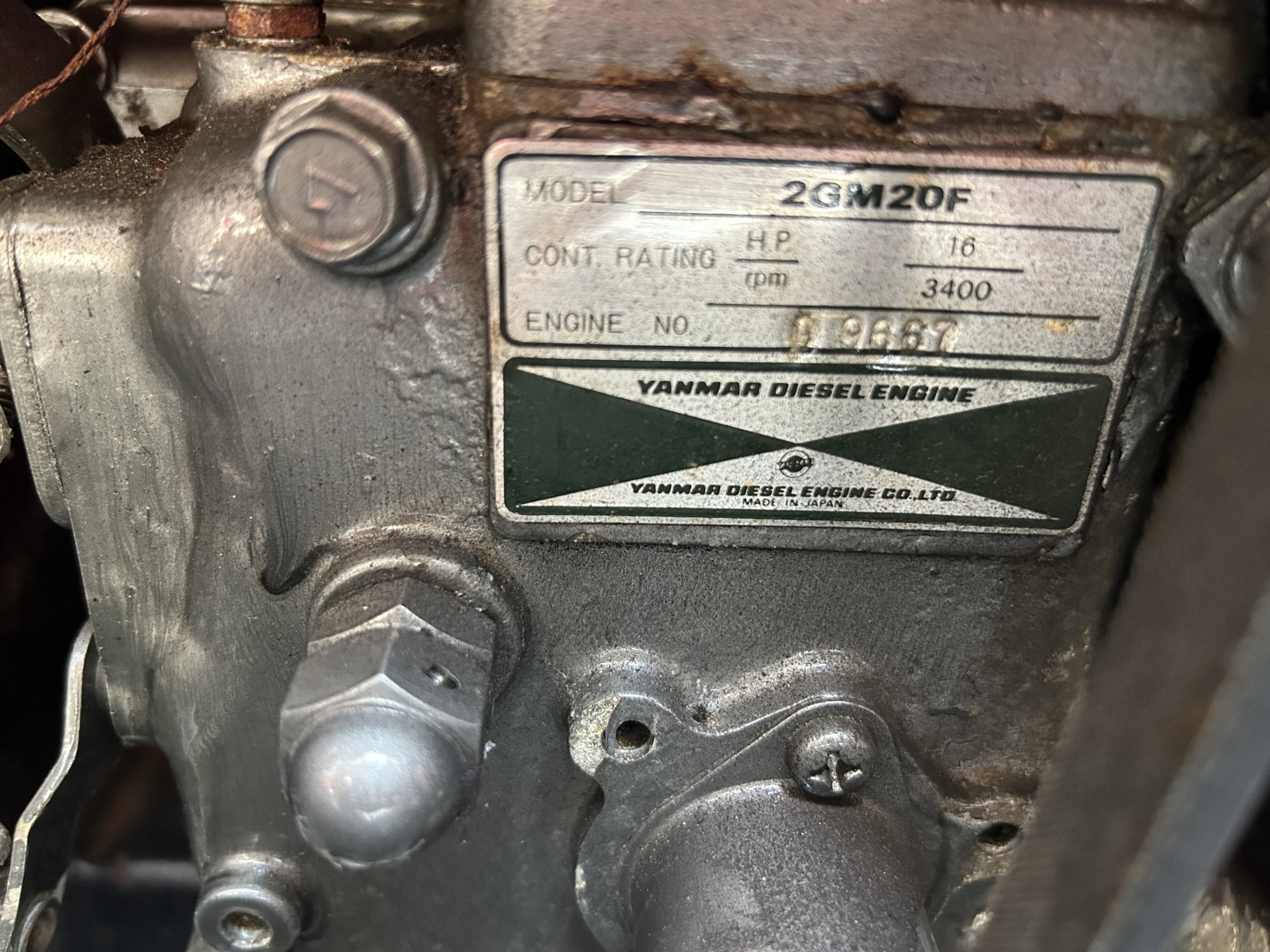

As others have said, you either need to find the documentation for your boat (it wasn’t really built in 2027…so start with getting that correct) along with engine make/model and transmission make/model/gear ratio. Engine and gear box should have badge plates on them With the information. Take a photo, and then you have it for reference..
look for something like this… from my engine and transmission.
With that information and some info about your boat (displacement, length at waterline, beam) the folks at Flex-o-fold can give you the proper options for a sail drive prop.

Good luck with your purchase. By the way…what chewed up the prop like that?
