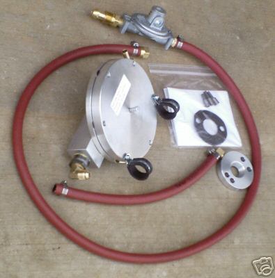

My gen is a 7kw Generac. I bought it and did the conversion imediately. My kit is similar to the first image you posted and doesn't permanently modify or replace the carb. My unit will still run on gasoline. Regarding the power drop-off, I haven't done any deatiled testing but plan to before next hurricane season. I do load test it. I back feed my main panel and kill large breakers like my central AC, electric oven, and hot tub ckts. I leave all others on and during the the test I ran 9 ceiling fans and attached lights on medium speed, 2 refrigerators, one freezer, one television, one desktop PC, one small window unit AC, all of the things that are usually just plugged in and on like alarm clocks, dsl modem, router, switch, sat receivers, etc. I monitored the voltage and 60hz frequency. To test the limits, with all of the stuff listed above, I heated a cup of water in the microwave, The voltage and freq stabilized after a couple of seconds. So I turned on the drip coffee pot and the voltage stabilized, but the frequency didn't return to 60hz. That was much more than I would run at one time.
I think, if there is a significant drop off, it's worth buying a slightly larger generator and going with the conversion. I am very, very happy with mine and have been for over two years.
