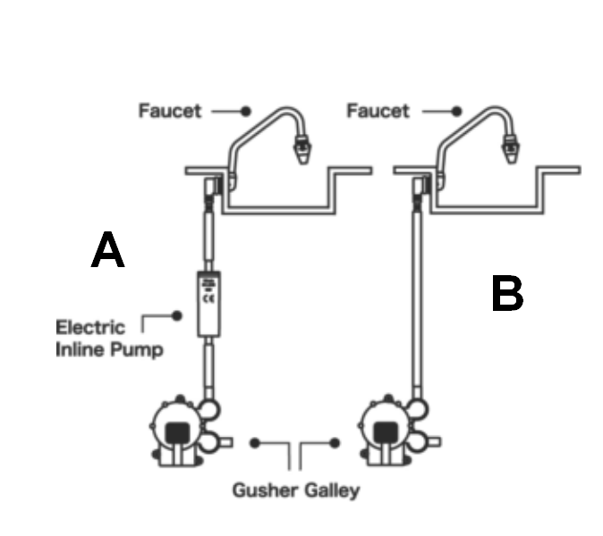

The first question that comes to mind is "how is your Whale Gusher installed ?"
"A" on the left side or "B" on the right side with additional information required ? How these two pumps are installed may lead to future problems.
Ignore the label identifying the electric pump as inline. How else could a water pump be installed ?
The installation is as pictured, with inline pump lines to the left.

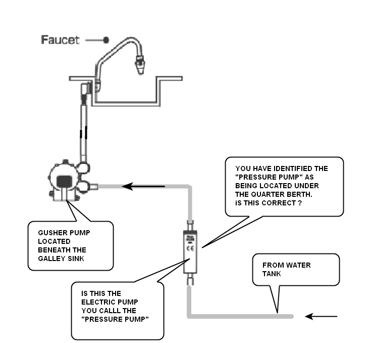

The gusher of course is beneath the galley sink, port.
But this the exact opposite of what the installation manual outlines ? Do I understand you to say the gusher is located as shown below and is fed water by the electric pump :
The system uses a simple T junction (no manifold) under the sole.
For what ? The supply ? The suction ? Do you have separate, individual suction lines for the Gusher and the electric pump ?
I've spent a lifetime dealing with petroleum refineries and other large piping systems but I'm sorry, your description has got me totally stumped as to how this thing is laid out.

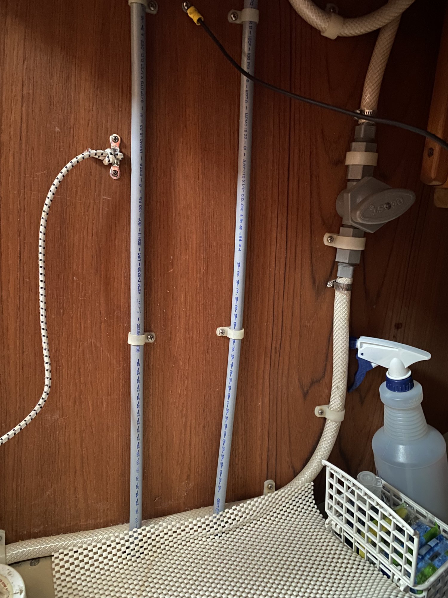

Thx for your feedback and you’re correct, the pressure lines are on the left. But the diagram seems to integrate the gusher for one faucet. I have a separate faucet for the foot pump. My pic below shows the pressure supply lines hot/cold, left. The third line on the right leads to the gusher, fed via connection to the pressure below the sole.
Pretty basic, really. And like I said, before *something* happened, it all functioned well. My job is to hunt that down.
