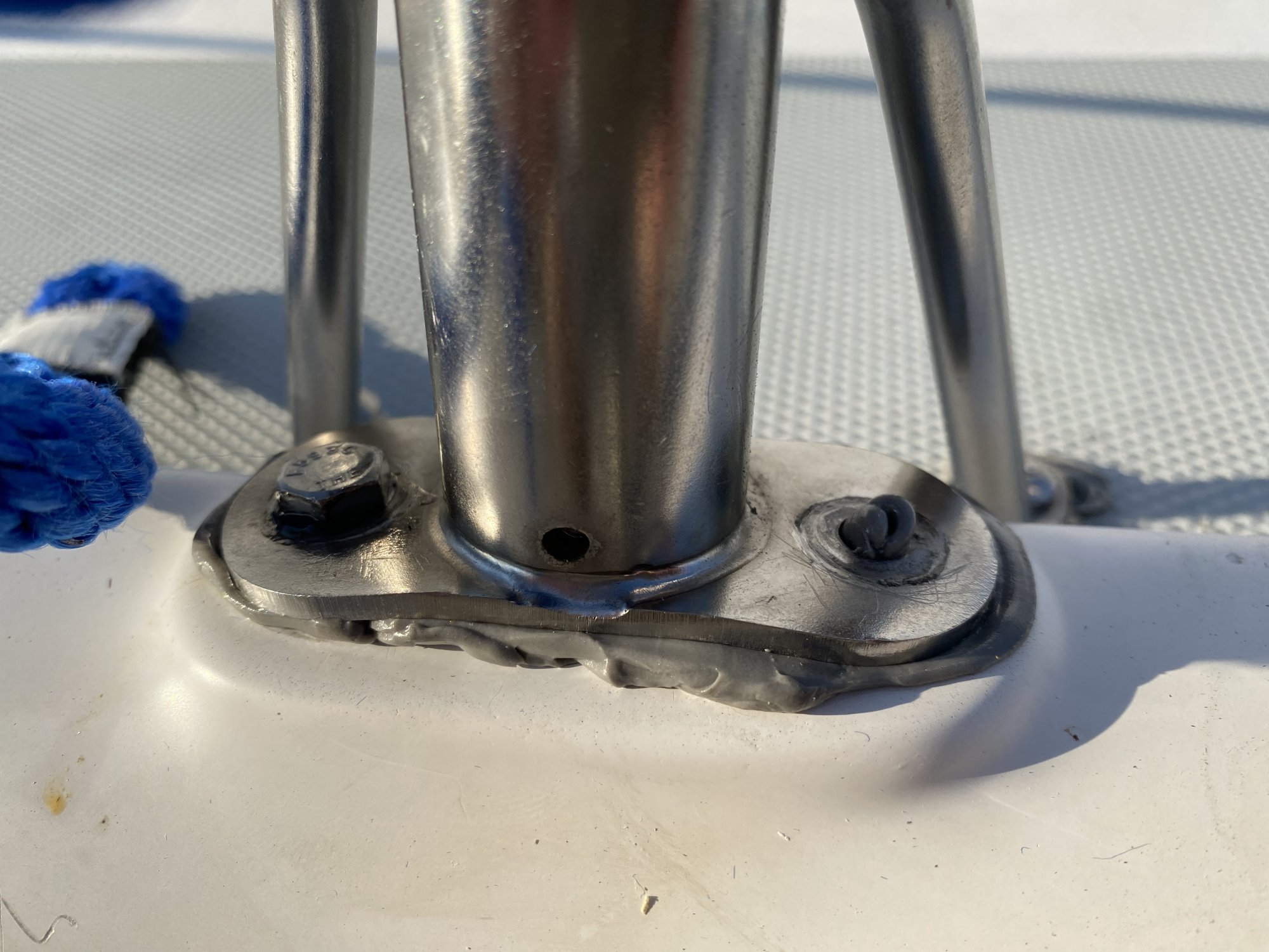

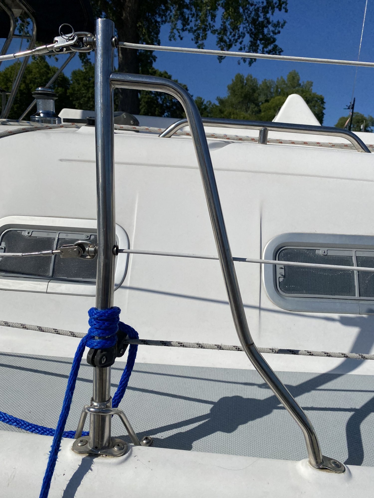

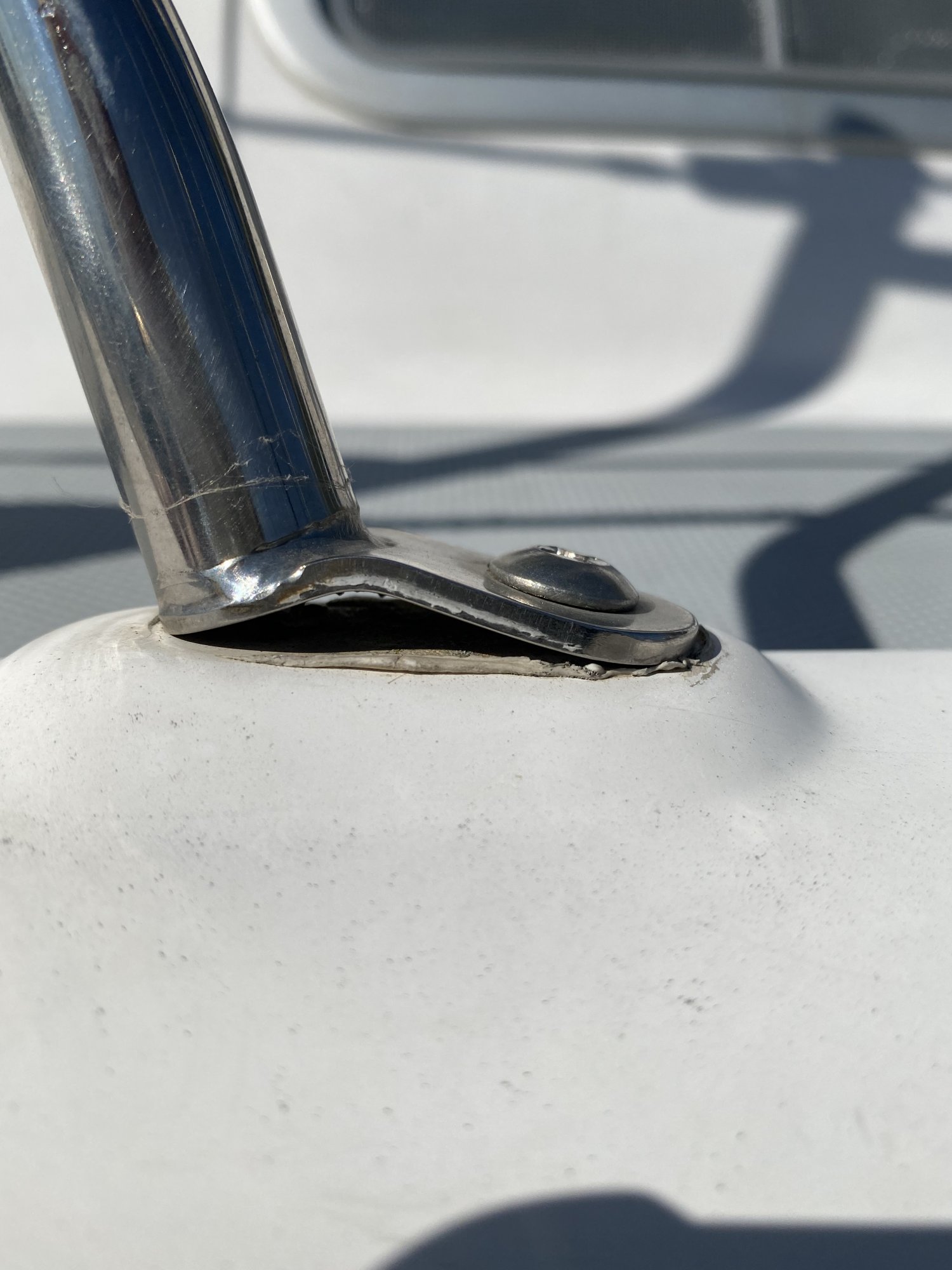

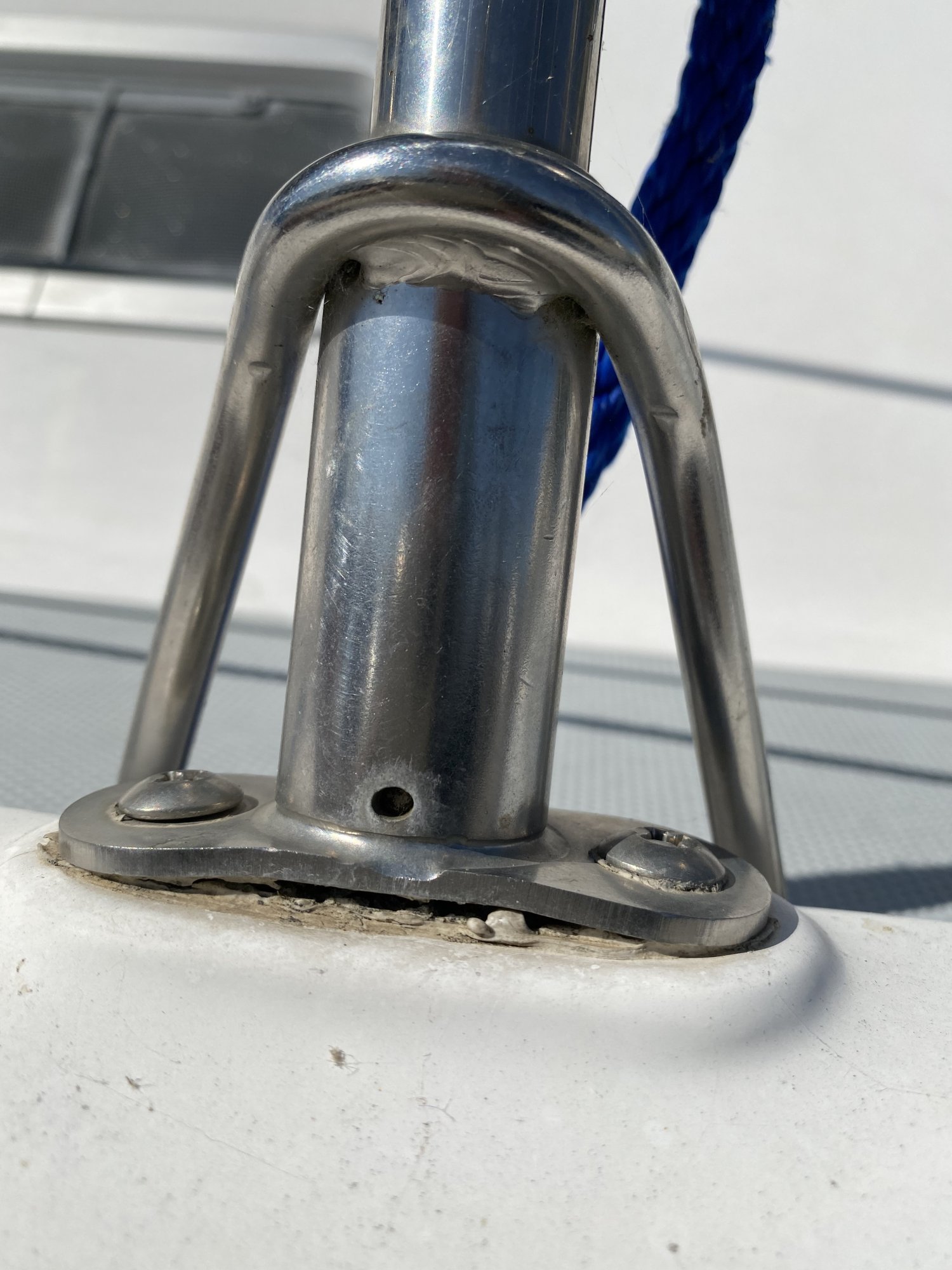

My gate stanchion was damaged and I’d like to replace it. Unfortunately, the forward base was badly bent and now seems to be galled into place and is very difficult to remove. It was able to go around about two times before stopping. The upper forward screw on the aft base was also tight. As I understand it, my Hunter had aluminum plates glassed into the hull, so there are no bolts to access underneath. Rather than risk twisting and breaking the screws, I’ve decided to pause for now and consider other options. One suggestion so far is to simply fill the gaps under the bases with 5200 and be done with it. Of course that’s not a very satisfying option. I’m wondering if a little heat, some PB Blaster and S-L-O-W motion would do the trick. Has anyone had similar successes or failures?

Looking at the picture, I suspect the damage bent the screws and they may be cross threaded in the plate.
I would try the PB Blaster idea. You said they partially turned then stopped. I would apply the PB and try to tighten them a little. This might let you work the penetrant into the threads. No guarantee but worth a try. When you patience wears out, you can always resort to drilling them out. Then, clean out the hole thread and re tap the plate for a slightly larger screw.
If the plate has been damaged then one would need to look at an alternative. Perhaps drilling a hole and putting a bolt through to a backing plate as the plan C or D.

Cut the pipes with hacksaw, remove the load from the mounting screws. That will make it easier to remove the screws.
Haro
Great idea, but I'd rather destroy the screws than the rails and bases. Those bends in the bases will still be causing a load. If you're going that destructive route, it might help to cut the bent bases. (I'd use a Dremel or grinder with cut-off wheel, and immediately pour water on the remaining cut sections to cool them - to avoid heat damage to the FRP).

Thanks for all the suggestions. I may end up doing them all! I hadn't even considered cutting away the stanchion/foot to relieve pressure from the screw. No doubt that's a large part of the problem. I want to try to avoid drilling out the screws if I can. The replacement stanchion is set to arrive this weekend, so I'm not especially worried about destroying the old one. But I want to save, flatten, and reuse the old stanchion base/bale as the replacements are $$$. So I may end up having to drill some of those out. But hopefully once the pressure is relieved I'll be able to coax the screws out with the PB Blaster/heat/impact driver combo.

don't see any cracks in the gel coat, try to preserve that if you can. I put my vote in for cutting the heads off fasteners, remove the stanchion and then you will have a stub of fastener you can grab on to to back out. You could bend the tang back straight and re-install.
The fastener is bent, and cheapest link in this chain. Trying to back out a bent fastener is an exercise in frustration, sometimes successful, sometimes not.

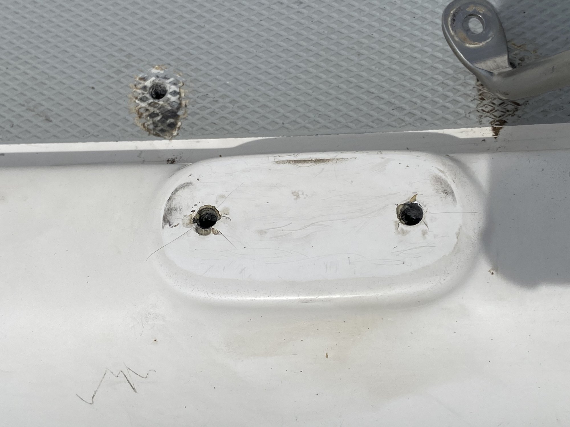

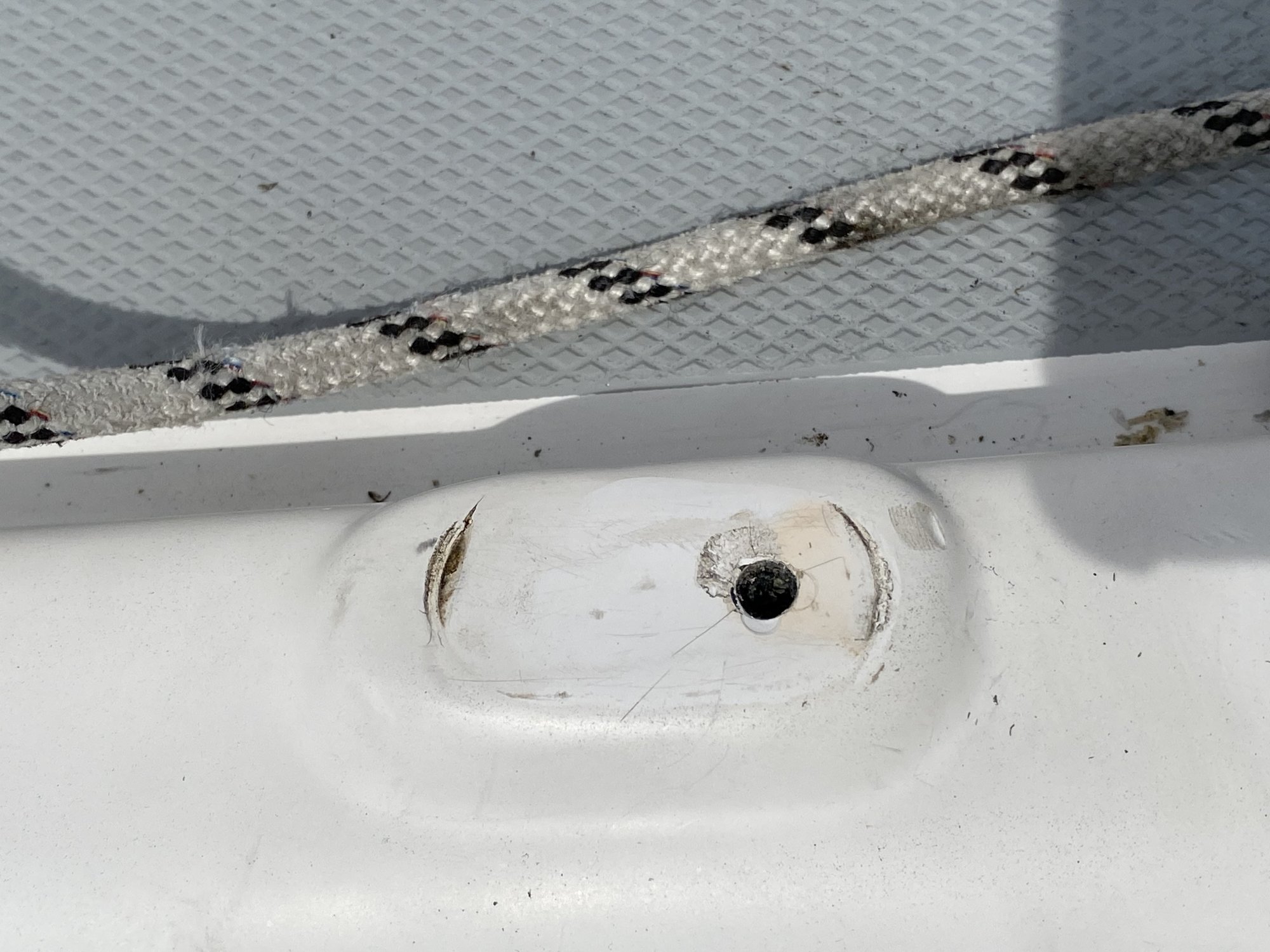

Success! After getting back to the boat I loaded up on pb blaster and decided that it made sense to try to cut off the screw head on the forward arm. It took a while but once it came off everything else just pulled off easily. Looking back it seems that there never was any galling. Instead it was the bent screw heads getting stopped by the bent bases. There did also seem to be some gelcoat damage once I got everything disassembled.
But now I’m having trouble squeezing the new stanchions into place without bending the base out of whack. Several of the screws are very difficult to drive in and some are just too hard to turn and I can’t get them tight to the deck. I had to leave one screw out altogether since it wouldn’t line up. Does anyone have any good tips on getting multi-arm stanchions into place?
