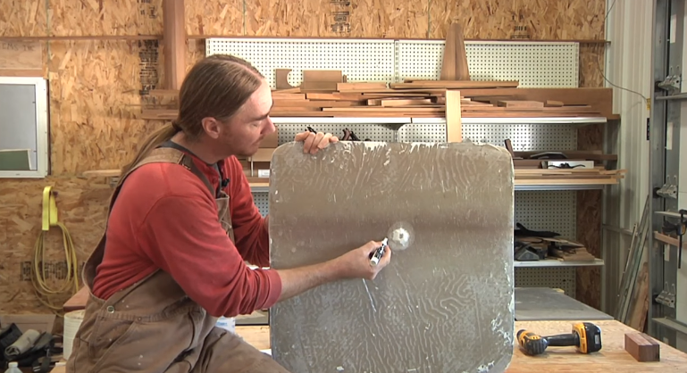

Yes. That is an option...but:
The strength of your hull to resist fracture and maintain water inegrity is in the laminate structure of the hull. Fitting a plug in the hole then covering over it with fiberglass will leave a lump on your hull surface and a weakness at the edges of the plug/hull joint.
The prefereed method is to sand a taper back from the hole edge and then rebuild the hull by layering fiberglass circles of gradually larger diameter onto the hole repair.
Here is a 3 part video by Andy of BoatworksToday demonstrating the process.
Good luck
