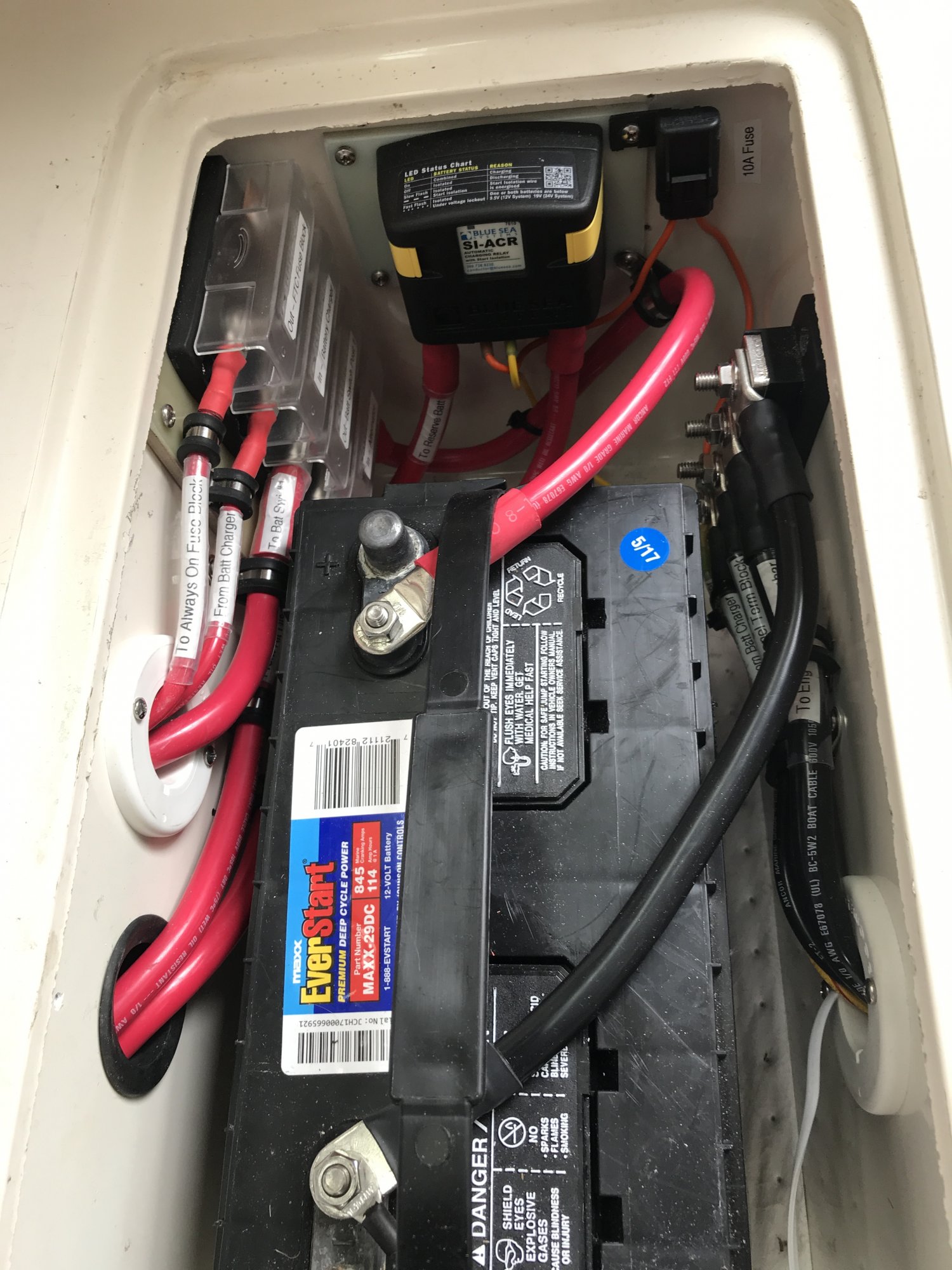

I did something very similar as @dlochner. Lined up some ANL holders and connected them with a copper bar custom drilled.

I borrowed the copper busbar idea from MaineSail. Somewhere on his site or in his forum there was a photo of one similar to mine. I asked him about the size.
If the battery cable and the Inverter cable are on the same fuse holder you'll be fine because it is a direct connections. This is why Power Studs are not rated. On my bus bar the battery cable connects at the right end and the main feed to the panel and windlass are on the right side. The cables are then arranged in order of current draw, the highest draw closest to the main feed, the lowest draw to the far left (feed to ACR and start battery).

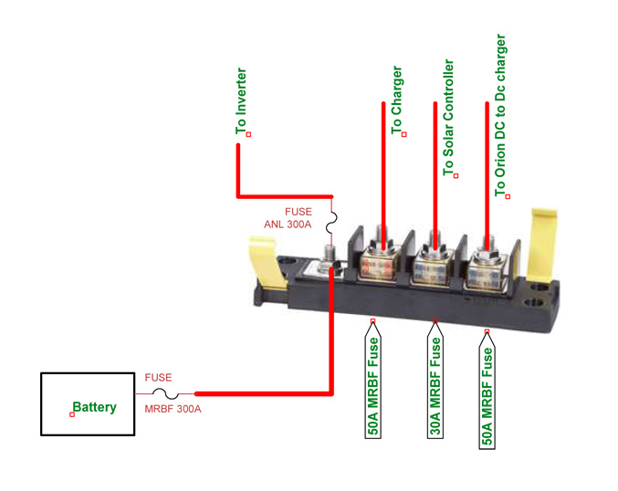

If I can connect the Inverter to the MRBF common terminal with an ANL fuse (see attached drawing) then the MRBF bus would probably be the easiest solution. I would put the ANL fuse between a blue sea power post connector and the busbar common terminal. The MRBF busbar is rated for 300A total and max 240A per terminal. If, as @dlochner says, the Inverter and battery are on the same terminal the 300A should not affect the bus as it is a direct connection. Any thoughts?

Two thoughts. First the ANL fuses are pretty fragile as such they need to be protected from errant things. The ends of the fuse are 2 thin metal strips that are easily bent and they are exposed, a cover is needed, not sure how you would do that.
Second, it would be better to put the solar cable at the end of the bus bar rather than the middle.

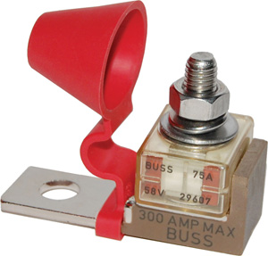

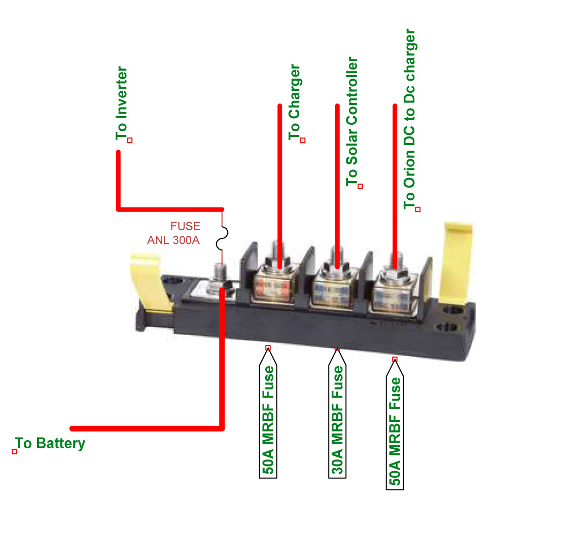

Perhaps the best thing would be to replace the ANL fuse with an MRBF fuse block (see photo) attached to the busbar’s common terminal.
A second idea might be to leave the Inverter unfused at the busbar and rely on the 300A MRBF at the battery terminal.
Also, I agree that the Solar cable should be moved to the end.
Anyone have a link to Maine’s article? I looked for it but couldn’t find it
Thanks
Tim

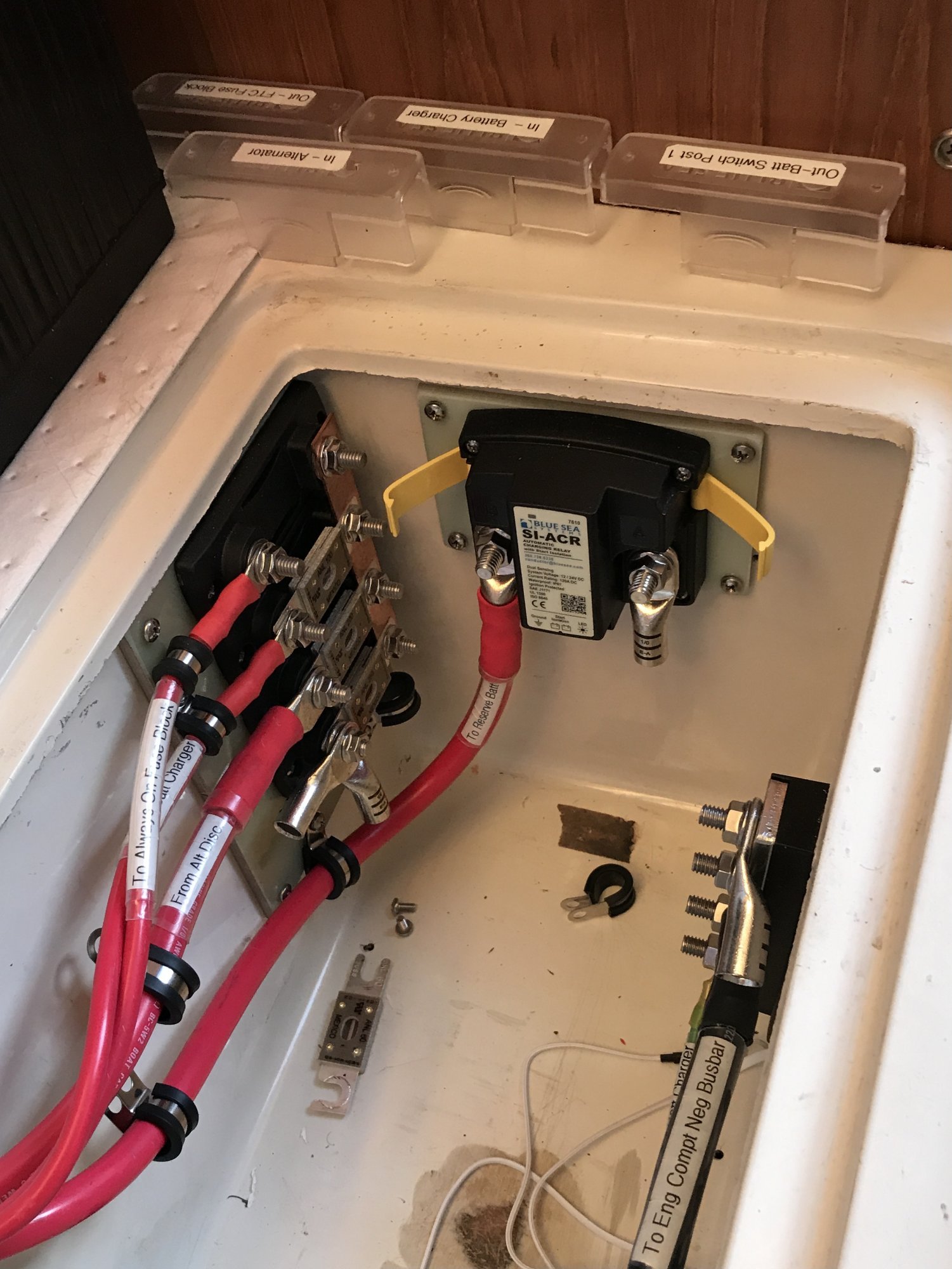

That MRBF Fuse Block you show was advertised but not out yet when I was putting my system together. I could have put MRBF Terminal bars and fuses on a bus bar but that would have cost more than the ANL setup. It would also have moved the cables away from the side of the battery box. Using ANL fuse blocks kept the cables nice and close to the side wall saving some space to allow the room for the two GC-2 6v batteries I installed.
Here's another photo taken as I was putting the system together. I bought the copper bar from McMaster Carr and drilled the holes where they were needed.

"Perhaps the best thing would be to replace the ANL fuse with an MRBF fuse block (see photo) attached to the busbar’s common terminal.
A second idea might be to leave the Inverter unfused at the busbar and rely on the 300A MRBF at the battery terminal."
The MRBF Terminal block is designed to fit on the 3/8" stud of your battery. The studs on the MRBF Fuse Block are 5/16". While you could put a washer under the nut, I'm not sure I would want the looser fit of the terminal block on the smaller stud.
I think your second idea is a good one and meets fusing requirements.

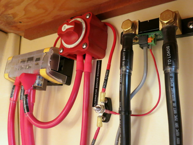

1- Inverters should use Class T fuses.
2- MRBF fuse holders and fuses can be direct mounted to a heavy duty busbar. Don't forget to cover the busbar. One reason we don't sell the double MRBF holders and the

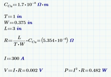

You asked is there formula for the size of the busbar and there is... sort of. The concerns are voltage drop and heat. The good news is copper is very conductive so the size limitations tend to be more practical than electrical. Here is an example showing a 1" x 3/8" x 3" long busbar with a 300 A load. I know I'm mixing units in this example but I'm using Mathcad which sorts all that out in the background.
The voltage drop is minimal and the power dissipation is fairly low so won't be a thermal issue since copper is also a very good thermal conductor. Both voltage drop and power are proportional to resistance which is inversely proportional to the cross section area so doubling the thickness will half the power or voltage drop. Conversely, doubling the length will double the voltage drop and power dissipation.
If you are going to drill and tap into the copper, I'd go with at least 3/8" thick to accommodate the screw threads.

First wire closest to hull (from battery bank and fused at bank with Class T)
Second wire from bulkhead (to house bank battery switch) protected by fuse at the bank as the wire is the same size
Third wire to inverter ON/OFF switch and also protected by the main banks Class T fuse.
MRBF is for the alternator and is a smaller gauge so needed a lower amperage fuse.
Voltage Sense fuse is above the alternator service disconnect switch
