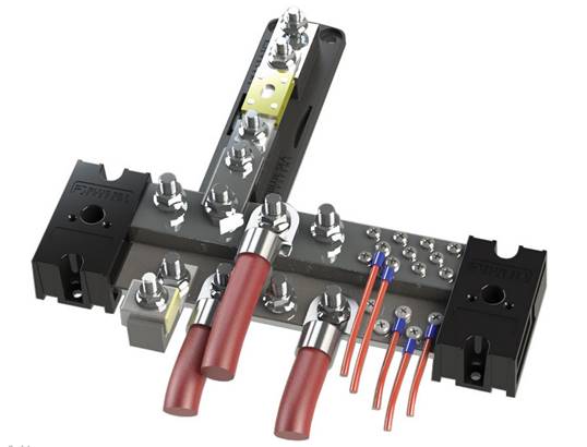

Maine Sail... I can't quite be sure what Blue Sea items you are using in the LH side of your photo. Can you please provide a little more detail?
Thanks!
Nov 16, 2012
1,055
Catalina 310, 2000, #31 31 Santa Cruz
Thanks!
I'm pretty sure Maine Sail's picture shows a 5191 bolted to a MaxiBus bar (with cover). I got this picture from Blue Sea tech support. It shows their new Power Bar 1000 with a 5191 MRBF mounted on the bottom bar, and a 9160 link connected to an ANL fuse holder on the top bar.
So it looks like I could do it either way pretty easily. The MRBF ends up being a little cheaper, but needs more vertical space. The ANL has a higher max amp fuse.
