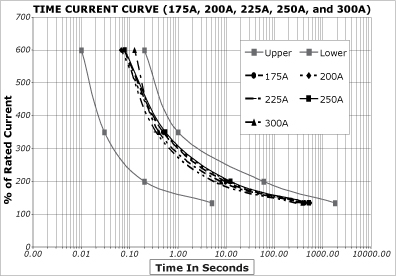

** Really it's current + time. But we don't really care that much because the wire that's being protected also has a time factor before it bursts into flame, and that time should be greater than the fuse if the wire and fuse was sized correctly. Example, how a Blue Seas MBRF fuse reacts to current over time:
So, for minor overcurrent situations, it could take quite awhile to pop this fuse.
This is why MBRF's and other large fuses are perfectly acceptable to be used on batteries that provide starting power to boat engines. (There's a MaineSail article on this)
