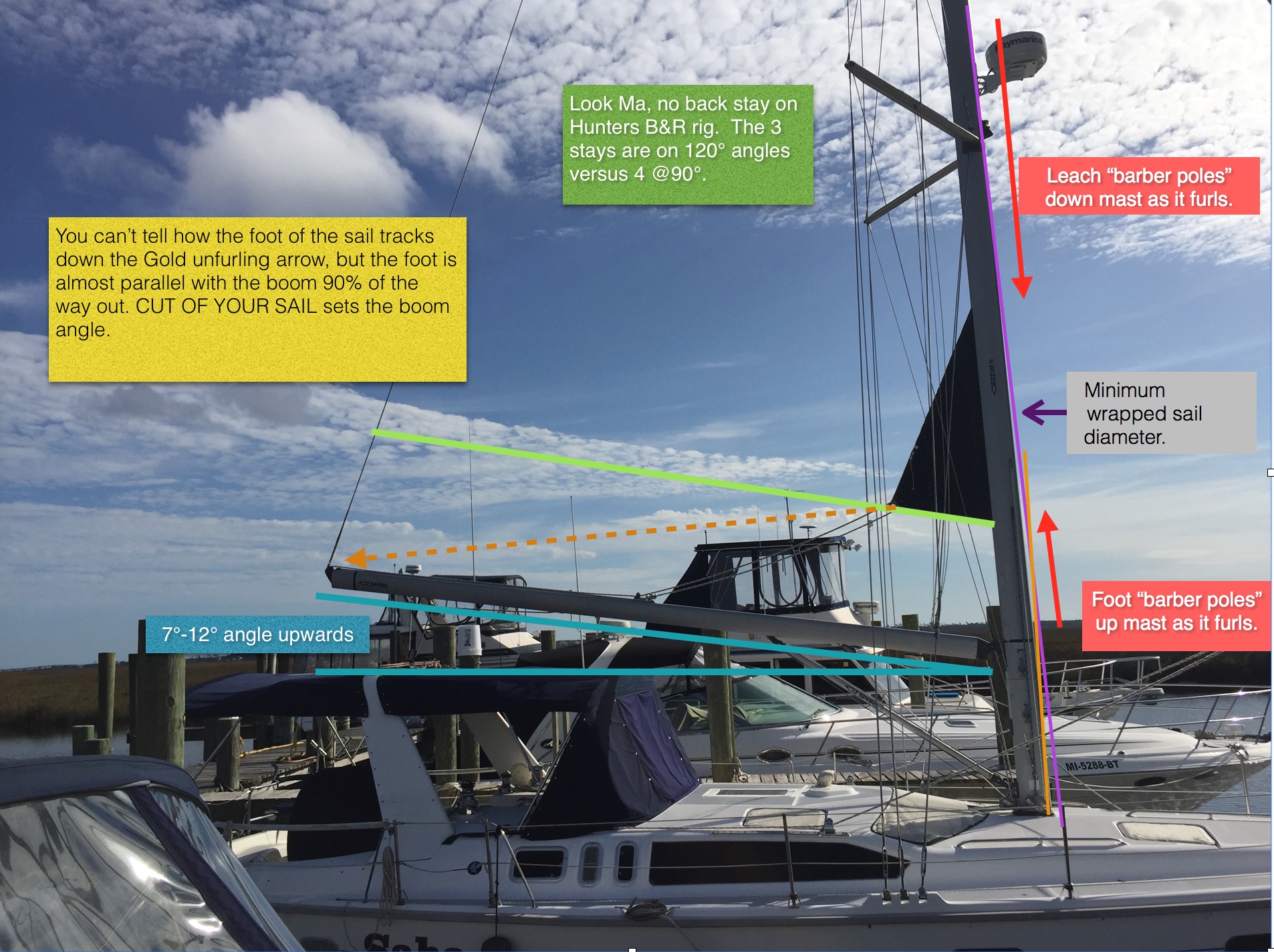

Mine has pre-bend and works fine,
Carefully look at all lines on this picture.
The purple and orange lines on the bow side of my mast, show you the pre-bend. Where they intersect is maximum or where it is needed.
Jim...
PS: I can help anyone on in mast-furling, I am expert now.
