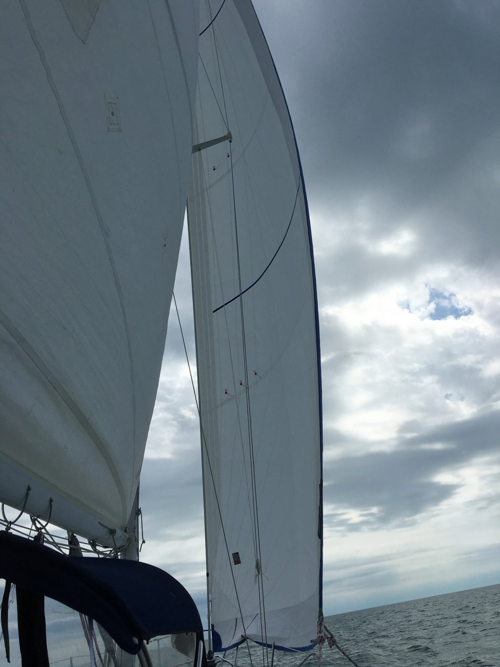

Take a close look at your head sail. A lot of sail makers put marks on the sail at common points, like 135% and 110%. It may be just a round dot or a stripe. There are red vertical stripes on the foot of my headsail that show common reefing points. The tell tales are located above them.
While the stripes are there for guidance, the sail can be reefed in between the marks. The marks are just a reference point.
Edit: If I had towable genoa cars the upper and lower tell tales would be flowing evenly. The cars need to come back a bit. :waycool:
