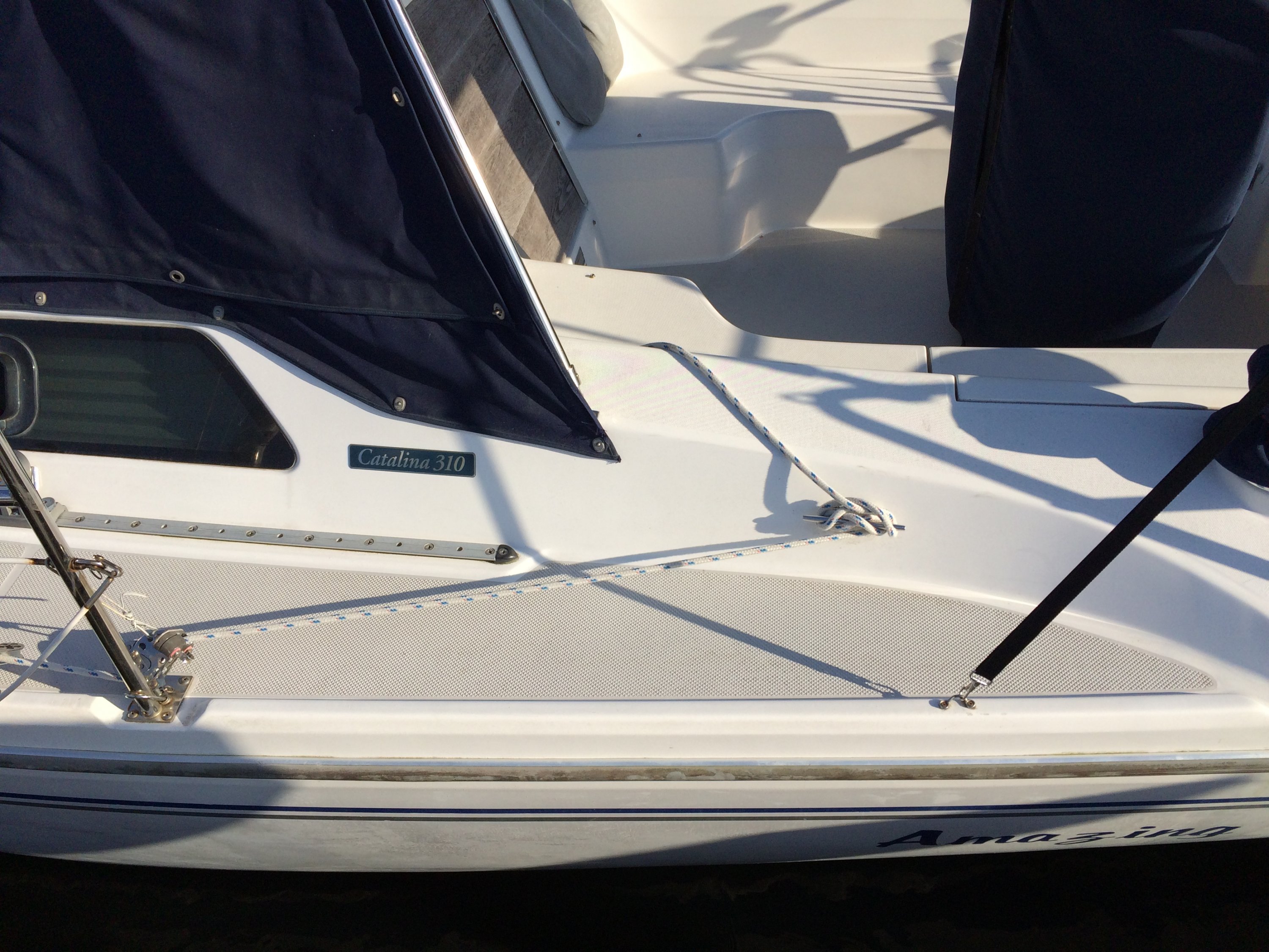

Picture of cam cleat and horn cleat for furling line on port side of my C-310
That's attached on the gate, rather than the pulpit. A little farther from the wheel, but still convenient. I think I'll get the hardware, try it in both places, and see which we prefer. Thanks!!

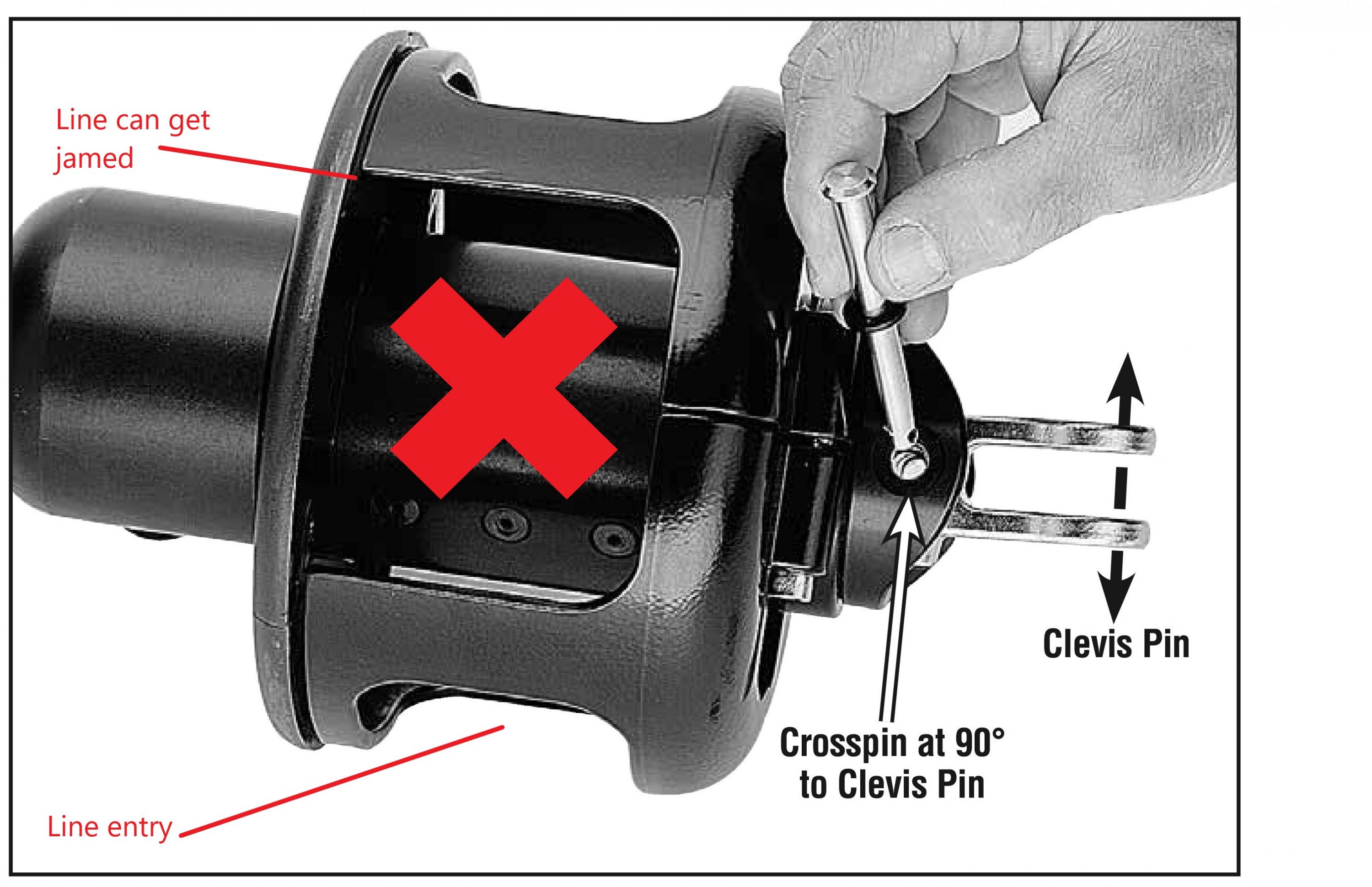

Ward... Most furlers have a specific entry point for the line. Even though the furler drum has multiple openings, if the line is led through the wrong one the line can ride over the opening and bind between the frame and the furler drum...
Here is an example of the Harken MKIV Unit 1 drum.
Harken let gives you two captured sides to have the line enter.
