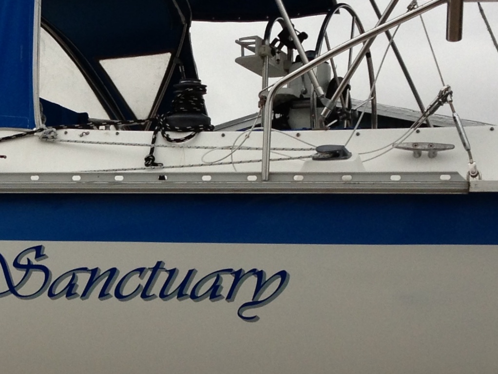

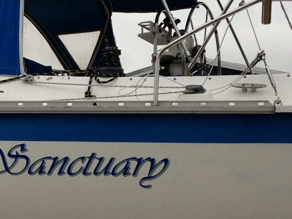

It’s a different boat but here is my set up.
HMT2
Mar 20, 2014
900
Hunter 31 828 Shoreacres, TX
No sir. It’s not tight when the sail is furled so getting off and on is no problem. It runs along fair leads outside the stancions. Sorry my picture wasn’t better I was at an airport. Normally I would edit it with labels.

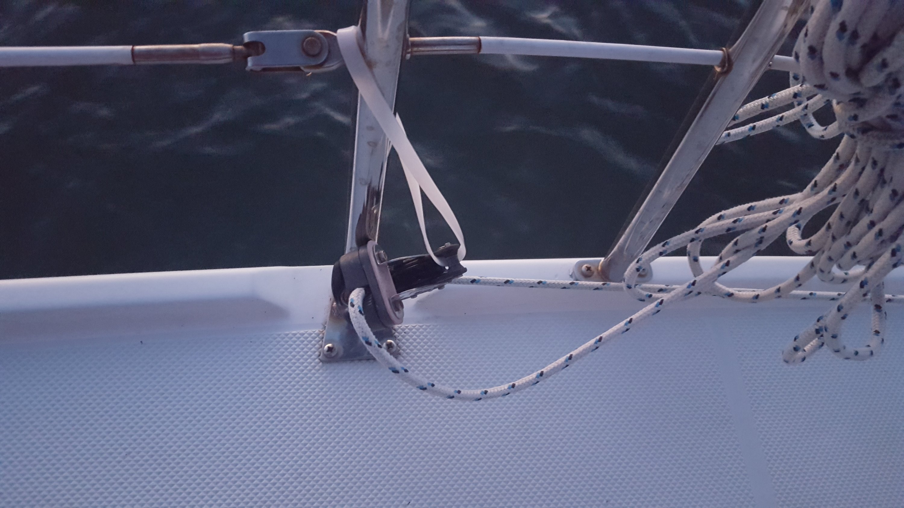

We got some good advice and added this cam cleat as in the attached. Used to be secured with an elastic line to the lifeline but we recently changed to a large zip tie which works better and will last longer. The hardware was expensive but worth it. If you want a better picture in daylight just let me know.

The cleat will still function without the zip tie as it is attached to the stanchion base with a shackle. Zip tie just holds it upright making it easier to operate...

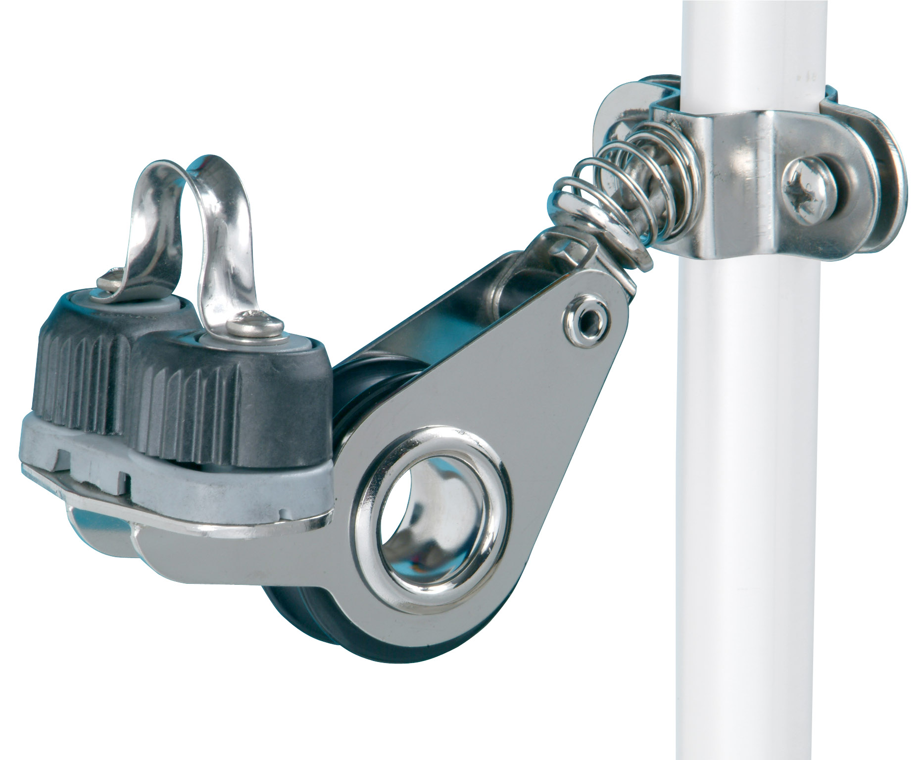

Sigh! Allow me to school you all. You are over thinking this. What you want is a Garhauer Stanchion Blocks SB-25C - Stainless Steel Blocks, length: 3-1/2, width: 2-5/8, weight: 11 oz shackle: sheave diameter: 1-3/4, 25 series block with swivels 360 degrees. Comes with cam cleat, $65.00
Go to https://garhauermarine.com/catalog_process.cfm?cid=57 and click on the Stanchion Block link.
Love it as it is simple and effective and at least works in winds up to 35 kts. You are welcome PaulJ!!! :stir:
