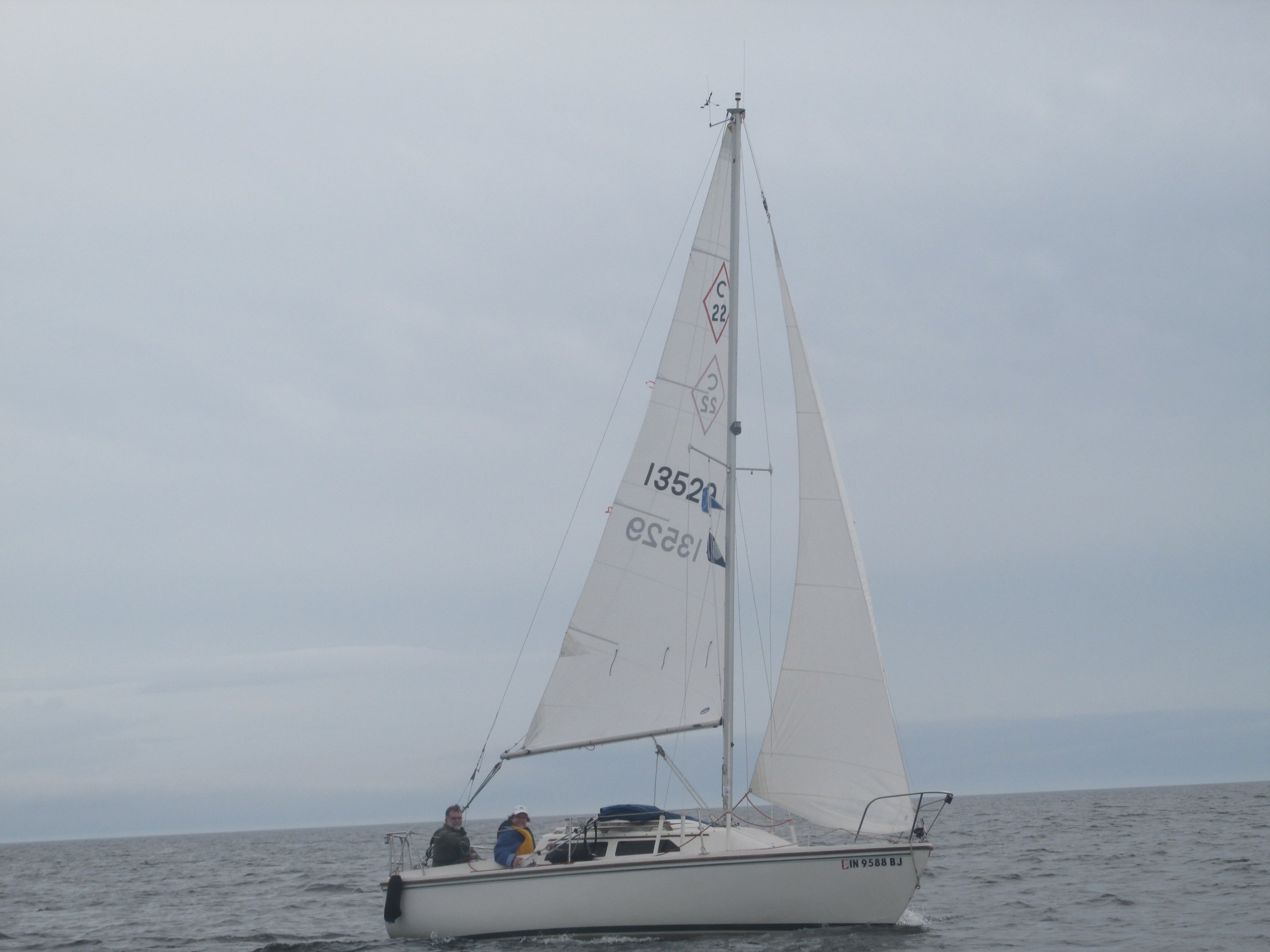

So last winter I too was thinking about adding a furler to my '86 C22... and was intrigued by the Harken furler option described by Capn'n Don on this site and in the March Mainbrace. Shortly after, almost as if by fate, I came across a Harken 436 furler on ebay at a price too good to pass up... and it pushed me over the edge. In the spring I was able to follow Don's instructions... including installing a Wichard U-bolt to replace the bolts at the back of the bow stem fitting and adding two fairleads and a stanchion mounted cleat for the furler line. I also had a local sailmaker remove the hanks from my jib (a standard 110 jib) and install a cable and eyes to the luff. When installing the cable, the sailmaker (who had experience using a similar setup) recommended installing two wires in the luff to make it furl better. In total the project set me back just over $400.
The furler has been a great addition... I really like the flexibility and ease of use it provides. It would be nice to be able to reef on the fly but I have a storm jib that I can still hank on when needed... as well as a 135 for when the winds are light... though I haven't used either this season. Included are some pix of our setup. Since these were taken I've added the quick release lever for the forestay... which I like a lot too.
