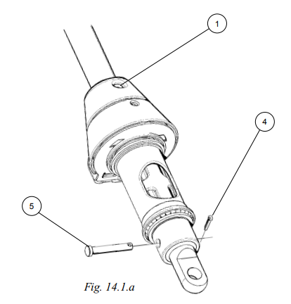

Feb 21, 2013
4,638
Hunter 46 Point Richmond, CA
I had a similar problem on the furlex on my Hunter 386 and discovered a screw had backed out so had to source a new torex head screw through a Selden dealer. In case you do not have the manual I am attaching for reference. Good luck!!
