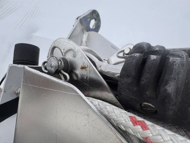

This is the only picture I have, it was taken before I undertook the whole furler task this spring,
Basically a thick pin goes through the masthead’s fitting and through the eye on the top of the forestay.
It is a furlex type B mark11.
I simply need to add room from the pin to the black top cap of the furler.

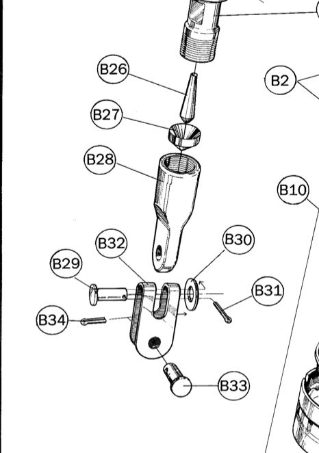

what if you were able to ass the length to the base?
part B32 is the “Toggle Fork Fork”.
If is was 2” longer that would lengthen the forestay by 2”. It only connects the forestay to the boat does not affect the furler length. If the furler is long enough for your sail and the upper swivel is at the proper position/angle to the mast, then is seems like the easiest and best part to extend to get the length of forestay you want.

The issue is that the black end cap on top is preventing the forestay from attaching itself to the mast head, that is why I NEED to add something to the top part

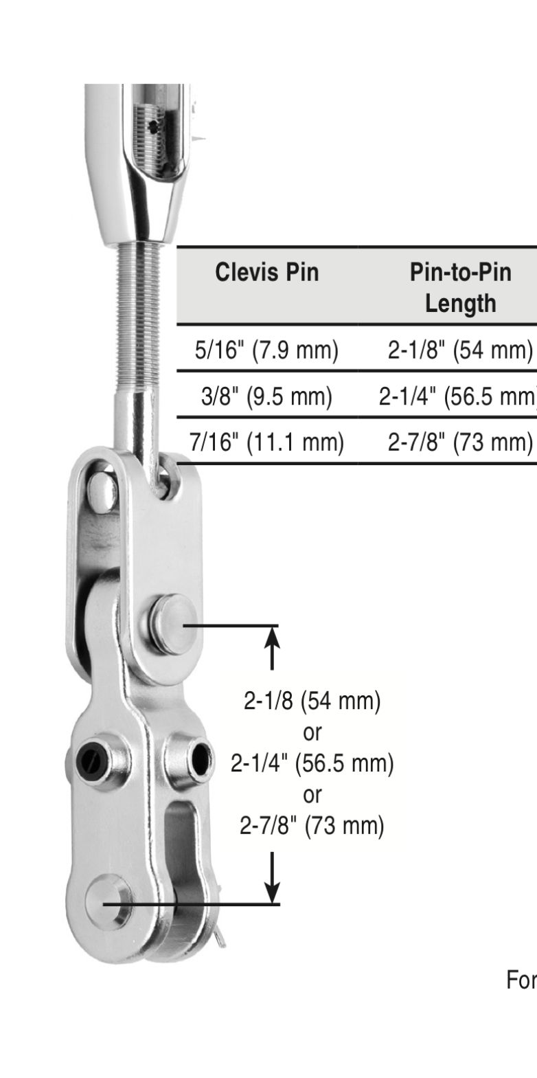

Ok, Quick update,
Did have time to go look for parts before work today, did find a rigging shackle (not sure of the exact term for this one) it has holes to pass the original pin on top and an extra pin to hold the furler, it is about 1.5” long, exactly the size I need, I was looking for a fork to eye shackle, but they did not have any in stock, so either wait a week or more or get the expensive one, needless to say it is waiting to be installed on the boat.
I booked the masting crane for Saturday morning, then we should be good to install the sails and go have fun
Aug 17, 2013
1,339
Pearson P30 202 Ottawa
All is resolved, we got a nice ($$$$$) rigging shackle to intall between the masthead and furler, everything is as it should now
