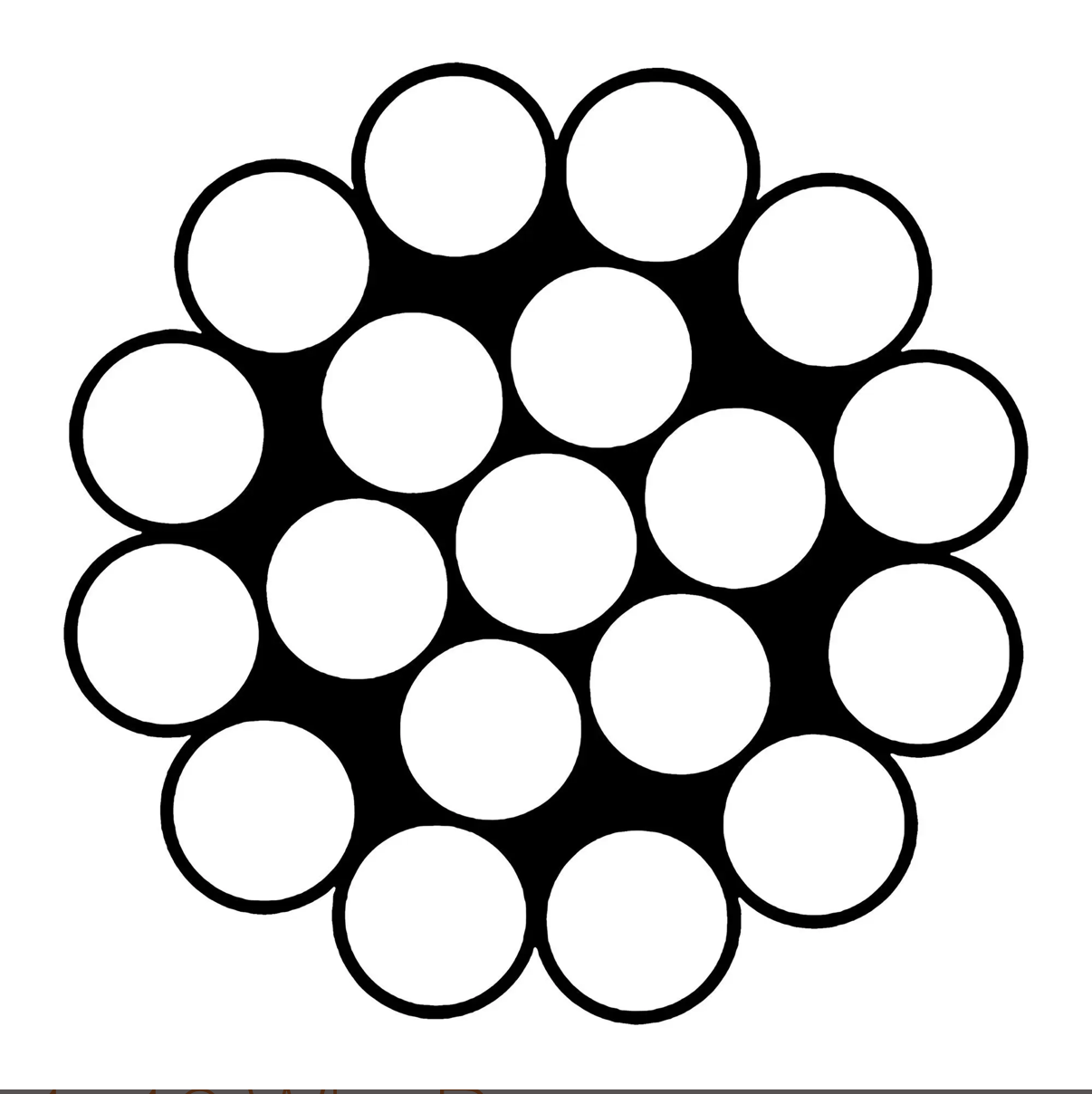

Managed to reinstall the stay and assemble the fittings, all except the cone for the Sta-lock, for the life of me, I simply cannot figure out that part :banghead:
How many strands are supposed to go through the cone? If it is the whole core then my chandlery had the wrong cone in the right baggies :banghead:
As soon as I figure that one out I can proceed to successfully masting.
24,745
What type of wire rope are you using? I have 1x19 wire rope.
The core has 7 strands which fit in the center of the cone snd 12 that slip over the outside.
24,745
StaLoc says all 7; this is the core of the wirerope. The other 12 wrap around the outside of the cone evenly.
