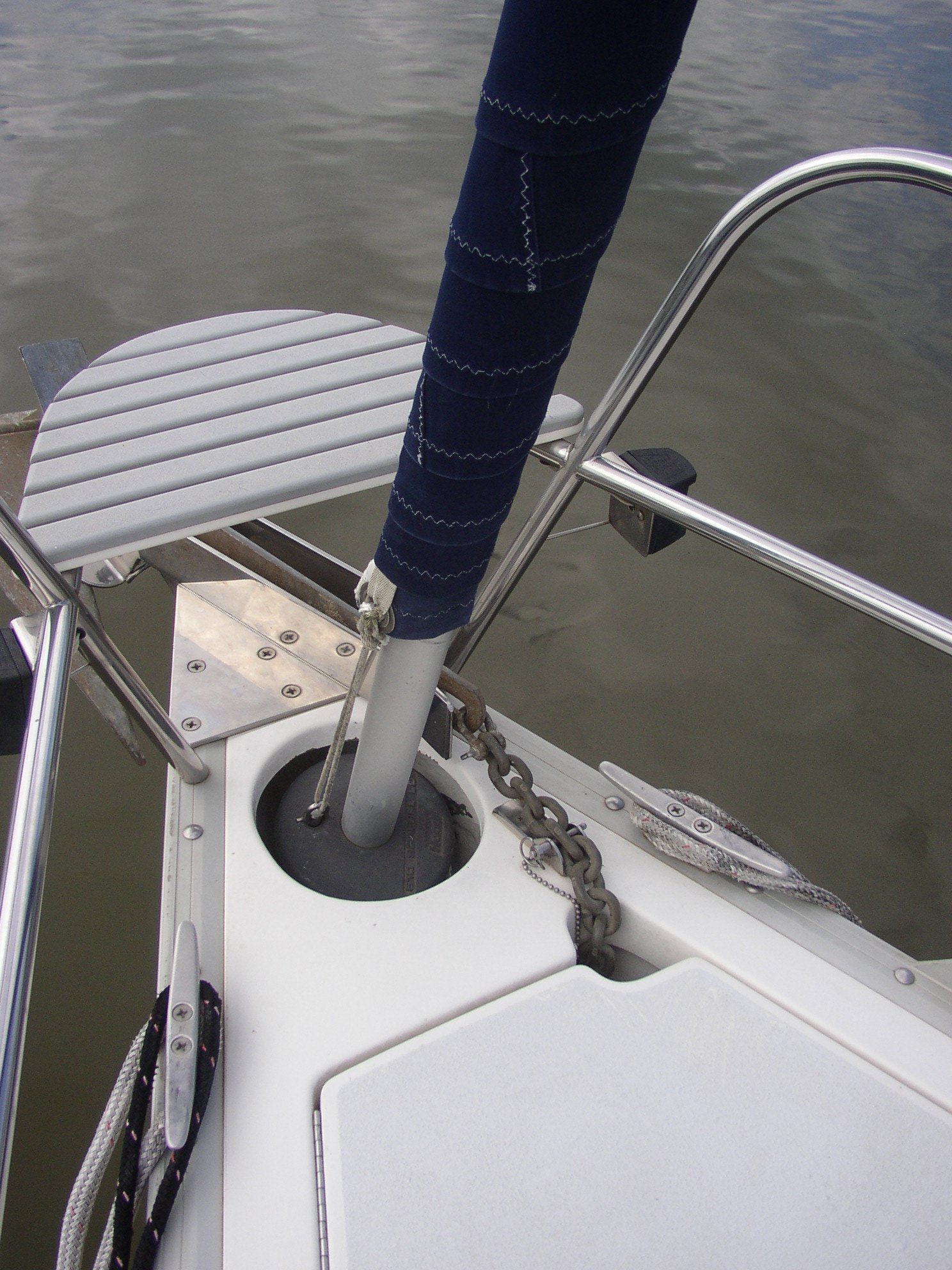

I still use my Hood 810 below deck furler on my 30T. I'm having a lot of trouble with wasps (not mud daubers) building nests inside the anchor locker. The large round hole in the deck for the furler is a major passageway for the wasps. Has anyone come up with a clever way to close up this hole? It would be nice to be able to leave one on full time, but I'm okay with removing before sailing. Is foam my only option?
