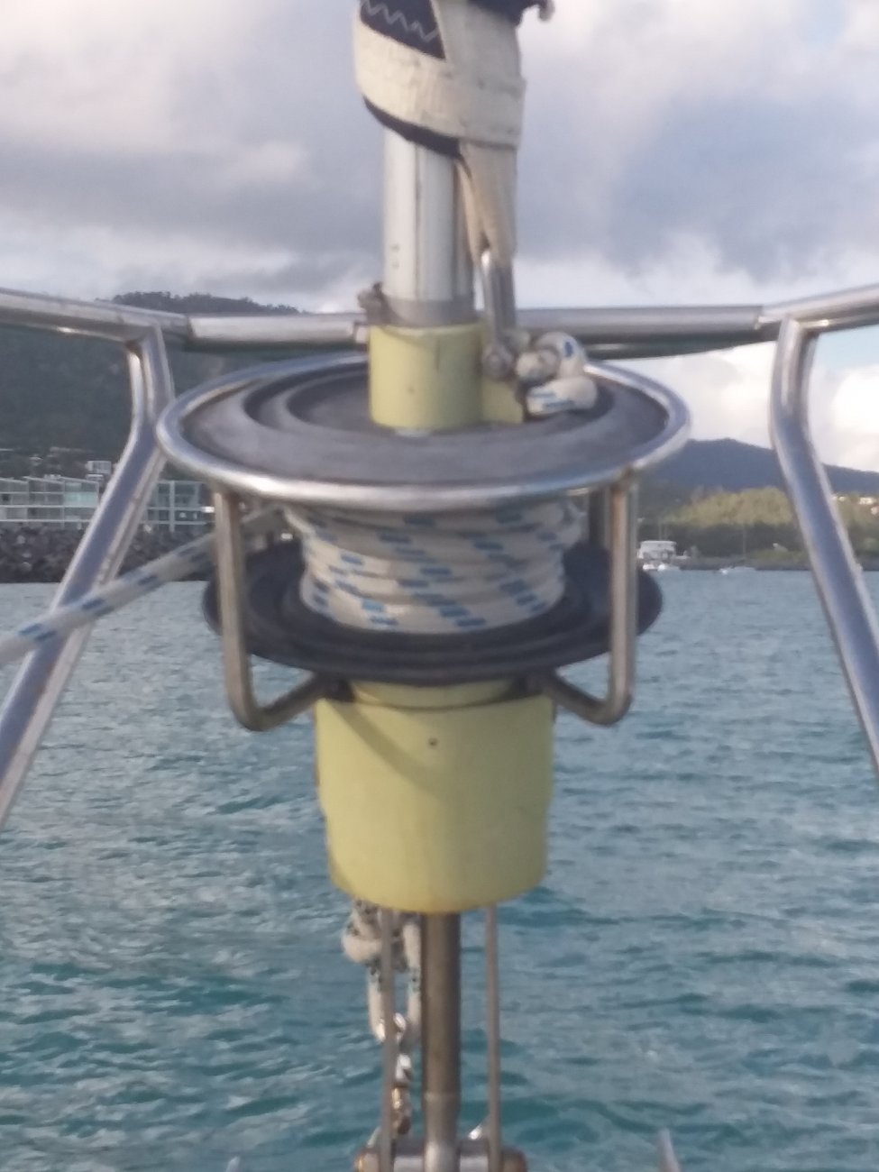

Is it possible to replace the bearings on the furler drum? Not sure what brand the furler is so have attached a photo.
Thank you.
24,696
That has the look of a ProFurl furler. If that is correct, it has a sealed bearing. The bearings are steel ball bearings and at a machine shop you might be able to open the housing, replace the bearings and reseal the housing. I had this discussion with my rigger 2 years ago. The ProFurl suffers from the housing leaks the bearings wear and not serviceable construction. You can reach out to ProFurl for new bearings, but they are quite expensive.

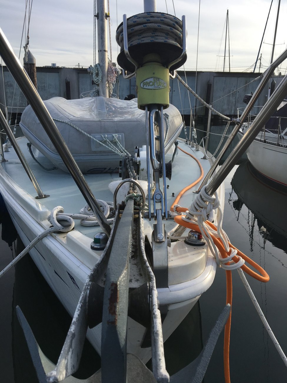

This look similar?
SG
Feb 11, 2017
1,670
J/Boat J/160 Annapolis
The bearings is the vulnerability of ProFurl furlers. ;^)))) They're "Great" until they aren't :^))).
If you search, there are some videos on the web that suggest a way to get replacements. The issue is the "sealed in lubricant problem of getting the "genies' out and back in the bottle.
