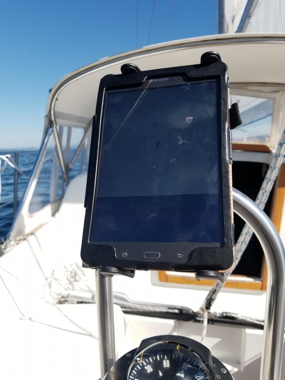

Take a look at a Samsung tab active 2. Ip68 certified. All ports are ruggedized so it’s water resistant even in its charging mount. The tablet itself can do 30 minutes at 5 feet deep and be ok. Ram makes all the mounts you could ever need. Can take higher temps than an iPad (it will shut down on a hot day in direct sun after a couple hours). Works all day if it has partial shade. Navionics works great on it, does course up correctly, and you can use WiFi at the slip to make sure you have the latest charts, weather and tide information, or pair it to your phone.
It won’t ever decide to run an update on its own and lose functionality (unless you set it to do that but why would you).
The charging mount releases in 1 second so you stow it below, so it’s not a magnet for sticky fingers.
Good simple setup for coastal cruising (obviously not an offshore solution) and it’s cheaper than an iPad.

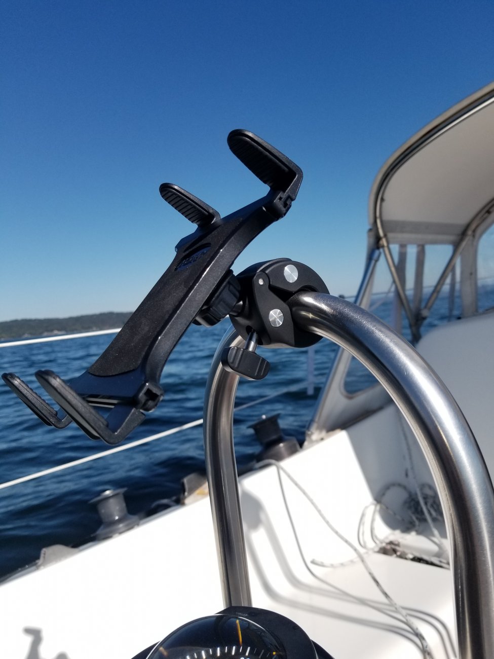

@MikeHoncho that looks like a good find. I would be concerned about the holding power in a rough sea state. Perhaps when the water gets rough the tablet and holder gets stowed below.

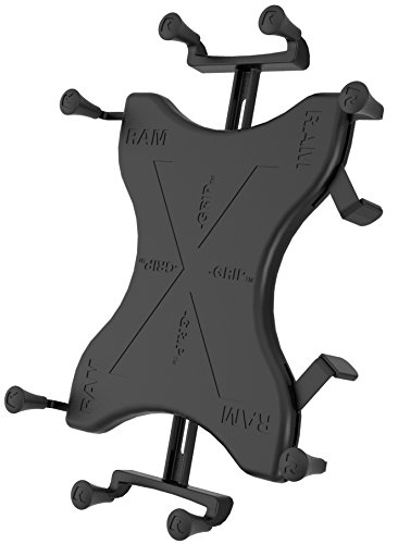

While still not practical in a real blow, the Ram holder has more contact points with the tablet. What feels like strong springs. It looks to me a bit more secure. I have acquired one and will be installing it next week. I'll let you know how it goes after I have sailed with it for a couple of times.
Ram Mount X-Grip III Universal Clamping Cradle for 10-Inch Large Tablets (RAMHOLUN9U

I have that same mount for the HD movie tablet we have, it's VERY secure, excellent product.

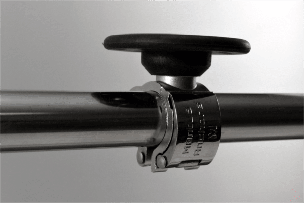

@Jack Barnes I purchased a couple of Mantus clamps.
It’s prepared to receive the Ram ball and a ram clamp. You can mount them every which way. I liked the metal clamp and design. They come in size to fit the SS tube you have.

That’s a good point- I use mine for casual coastal sails in good weather- so I have no experience with the ram hardware in in rough water.
The ram base does seem to grip the tablet quite well, but you should take a look at it and see if it feels sturdy enough for you.

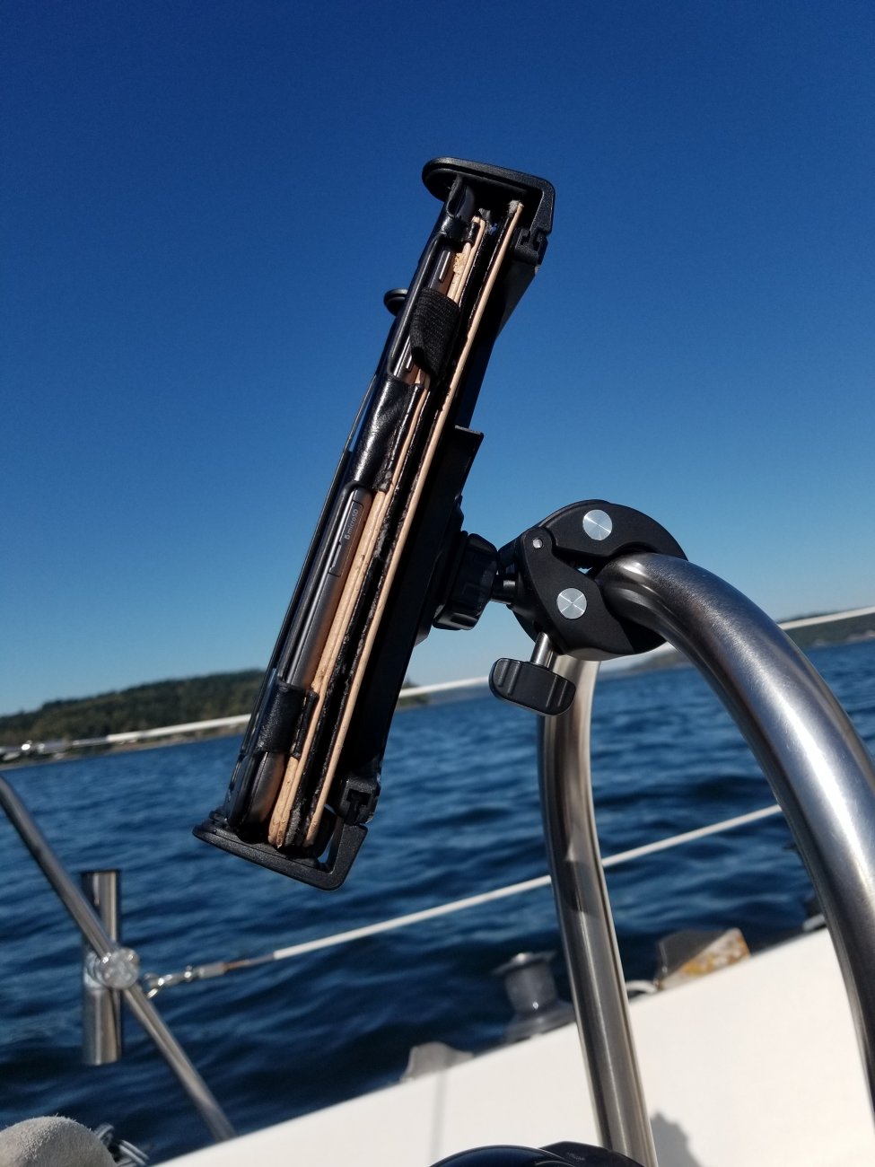

Im going to print out a plate to insert magnets in and glue it onto the base for a secondary means to keep it in place. I've been sailing in 15+ knots all day and it isn't moving but if its hit it will come off as it is.

Does anyone know the size of the rails on the right and left of the chart plotter? Looks like the Mantus rail clamp will work for mounting the Ipad. Thanks.
23,839
Jack..they look bigger than 1 inch tubing.
