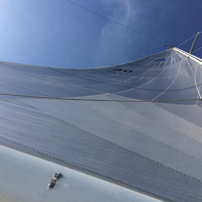

I recently cut down an old but still in very good condition mainsail to fit my boat. Orienting the clew so that the boom would be above head height was factored in.
